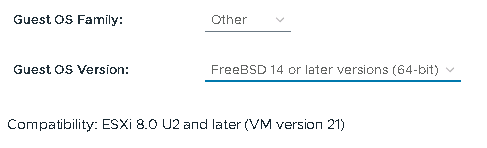

        Hi, we are running a couple of devices with pfSense+ (24.11). So long no major problems in our setup.
        Like you I had to choose FreeBSD 14 in the VM-configuration, but our vCenter recognize the Guest OS after the Setup correctly as FreeBSD15.
        alt text
        • P Online
          Popolou
          Virtualising it this way is common and other than ensuring you've taken into account the known tunables for a VM using ESXi, you should be ok.
