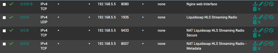

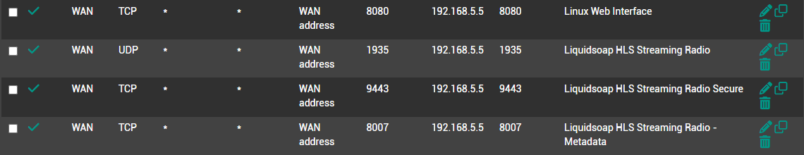

      Here are screenshots of both NAT and Rules settings.
      NAT
      Rules

        johnpoz LAYER 8 Global Moderator @carrzkiss
        @carrzkiss well your other rules are not triggering. Only that rule to 8080 is being triggered is how the top rule shows 0/520B and the others are all 0/0
        This means the first rule has passed 520B but currently has no states open (that first 0)
        This means nothing has gotten to the firewall on these ports. Do you have rules above that would block? Do you have rules in floating?

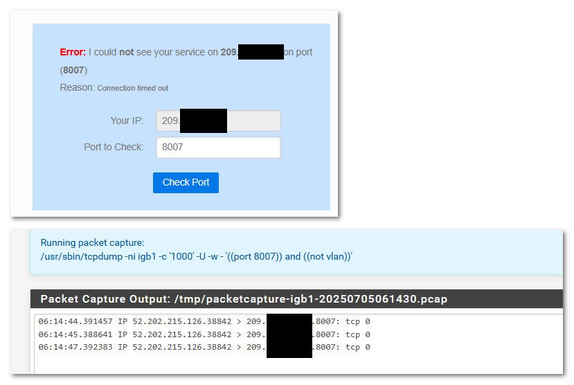

        As a simple test I would validate that pfsense can see traffic on those tcp ports.. Start a packet capture on your wan interface this traffic should hit and then go to say can you see me . org and send some traffic to tcp port.. For example that 8007 port..
        So while I have nothing that would allow that port 8007 to anything - I can see from the packet capture that the traffic does indeed get to pfsense wan interface.
          carrzkiss @johnpoz
          @johnpoz
          The issue was port 9433.
          Once I changed it to 9443, it started working.
          Port 8080 is now showing: 0/3 KiB
          Port 9443 is now showing: 1/1755 KiB
          I don't have any idea when port 9443 was changed to 9433.
          I could have set it to that during internal testing to ensure no one could access it from outside the network.
