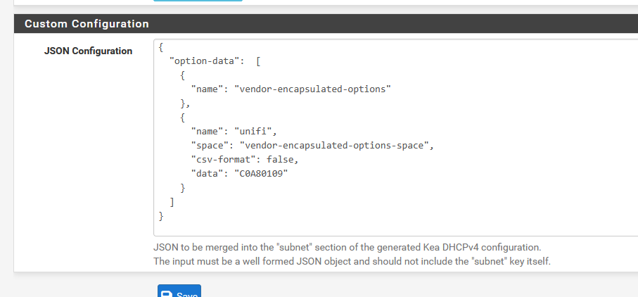

                Gertjan @Ghost 0
                @Ghost-0 said in UniFi access points successfully adopt under ISC DHCP but won't adopt when KEA DHCP is enabled.:
                I have this issue.
                It starts with :
                UniFi access points successfully adopt under ISC DHCP ...
                because you had, and forgot that you did so, created an DHCP Option for ISC.
                This means you have to create one under KEA also.
                Now you know enough to solve the issue ๐Ÿ˜Š
                Let's say you have a cloudkey hardware/software running on a LAN network host, I have one on 192.168.1.9 (a LAN IP).
                You have on or more Unifi AP (or other Unifi stuff) on another network, let name one : 192.168.2.3
                The easy way out : go here : Services > DNS Resolver > General Settings and create a Host override.
                The host name should be 'cloud' (IRC) - the domain name could be your pfSense domain, and the IPv4 should be 192.168.1.9.
                Better :
                Go to your DHCPv4 KEA LAN settings page (the page that handles 192.168.1.0/24 network) and add :
                  "option-data":  [
                      "name": "vendor-encapsulated-options"
                      "name": "unifi",
                      "space": "vendor-encapsulated-options-space",
                      "csv-format": false,
                      "data": "C0A80109"
                Take note : syntax errors are not allowed. Ever ({[; space etc is important here.
                => this is an extra DHCP Custom '43' option, like in the good old ISC days.
                The IP is encoded , and mine is 192.168.1.9.
                Add also this "JSON Configuration" on every LAN interface where you have Unifi equipment.
                Done.
                Test (!) :
                Packet capture on a network where you have UNifi equipment.
                Use "UDP" and ports "67 68".
                Now start/boot/power on a Unifi device.
                You'll see the DHCP lease request.
                You'll see the DHCP lease reply from the pfSense DHCP server, with the option "43", so the Unifi device will now know where to find the controller.
                Check your the interfaces : firewall rules : the Unifi device should be able to communicate with the controller : 192.168.1.9 in my case.

                  Based on what @Gertjan just posted. It seems the json configuration is available in your instance of pfsense. If you need a backup version to implement this outside of possibly not having a resolver and strictly just want dhcp 43 option to work you can try the config below. This is closer to the option 43 version of ISC type implementations just in KEA.
                    "option-def": [
                        "space": "dhcp4",
                        "name": "custom-option-vendor",
                        "code": 43,
                        "type": "binary"
                    "option-data": {
                      "opt7": [
                          "data": "01 04 C0 A8 19 02"
                      "opt25": [
                  Two areas need to change to suit your configuration. What interface your trying to attach the 43 option to. You can find this by navigating Status -> Interfaces choose the (optxx) interface you want to attach it to usually the network the ap's live on. Then configure the data portion below each (opt) of that json configuration. Using the IP address of your controller with decimal to hex equivalent. Like the previous poster mentioned be very careful for syntax errors or spaces.

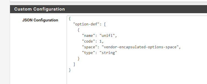

                          Gertjan @Ghost 0
                          I will read and try it
                          I've edited my post above.
                          A second, JSON text structure is also needed. It has to be 'defined' first :
                            "option-def": [
                                "name": "unifi",
                                "code": 1,
                                "type": "string"
                          on the main
                          page.
                          Then, as said earlier, on every interface where you need the DHCP option 43, you have to put :
                            "option-data":  [
                                "name": "unifi",
                                "data": "C0A80109"
                          where "C0A80109" is hex for 192 168 1 9 => 192.168.1.9 if your controller uses 192.168.1.9 (an IP on my LAN network).
                          So you probably have to adapt that hex string.
                          The rest can be copied and places as-is.
                          That's in newbie range ^^
