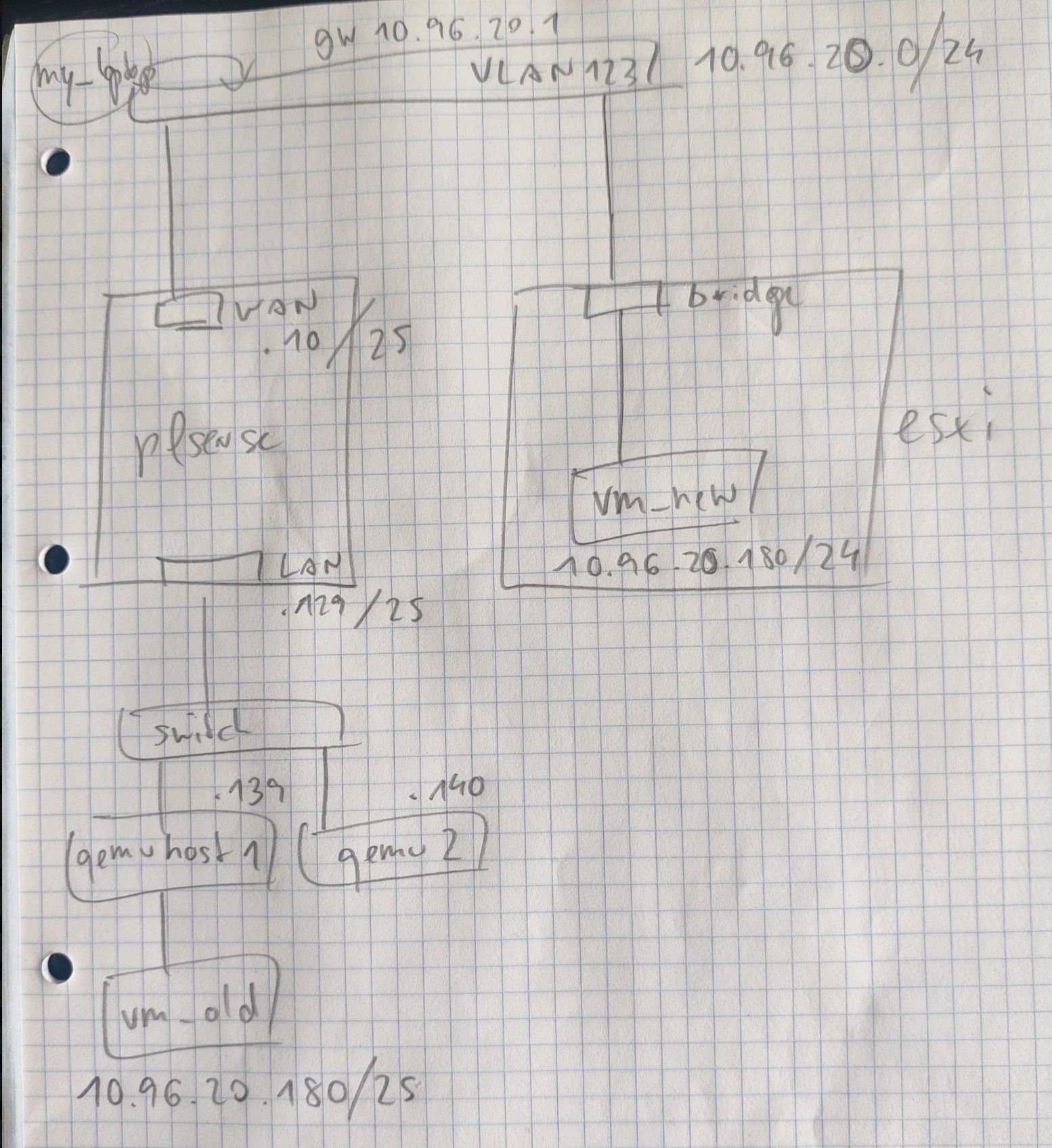

          sgw @viragomann
          @viragomann
          See my wonderful diagram attached ;-)
          As I understand it "vm_new" is placed in 10.96.20.0/24 ... there is no more /25 in the setup with the esxi.
          "outside" is "my_laptop" up in the left: I have a site to site VPN into 10.96.20.0/24.
          thanks for checking my thoughts
          just to add: "vm_old" is turned OFF already

            • V Offline
              viragomann @sgw
              @sgw
              And your laptop is connected to the VLAN123 and has an IP out of 10.96.20.0/24?
                sgw @viragomann
                @viragomann said in splitting a subnet, moving from LAN to WAN:
                @sgw
                No. My laptop is in my LAN behind my pfsense, and that runs a site-to-site-IPSEC-VPN to their main VPN gateway ... from there they route it to that VLAN.
                Works for years.
                What's new is that the VLAN is now bridged to VMs in their VMware cluster.
                So I am not yet sure if they correctly route the whole /24 (this might be an explanation why I don't reach vm_new with .180, right?). I just asked my contact there to check that VLAN.
                Setting 10.96.20.180/24 should be OK, you agree?
                As long as I don't get their feedback I could play with other IPs to see if my theory holds water.
                EDIT: .127 works, .137 not ...
                • V Offline
                  viragomann @sgw
                  @sgw said in splitting a subnet, moving from LAN to WAN:
                  Yes, if they statically route the lower /25 to pfSense, that could be a reason. But why should they do that?
                  pfSense has just an IP in this subnet from their view and it would rather make sense to route the upper /25 to it, because this is behind of pfSense.
                    sgw @viragomann
                    They might have an error in setting up the VLAN in vSphere.
                    It is routed correctly to the network port where the pfSense is attached, otherwise all my stuff wouldn't have worked for years.
                    But it's new and untested in the VMware environment. And it might be wrong. At least I don't have another idea right now.
                    I am looking forward to their reply.
                    As far as I understand things, even when the LAN interface in pfSense is configured in the upper /25, it won't hijack traffic going to an IP in /24. pfSense itself has a route to that upper /25 then, but this should must not affect routing in the larger /24 VLAN "above" ...
                    I even tried that yesterday: triggered a reboot of pfsense and pinged vm_new .180 all the time ... just to see if somehow things change while the pfsense is offline. It would have surprised me, but anyway ... I can only search in my range for now.
                    Maybe I overlook something, but so far @viragomann hasn't spotted a real misunderstanding, right? thx ...
