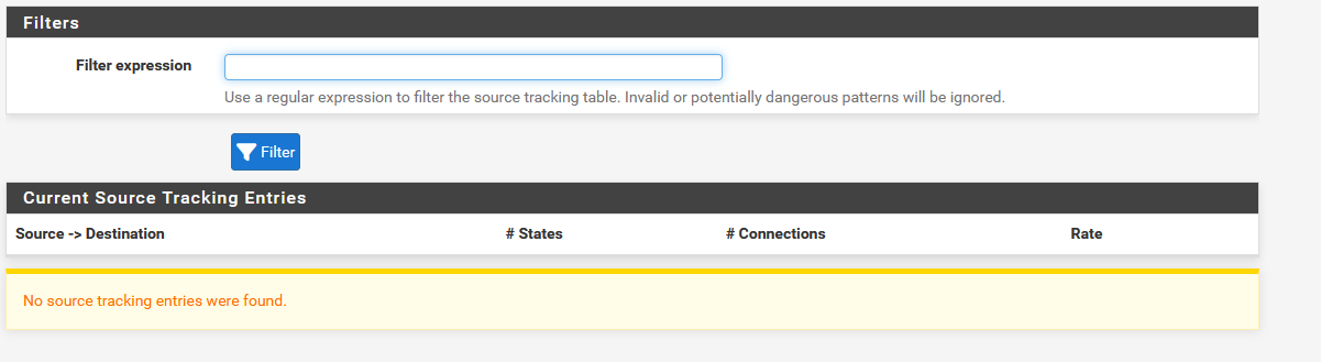

      I have revisited this scenario and it seems that stickiness is completely ignored.
      Load balancing works as expected, getting the full aggregate speed in multi connection speedtests.
      However one would expect that speedtests should use only 1 line with stickiness enabled, which doesn't seem to be the case
      This is also verified by having connections change source ip's which typically in e.g. web banking logs you out immediately when load balancing.

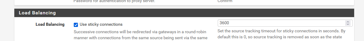

      I have
      But I get nothing at
      which is rather strange.
      This has worked in the past.
      This is on pfplus beta 25.07. Am I missing something or is it a bug?

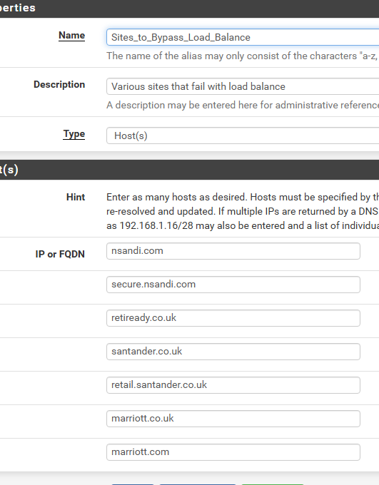

        I also had the banking issue, so created an alias containing those sites, and added a rule using that alias to use a specifis gateway rather than the group.

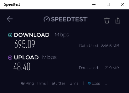

            @netblues If that were true, how would the Ookla App report the combined speed of multi-Wan configs ?
            I used to have both Virgin Cable (300Mb) & BT VDSL (400Mbps) at home. This test would be impossible if the Ookla app used a single connection !!
