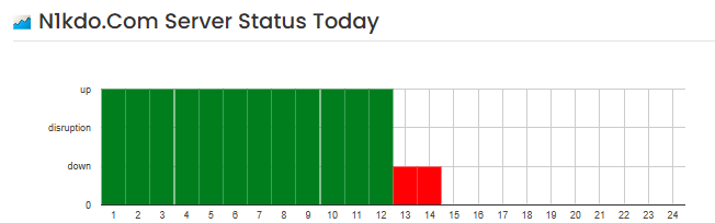

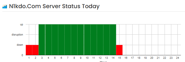

      Interestingly,
      The graph showed down last night
      Today this:
      Then after a refresh:
      Suggestions, ideas? I will reach out to the owner to see what is happening. I'm at a loss as to the changing access and ability to get there.

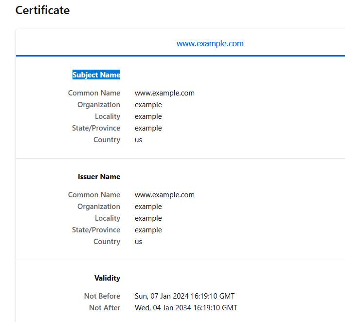

        johnpoz LAYER 8 Global Moderator @wc2l
        @wc2l said in Specific website access.:
        n1kdo.com
        from a quick look - they are presenting wrong cert that is for sure.
        But https://www.n1kdo.com/
        Seems to be working fine.

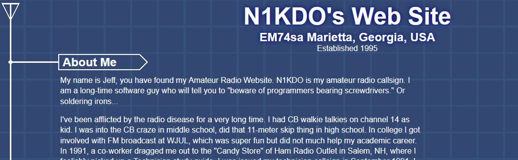

        • W Offline
          wc2l @johnpoz
          @johnpoz
          THANK YOU. I guess he is doing a lot of blocking. I will see what his fix is. If it does not work, I will send him more information.

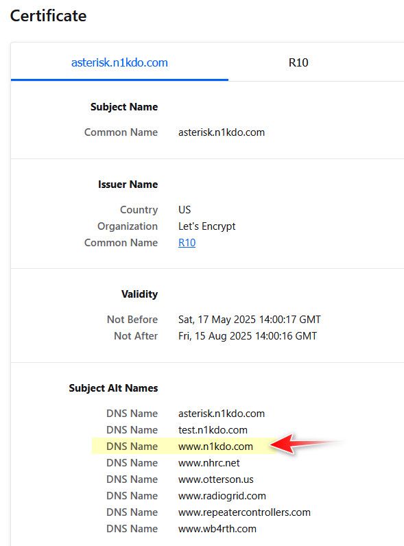

          Is there a way for me to see the cert since I can't get there?
          Have to see how to do more trouble shooting.
          • SteveITSS Offline
            SteveITS Rebel Alliance @wc2l
            https://www.ssllabs.com/ssltest/ specifically https://www.ssllabs.com/ssltest/analyze.html?d=www.n1kdo.com&hideResults=on&latest is a good external/third party test.
            Upvote 👍 helpful posts!
              johnpoz LAYER 8 Global Moderator @SteveITS
              The cert for www. is correct its when you leave off the www. is when wrong cert is presented.
