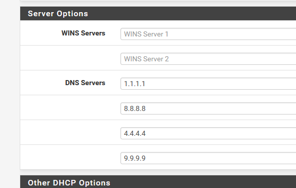

            If you want your LAN(s) client to use the "servers listed in gen settings dns" then ... well ... why not give them to your LAN clients ?
            As they are using DHCP, go here : Services > DHCP Server > LAN and enter all your DNS servers :
            Save, Apply - now go to one of your LAN devices, if it's a Windows device, type
            ipconfig /renew
            and then
            ipconfig /all
            and you'll see that your LAN device uses now the 8.8.8.8 4.4.4.4 9.9.9.9 as its DNS.
            ( something you actually don't want as you'll find out later ... but that's another story ^^ )
            edit : An OpenVPN client : same thing : see the OpenVPN server page : you can give a list of DNS servers for your OpenVPN clients.

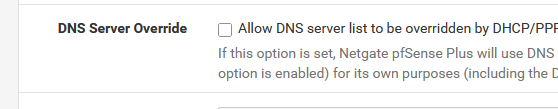

                If you have checked ( System > General Setup) :
                then the DNS server(s) obtained from the ISP are assigned to the pfSense DHCP server(s), thus the LAN clinst will get the ISP DN servers.
                That's something that was normal or even mandatory, in the past.

                  But dont quite understand the wording in general settings
                  If checked is the servers listed in gen settings overruled and ones put in DCHP used? A the moment it’s unchecked.
