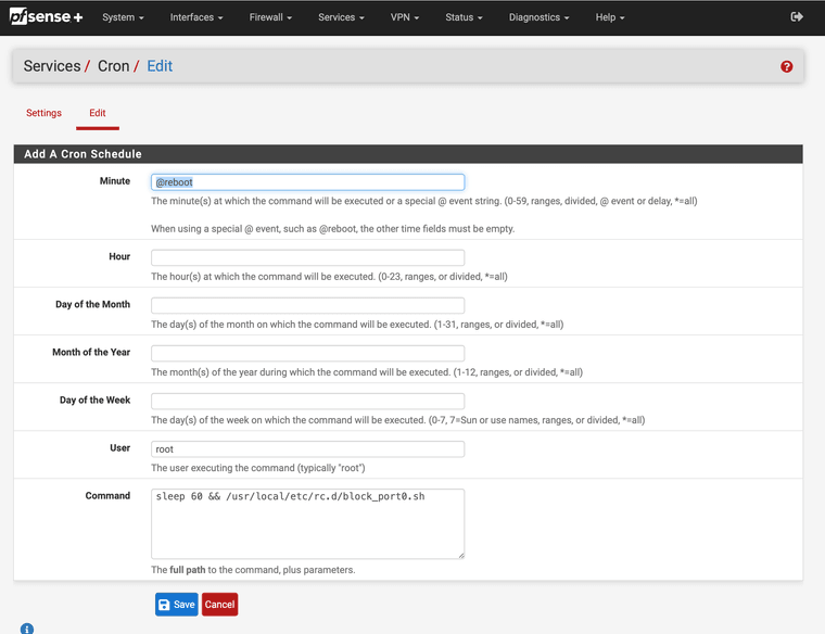

      Add a cron job
      Bingo run
      pfctl -sr
      and now you have that block rule for ipv6 also it should show inet6.

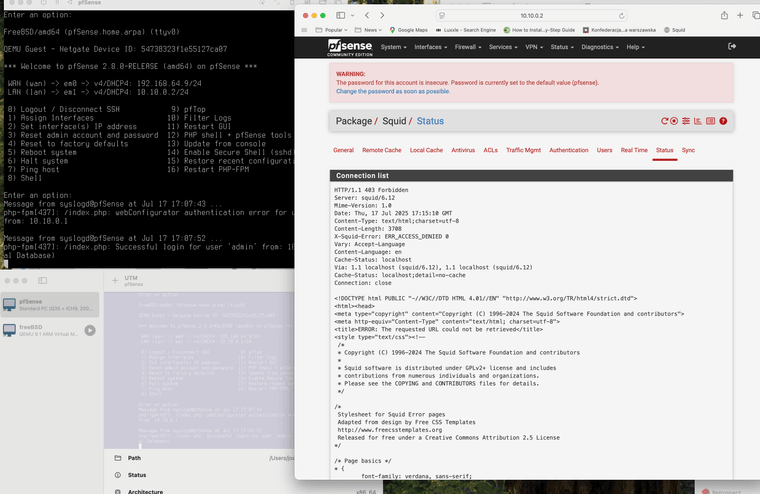

                                • JonathanLeeJ Offline
                                  JonathanLee @johnpoz
                                  @johnpoz This even does this with the newest CE edition inside of UTM virtualized environment outside of the 2100s
                                  It is not just the 2100s this is set up for standard stuff everything else works with it just the status page
                                  Make sure to upvote
