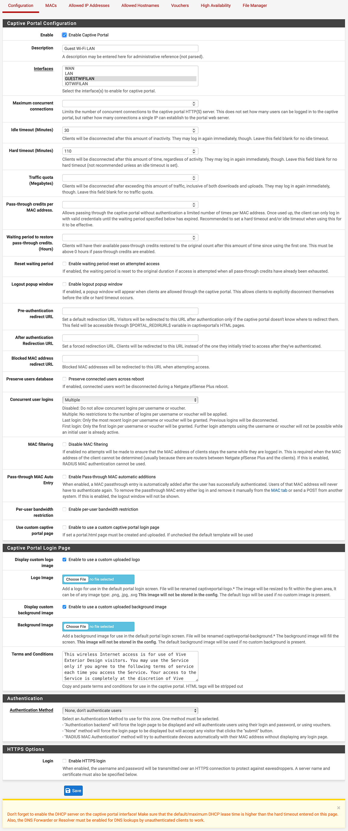

      After many months of chewing on this problem, the culprit turned out to be the guest network’s captive portal. This is the configuration:
      For any other information regarding the setup of the guest interface, DHCP, etc., see my thread “Two VLANs set up alike, one does not get Internet.”
      What is wrong with this configuration?

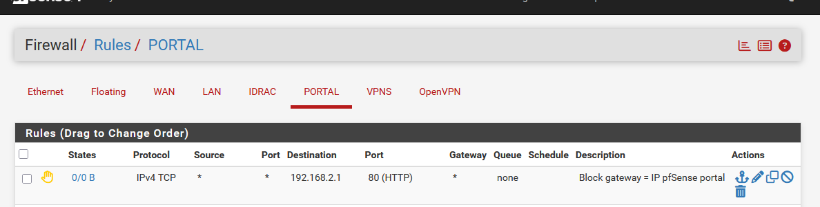

                Just for the fun, I've added this first reject rule on my captive portal :
                The rule rejects traffic going to = destination = "192.168.2.1" is the portal (pfSEnse) interface using destination port 80 = a web server port.
                and then I took my phone (iphone) and connected to the Wifi Portal SSID.
                Immediately I saw the portal's login page, I could login, and live was good.
                I looked again at my portal firewall rule (actually : 20 minutes later) and I saw this :
                This means what you think it means : the 'port 80' as a destination or http web server port on the pfSense portals interface (for me : 192.168.2.1) is never accessed.
                This is because the web server that offers the login page isn't using = listening, on port 80 .... (neither port 443 = TLS/SSL or https).

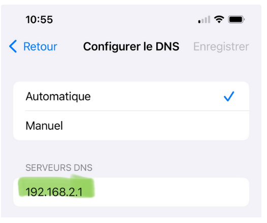

                On your iphone (pad, mac), you should see this :
                Remember : 192.168.2.1 is my portal's interface - and the portal's gateway.
                If your DNS is pointed to somewhere else, consider your portal as 'broken'.

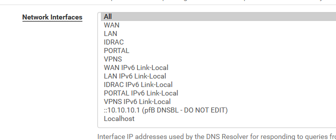

                Btw : make sure unbound - the resolver - actually listens on the portal's interface (UDP/TCP port 53) :
                Just use the default Resolver's "Network Interface" settings :
                and you'll be good.
