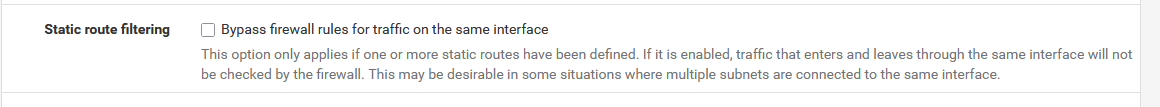

        AWeidner
        I probably found the culprit:
        System -> Advanced -> Firewall & NAT ->  Static route filtering:
        Bypass firewall rules for traffic on the same interface
        This is enabled on all pfSense 2.7.2 devices and it looks like it gets disabled during the update to 2.8.0.
        After reenabling this option, traffic flows in both directions as before.
          Gertjan @AWeidner
          @AWeidner
          I've found :
          Ok with the "Please: Don't turn this", so just a question.
          This :
          This option only applies if one or more static routes have been defined. If it is enabled, traffic that enters and leaves through the same interface will not be checked by the firewall. This may be desirable in some situations where multiple subnets are connected to the same interface.
          matches your usage case ?
          You have Static routes, multiple sub nets ?
            AWeidner @Gertjan
            @Gertjan said in pfSense 2.8.0 - Routing stops intermittently after update from 2.7.2:
            [...]matches your usage case ?
            Yes, the remote location has its own subnet and connects via a static route to the network in the main office. The default route of the remote location is set to the router that provides internet access in the remote location.
