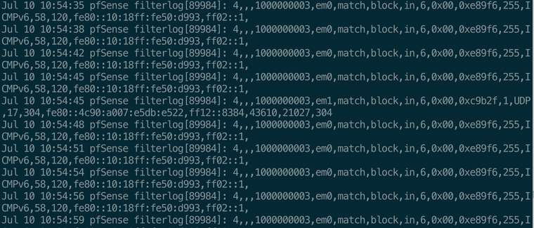

      Description:
      I'm running pfSense 2.8.0-RELEASE and experiencing an issue where IPv6 traffic continues to be logged despite having explicit Block rules with logging disabled.
      Here is my config:
      • Both LAN and WAN interfaces have IPv6 Block rules configured
      • Action: Block
      • Address Family: IPv6
      • Protocol: Any
      • Source: Any (LAN subnets for LAN rule)
      • Destination: Any
      • Log: UNCHECKED (logging explicitly disabled)

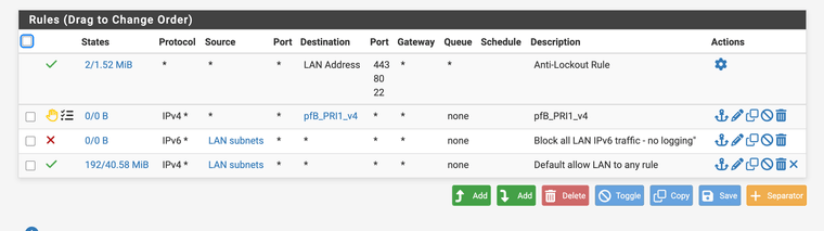

      • Rules are positioned at the top of their respective interface rule lists (but for LAN, there is an ipv4 rule which always put this on position 2, not counting the anti-lockout rule, see picture below and for WAN, there is at the top the rules for private network and bogon networks which are not "surpassable")

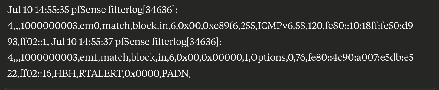

      Issue:
      Despite these rules, IPv6 traffic continues to appear in /var/log/filter.log (picture below)
      What I've tried:
      • Verified rules are properly configured (Block + Log unchecked)
      • Placed IPv6 block rules at top of interface rule lists (with exceptions mentionned supra)
      • Applied changes and restarted pfSense
      • Removed IPv6 gateways
      • No floating rules interfering
      • Rules show as active and correctly configured in WebGUI
      Question:
      Are there system-level IPv6 logging rules that override custom interface rules? How can I completely disable IPv6 logging when I have explicit Block rules with logging disabled? For the time being, I don't use IPv6 at all
      Any insight would be appreciated.
      Plicplic
        The traffic you see logged is sourced from some clients link-local address which is not in the LAN subnet. So your rule doesn't match it.
        Try changing the rule to any source.

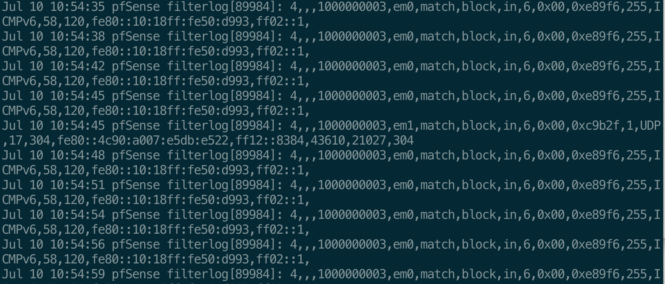

            plicplic
            Follow-up: Even after changing Source to "Any" and disabling all IPv6 services, the issue persists.
            Additional steps taken:
            • Changed LAN rule Source from "LAN subnets" to "Any"
            • Disabled DHCP6 on WAN interface (set to None)
            • Disabled IPv6 Track Interface on LAN (set to None)
            • Rebooted pfSense completely
            Current status:
            IPv6 traffic continues to be logged on both interfaces despite Block rules with logging explicitly disabled:

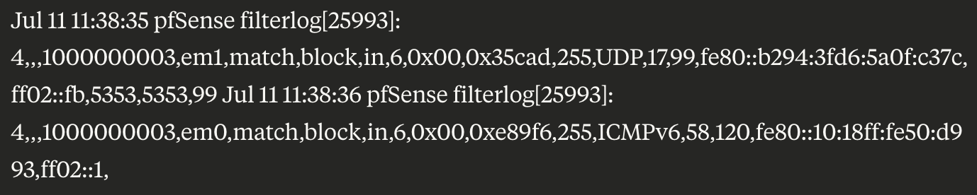

            Here, some examples:
            Both WAN and LAN rules are configured as:
            • Action: Block
            • Protocol: Any
            • Source: Any
            • Destination: Any
            • Log: UNCHECKED
            Question: Is there a system-level IPv6 logging mechanism in pfSense that overrides custom firewall rules? The traffic is being blocked correctly but continues to generate logs despite logging being disabled in the rules.
            Additional guidance would be appreciated!
              You can see that it's matching the default IPv6 block rule there. Which implies it's not matching your custom rule. It's much easier to see that in the gui log.
              Which interface is WAN there?
              The second log looks like it has IP Options so you would need a rule with that set to match it.

                You're right - here's the GUI log analysis:
                All entries show my custom rules "Block all IPv6 (1000000003/4)" - NOT default rules.
                And em0 is the Wan interface.
                Main issue: My IPv6 Block rules have "Log: UNCHECKED" but continue logging anyway.

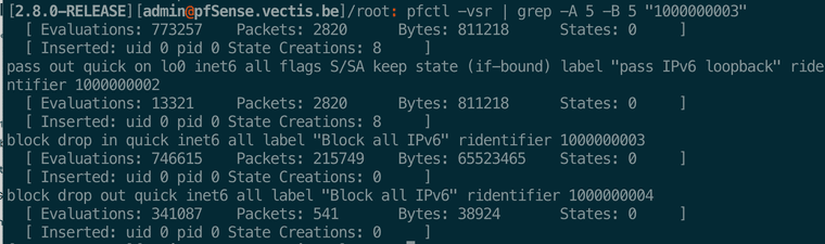

                      Try this. Go to Status > Filter Reload and reload the ruleset. Make sure it's actually loading without errors.
                      Then at the CLI run: pfctl -vsr
                      Check the actual running rules for 1000000003/4.
                      • P Offline
                        plicplic @stephenw10
                        1. Filter reload shows no error while reloading.
                        2. pfctl -vsr | grep -A 5 -B 5 "1000000003"
                        Log is unchecked in every rule for Wan and LAN in the firewall rules

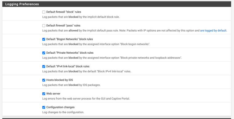

                        1. I found this in Status --> System.logs --> Settings (and changed some checks)
                        And now filter.log is only populated with ipv4

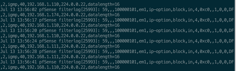

                          johnpoz LAYER 8 Global Moderator @plicplic
                          @plicplic yeah when you block all IPv6 it creates those hidden block all IPv6 rules. And yeah most likely going to create a lot of noise in the logs.
                          Those blocks your still seeing to to 224.0.0.22 are multicast with ip-option set but not allowed - you could change your rules to either create one that blocks but doesn't log, or your allow rule to allow ip-option being set
                          SG-4860 26.03.1 | Lab VMs 2.8.1, 26.07
                            Yup, what I missed here is that whilst it's not hitting the default block rule it's in fact also not hitting your custom rules. It's actually the hidden block all v6 rules that are added when you unset 'allow IPv6'.
