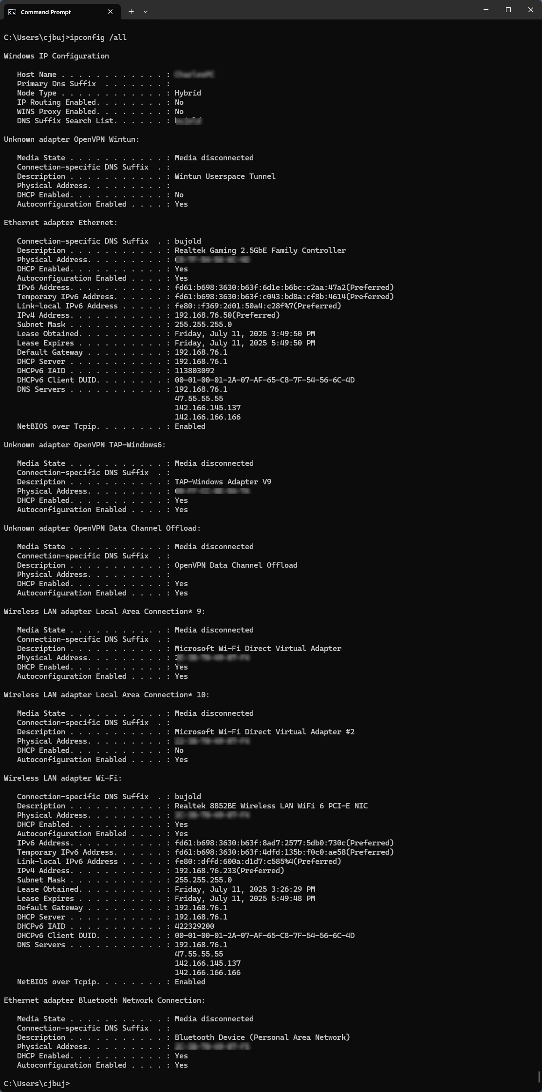

          3. IPconfig /all using my PC running Windows 11 with July updates: 27cae5c3-8ae3-460e-9a3f-5da7143be532-image.png

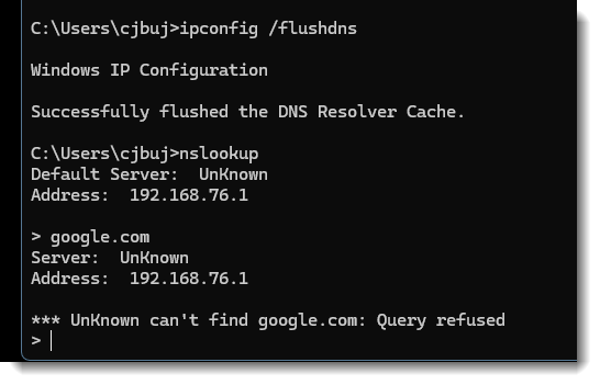

          4. Using Windows NSLookup after clearing DNS cache and doing lookup on Google.com 230742ea-da1c-48aa-aa25-f6c4e523b409-image.png

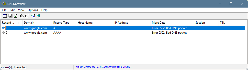

          5. using DNSDataview with primary DNS server set to 192.168.76.1(Pfsense)

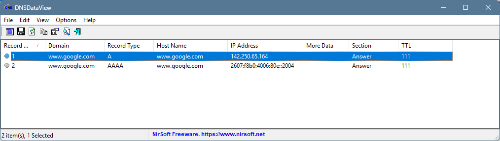

          6 Using DNSdata with primary DNS server set to ISP DNS server 2f49320f-f48f-4855-9f6d-e3fefc8d1c04-image.png

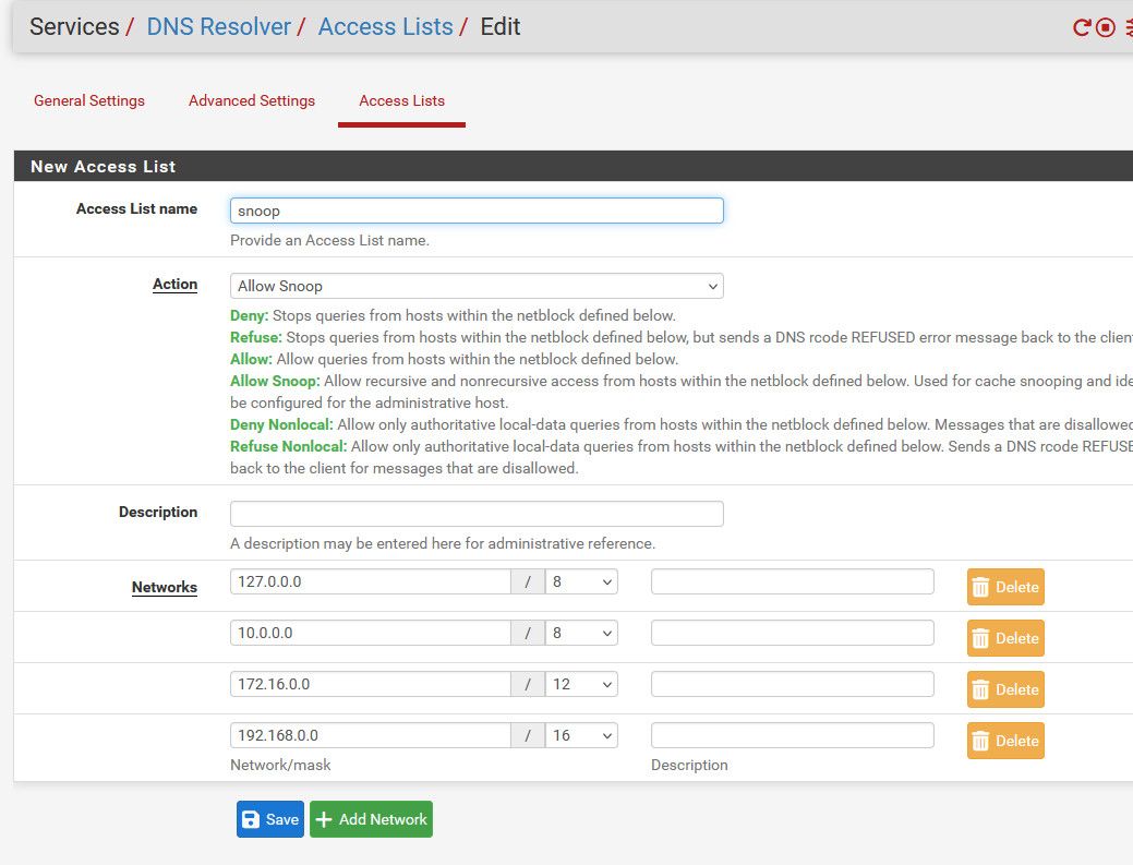

            @cjbujold query refused points to the ACLs not being correct to allow queries.
            Did you turn off automatic ACLs?
            This would be under the unbound gui, advanced
            If you turn that off - then you have to create your own ACLs
            Other things I see wrong is all those other dns setup on your ethernet adapter.. Those outside NSers sure are not going to be able to resolve your local resources. If your going to point to more than 1 NS - the name servers you point to should resolve the same stuff. If they are filtering NSers then they should filter the same way. If NS A filtering is different than NS B - your going to run into issues because you never know which NS you might talk to.. So maybe something you want filtered is not, maybe something you want to resolve is filtered.. And none of those public are going to be able to resolve any local resources you want to resolve, etc.
            You see when you do that lookup and it says unknown for server - that tells me your NS is borked - when nslookup tries to talk to a NS it would always do a PTR for the IP.. If the NS your talking to can not even resolve the PTR of its own IP address - there is something wrong with it..

              cjbujold
              Thank you that fixed my issue, much appreciated.

                Not related, but you have wired NIC and a wifi NIC, both using the same 192.168.76.0/24 network.
                Wired 168.168.76.223 - gateway 192.168.76.1 (probably pfSense LAN)
                Wireless : 192.168.76.50 - gateway 192.168.76.1 (probably pfSense LAN)
                and both have a bunch of 'strange', non local DNSes.
                Be ware that things can become confusing as a same device has more then one IP in the same network. I mean, its good for redundancy, true, but still ...
                Normally the DNS server for that PC would / should be 192.168.76.1 also.
                The ieda is that all your devices uses the same local 'pfSEnse' resolver - and if you have to use 47.55.55.55 etc as a DNS source, you could set the resolver to forward to that DNS (and the others).
                Now, you local network DNS requests are getting cached locally so your entire network can benefit from this.
