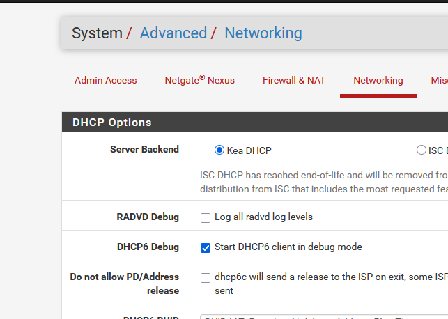

        You've tested with this option set :
        You'll see the dhcpv6 client logging under Status > System Logs > DHCP

          @Gertjan Yes I'm running in debug mode
