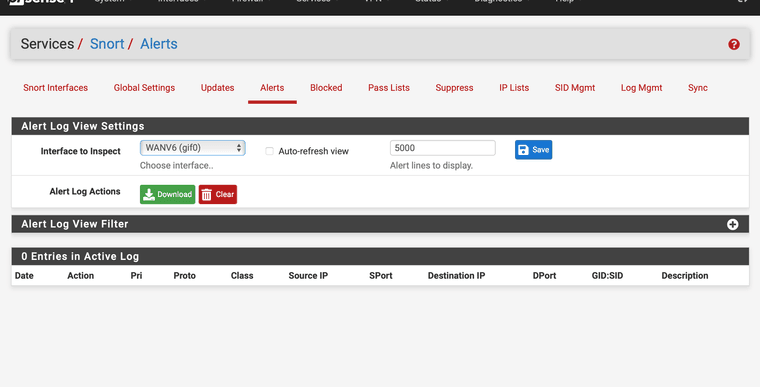

      Hello Fellow Netgate community members.
      I am trying to get snort to also monitor my ipv6 traffic on hurricane electric tunnel for ipv6 traffic. My isp is ipv4. I asked this before and I have seen ipv6 traffic very seldomly on WAN that is ipv4 only. Do I need to adjust the snap length on WAN do I enable it on the GIF0 interface that handles IPV6 traffic.
      What is the correct configuration for use with ipv6 over a tunnel broker with snort? Keep in mind I am aware that it should be on LAN I know that I am doing this with WAN as it took to long to fine tune and set this up.
      I have set Snort up on WAN and GIF0 interfaces. Only on GIF0 I changed the snap length it is 65535 in order to see the whole packet because of the encapsulated traffic. Should I have it only configured on WAN with a larger snap length?
      I have also added a custom rule to GIF0
      alert ip any any -> any any (msg:"Test IPv6 alert"; sid:1003372; rev:1;)
      My alerts are just blank on GIF0
      This is on a 2100-MAX with ARM processor.
      I have seen it detect IPV6 items every once in a while but on WAN only. Should I just increase the snap on WAN side and remove GIF0?

        @JonathanLee I do see traffic when I do packet capture in GUI on gif0 it is all IPV6

          I also enabled promiscuous mode in gui for WAN and GIF0

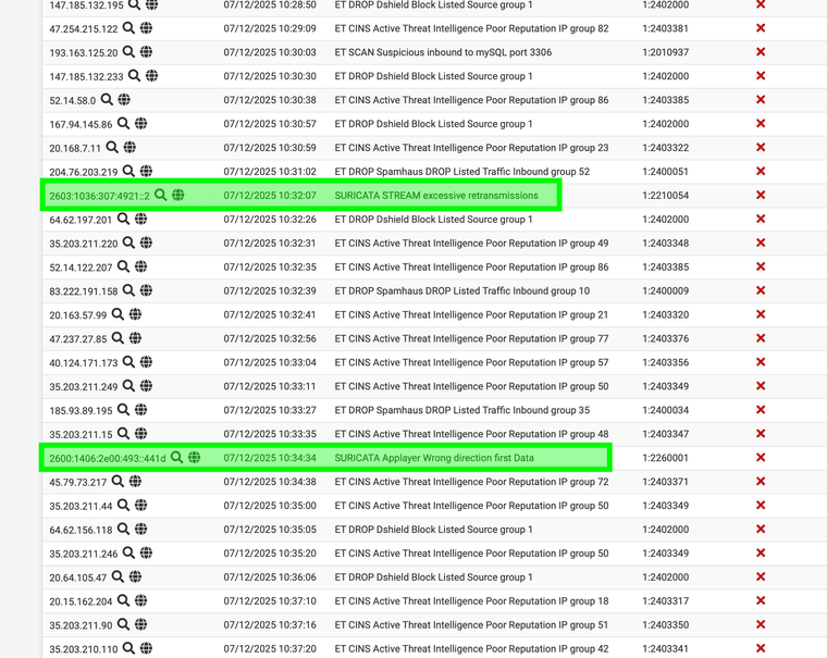

                    @SteveITS I am gonna try it, it says it has better threading support and is faster plus it can run my oink code. I will let you know

                      @SteveITS It looks like it is detecting ipv6 better
                      already is showing alerts
                      It sees some ipv6 going to my interface. Again snort also would spot stuff every once a a while. My son got a bad bug on his tablet and it had a Russian email server running I checked it on virus total and it was spot on as malware known abuses so I reported it
