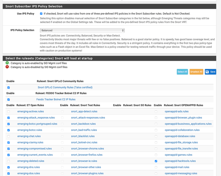

          @raspier you have SO rules can you please share a screen shot of that the arm processor does not do so rules they should not even be there.

                  @raspier The 2100-MAX runs Snort really well but it wont do SO objects. It does everything else. See Snort SO rules I have a paid subscription with a code and everything but the SO rules never populate do they show up on your 1100?
                  "Your Netgate 2100-MAX uses an ARM64 CPU (Marvell ARMADA).
                  ❗ Important Limitation:
                  Snort SO rules are precompiled binary modules. Cisco/Sourcefire only provides precompiled SO rules for x86_64, not ARM.
                  That means SO rules are not available on the Netgate 2100, 3100, 1100, or any ARM-based device." So how does your show up???
