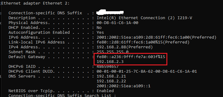

      @Euroguy Oh, this is how a typical client looks like:

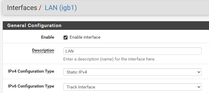

        @Euroguy said in Router advertisement not sending default gateway:
        Likely due to me not using Track Interface
        You need to do that though, if you are on Telia residential services as that is the only way to get a routable prefix for your LAN(s). Your current static address configuration can't be routed onto the internet.
        For now, I will disregard the (likely) complication of you having Windows AD services running on your LAN.

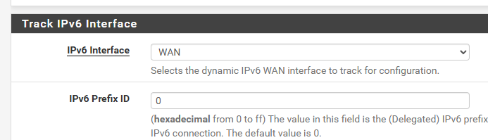

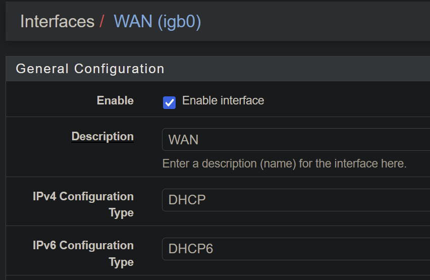

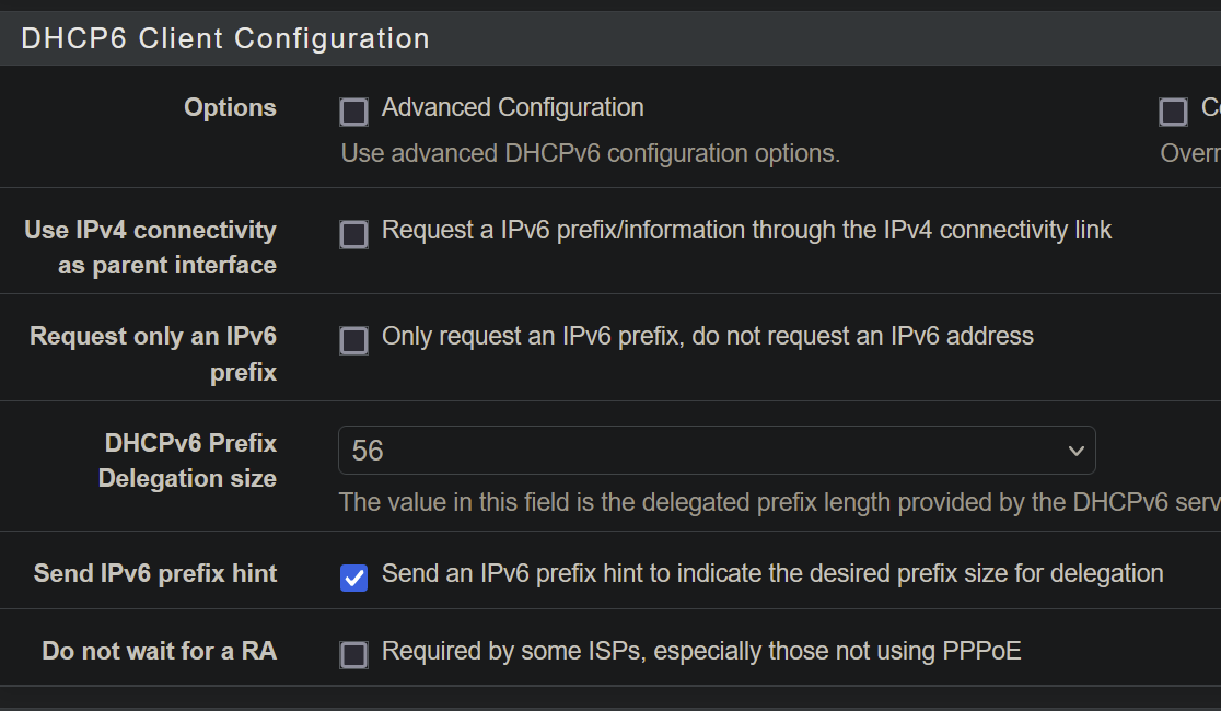

        But for Telia you need to configure WAN:
        LAN: IPv4 address / prefix ID whatever you want...

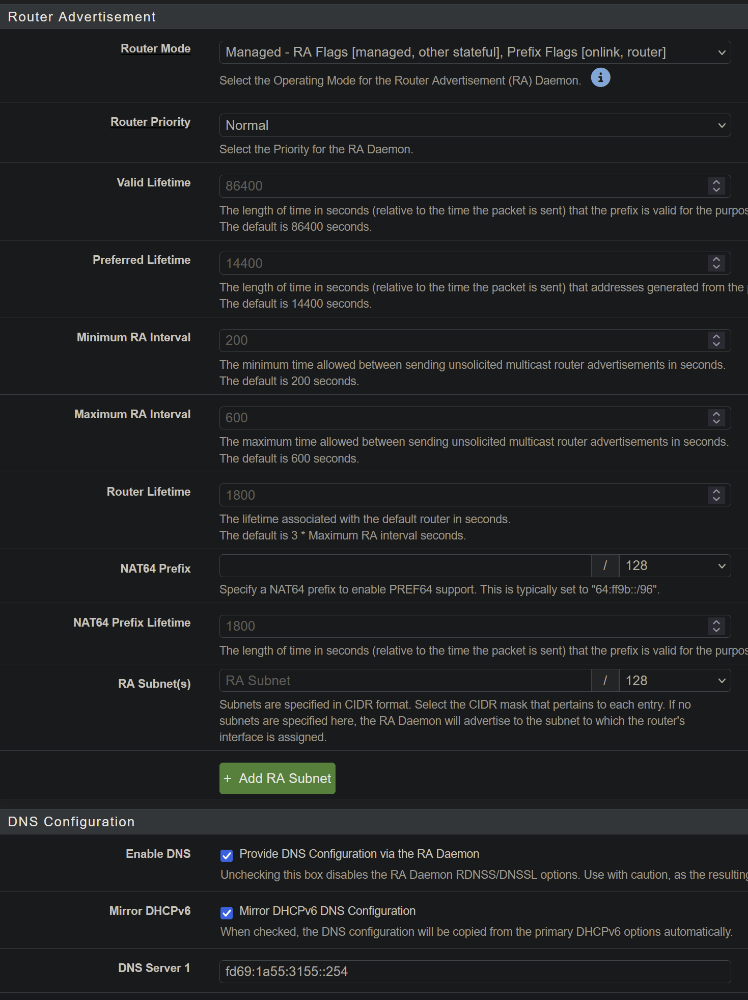

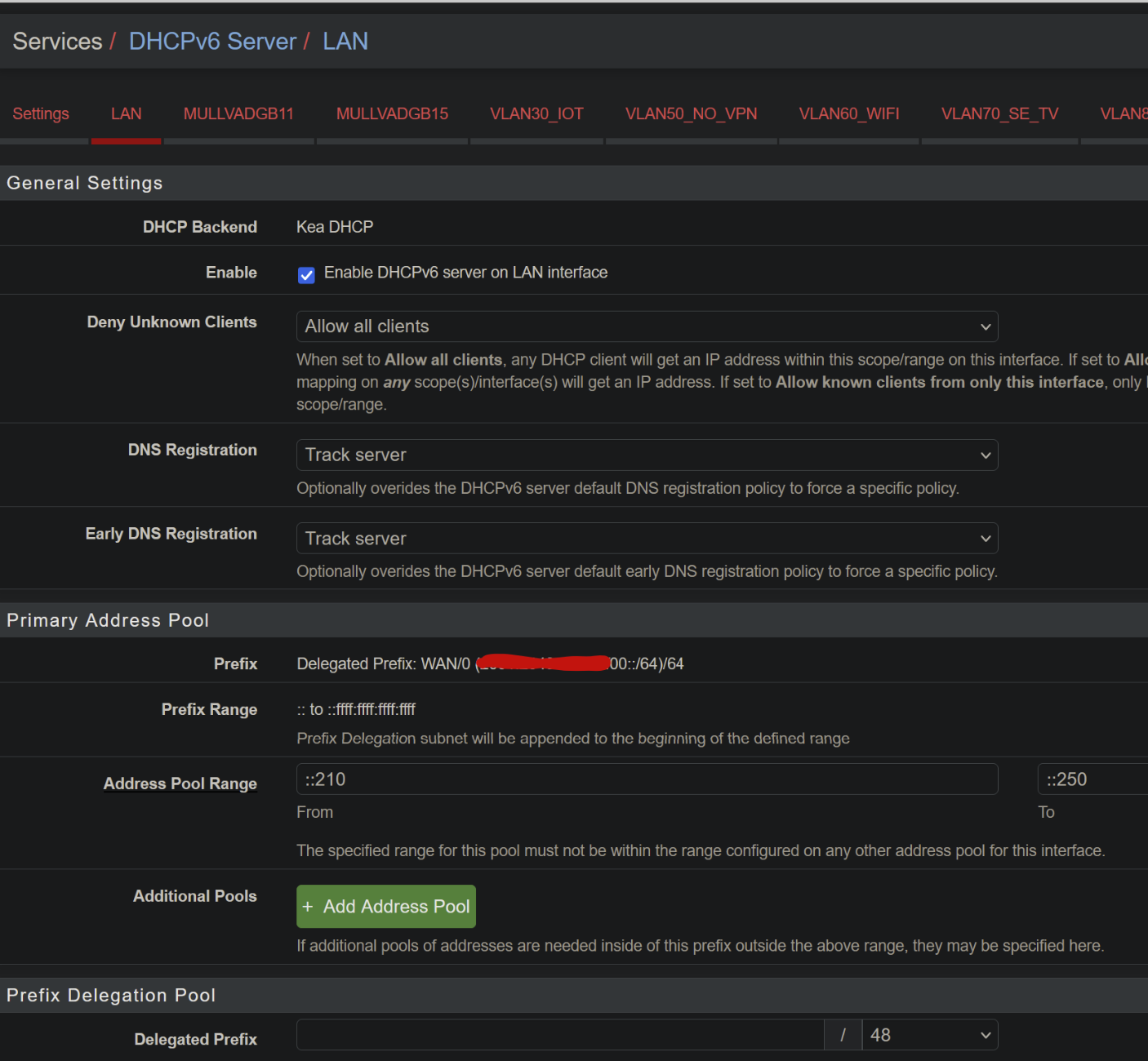

        Then configure Services / Router Advertisment / LAN either as Assisted (DHCP+SLAAC) or Managed (DHCP), no need to specify any parameters as default should suffice (you'll see a default DNS server (grayed out) once the prefix is received (looks like <prefix><your prefix ID in LAN config>:<MAC address of LAN interface>)
        Then you probably need the DHCPv6 on LAN, the RED part below is the assigned prefix from Tracking (note: this is very likely to be a different subnet than the WAN IPv6 address). If you don't see it after configuring the WAN/LAN as above, you need to release and renew the WAN interface lease (there's a button on Status / Interfaces)
        You could also use SLAAC only by setting RA to unmanaged,
        Later, you might need to consider the Prefix Delegation Pool as something to use to delegate a subnet to Windows AD part of the net. That's just a guess as I have no clue how that works 😄
        After that, you can try a ipconfig / renew / renew6 and that should have given the windows machine an IPv6 adress from the /64 segment for the LAN (<prefix><your prefix ID>::210 most likely)
        I started off by ignoring the Windows AD implication, and I am going to end on the same note. The above will give IPv6 connectivity to the LAN. You might need to tweak the firwall rules on the LAN to get out, but as a basic setup the above should work.

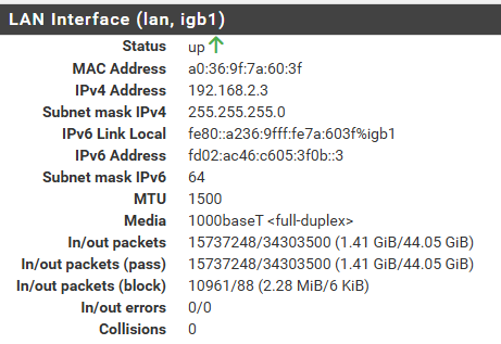

          Given I have link local address on the LAN interface and pfsense knows I do static IPv6 address, wouldn't it be super simple to just add a checkbox on the LAN page stating something along the lines of "Announce this static IPv6 address as default gw in RA?".
          It would allow pfsense to be able to function like IPv4 in regards to enabling private IPv6 addresses if one like to have them and not mandate use of Track interface just to get SLAAC to function.

              @pst said in Router advertisement not sending default gateway:
              Gateway to where? The internet? You need a GUA to go out there, and without a prefix from Tracking (or a Business leased line static IP) that wouldn't be possible .

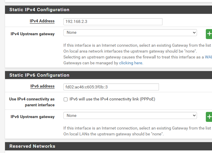

              Well, static ipv6 with
              1. Address + mask and
              2. Gateway set on the static definition
              works as it has the gateway set to "internal address" of the LAN interface.
              It's just the DHCP clients lacking that.
              Just need to get the route sent somehow for them to reach the router and the router does the rest.

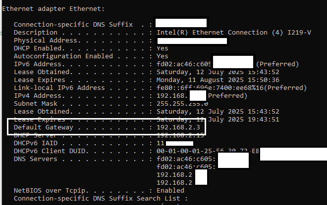

              It seems to me only thing I am missing on DHCP clients is the default gateway. If the router would just send out it's internal LAN address, that would accomplish that.
              I am probably oversimplifying things but just saying.
              by the way, tracking interface now and still not getting routes sent out on RA for some reason.

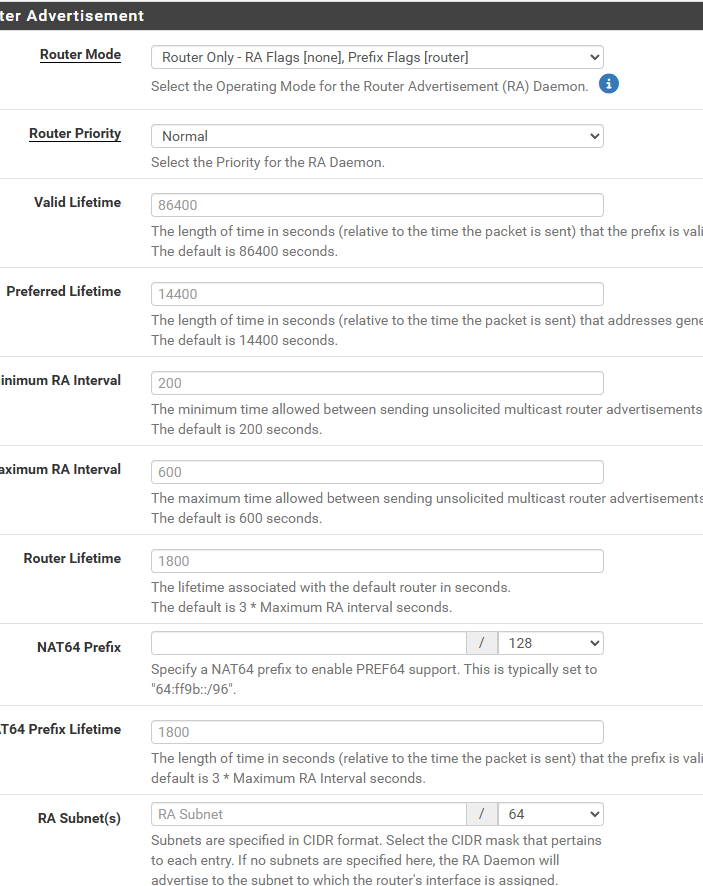

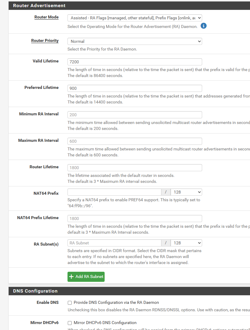

                Services / Router Advertisment / LAN needs to be configured, something like this?
                If you came from pfSense 2.5, the RA was part of DHCPv6 in 2.5 IIRC, but it was made a separate service in preparation for KEA replacing ICS (in 2.7.x/23.x (?)) . So the RA needs to configured, default is Disabled (I think... as I haven't looked at the default config for a while)

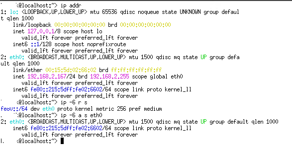

                  @pst what is the client OS you are testing with? Unfortunately I don't know Windows well, can't help there. Did it work before with pfSense 2.5?
                  For me it works on a Debian Linux with pfSense CE 2.8.0 and 'Router Mode' set to 'Router Only'.
                  ## client got a route
                  $ ip -6 r s
                  fe80::/64 dev enp6s18 proto kernel metric 256 pref medium
                  default via fe80::be24:11ff:fef5:cf5f dev enp6s18 proto ra metric 1024 expires 1575sec hoplimit 64 pref medium
                  ## but no IPv6 since there is no other RA or DHCP server available
                  $ ip -6 a s enp6s18
                  2: enp6s18: <BROADCAST,MULTICAST,UP,LOWER_UP> mtu 1500 qdisc fq_codel state UP group default qlen 1000
                      inet6 fe80::be24:11ff:fee4:634b/64 scope link
                         valid_lft forever preferred_lft forever

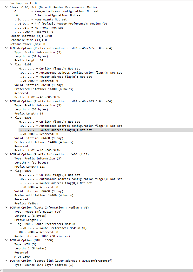

                  Regarding the 'Router address flag (R)', it is not set either but it may not have to be set. According to IPv6 NDP Explained: Router Solicitation and Router Advertisement:
                  "Router Address Flag (R): This flag indicates whether the prefix can be used for assigning addresses to routers. If the R flag is set, hosts can assign the prefix to an interface on the device acting as a router. This flag is typically used by routers to advertise the prefixes they can serve as a default gateway for."
                  Text comprehension is not my strongest point, so I may have missed the point here.

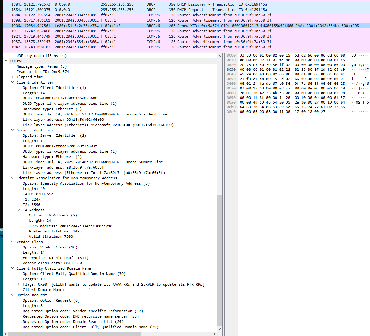

                        Switched to use DHCP on the pfsense, and IPv6 leases don't work on KEA at all (it gets permission denied sending message().
                        Switched to ISC and then the engine issues addresses, but pfsense does it wierdly somehow, from a windows perspective, so windows clients never accept the address, so ISC issues 4 or 5 before giving up, and the client ends up without an address.
                        It sends them to the fe80 address that requested it, with XID matching that client and the address in the IAA tag.
                        Instead of sending out addresses directly they are sending it in IAA tag to the questioning link local address. Which windows don't seem to handle. To my unpracticed eye
                        Tried to run KEA and ISC on Debian, and there DHCP6 works, and ISC on openSuSE works as well.
                        I can see if I can share some wireshark ss later on using them as DHCP6 server.
                        But here is a ws screenshot of it from pfSense:

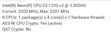

                          Changed as pst hinted and restarted the box (an old Xeon E3-1230)

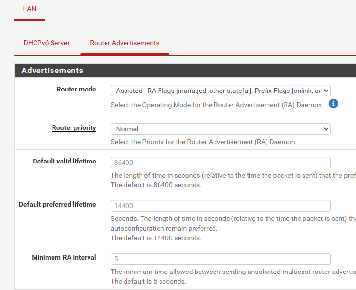

                          Now, here's my current config:
                          RA Mode: Assisted.
                          DHCP 4 and 6 on pfSense machine (ISC).
                          No reservations setup.

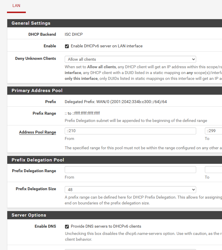

                          LAN:
                          RA:
                          DHCP:
                          • E Offline

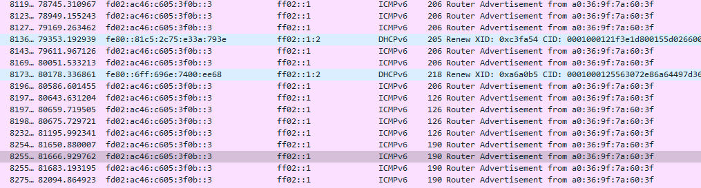

                            This is a linux vm running latest openSuSE doing DHCP:

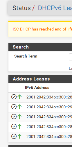

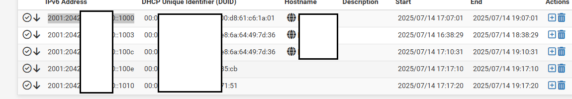

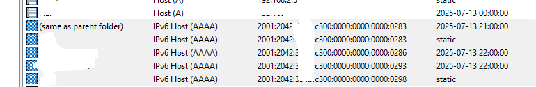

                            Meanwhile, it seems some IP address leases were in fact working:
                            They weren't last night but seems to have kicked in sometimes later.
                            They are all for Windows Server VM's running on Virtual NIC's.
                            Here they can be seen in the DNS server:

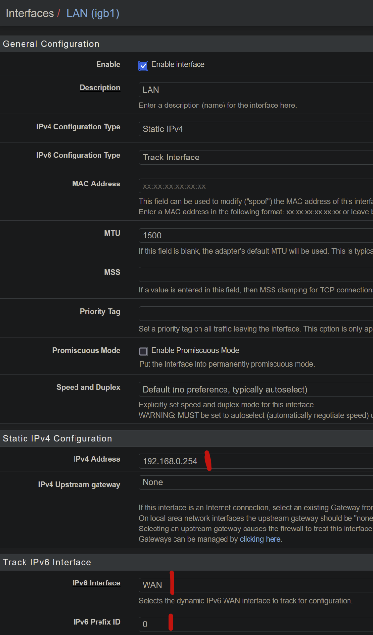

                                • E Offline
                                  Euroguy @Euroguy
                                  @Euroguy So, followup after a reinstallation of the system
                                  Short answer is, things now seem to work.
                                  Not sure why RA or DHCP did not work before.
                                  Only thing I did different now vs before is I started on LAN IPv6 to track interface and never tried to get static addressing to work
                                  So likely something in that config blockingly persisted/wasn't cleared as it should have.

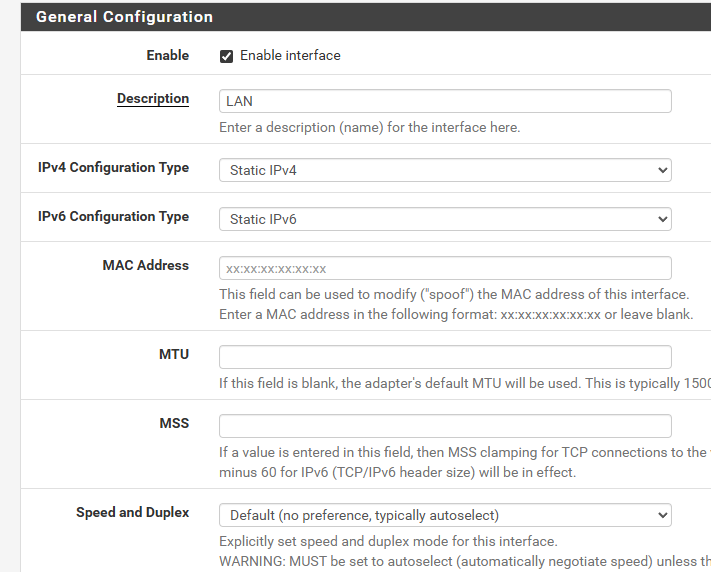

                                    Euroguy
                                    A few things noted, that I also noted earlier, that might help others:
                                    1. General setup allows changing of LAN and WAN addresses during the grub setup.
                                      Setting a static ipv4 adress other than 192.168.1.1 is however ignored and the system starts up with 192.168.1.1 after setup is done. So a post setup change of LAN address is needed.
                                    2. DHCP6 server fails as DHCP requests / Discovery is done on fe80::/10 and that is not considered to be LAN it seems. I had to add a LAN allow rule for fe80::10 to ff02::/16 like this for DHCP6 to work:
                                            Glad to see you got it up and running :)
                                            I get both DHCP4 and 6 clients with leases now (although status of lease seems broken, always showing black down arrow even though lease is active and remote machine is up and active
                                            I see that from time to time too. I think there are some timers that you can tweak (can't recall which ones though) that determines how long it takes without a "sign of life" before the client is marked as offline. For IPv4 there's an ARP timer ... and for v6 it should be an equivalent NDP timer. Can be set in System / Advanced / Tunables once you find out what they are called :)
                                            That rule shouldn't be needed, it is part of the automatic rule set added by pfSense. I get those by means of pfSense magic: (check in /tmp/rules.debug)
                                            pass in  quick on $WAN proto udp from fe80::/10 port = 546 to fe80::/10 port = 546 ridentifier 1000000463 label "allow dhcpv6 client in WAN"
                                            pass  quick on $LAN inet6 proto udp from fe80::/10 to fe80::/10 port = 546 ridentifier 1000002551 label "allow access to DHCPv6 server"
                                            pass  quick on $LAN inet6 proto udp from fe80::/10 to ff02::/16 port = 546 ridentifier 1000002552 label "allow access to DHCPv6 server"
                                            pass  quick on $LAN inet6 proto udp from fe80::/10 to ff02::/16 port = 547 ridentifier 1000002553 label "allow access to DHCPv6 server"
                                            pass  quick on $LAN inet6 proto udp from ff02::/16 to fe80::/10 port = 547 ridentifier 1000002554 label "allow access to DHCPv6 server"
