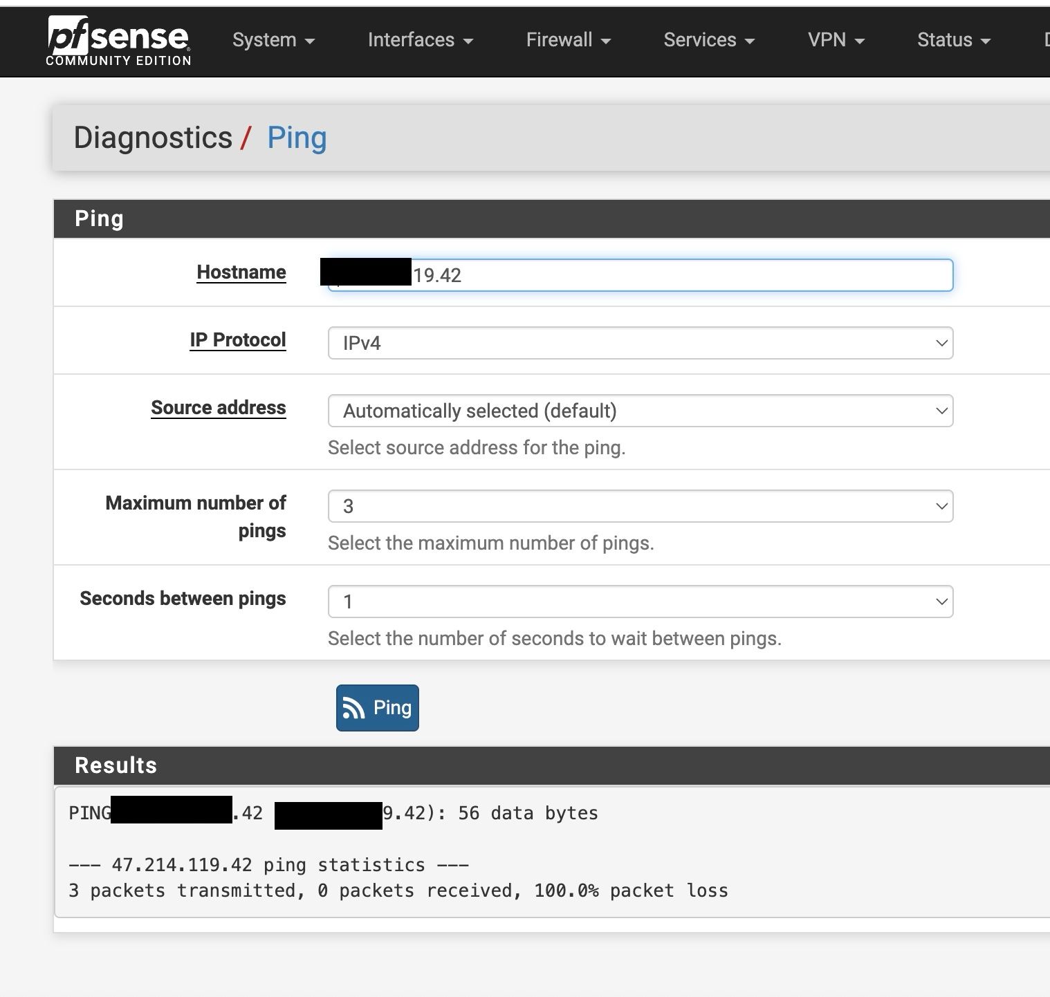

      If I ping from my laptop (terminal) or if I ping from the pfsense interface I get a timeout using the subdomain.mydomain.com address OR the public IP. I did NOT understand why the public IP would not ping?? (using Frontier fiber internet)
      If I connect the laptop to the internet using my phone tethered for internet the I can. ping both domain name or public IP from a terminal. So bottom line is that I am not able to ping or connect going outbound through my pfsense WAN but can ping or connect if I go out through tethered internet.

          I have disabled packet filtering on the home pfsense device and it still gets 100% packet loss with ping

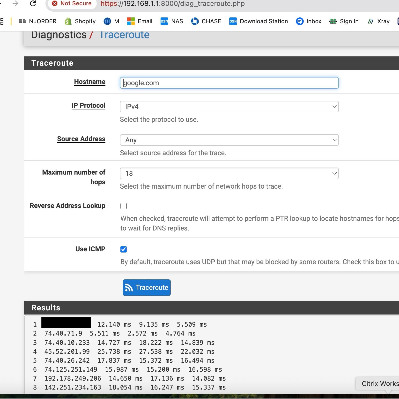

          I have attached the traceroute from the pfsense for both google.com and my mom public IP (both with packet filering still disabled)!

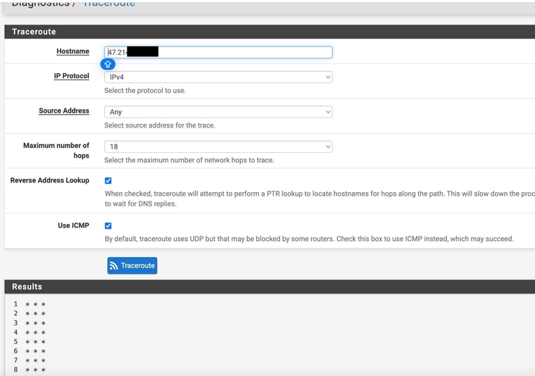

          The second pic is the traceroute to my mom's public IP address
          EDIT!!! SORRY THE SECOND PIC WAS JUST WHERE I DIDNT GIVE TRACEROUTE TIME TO COMPLETE

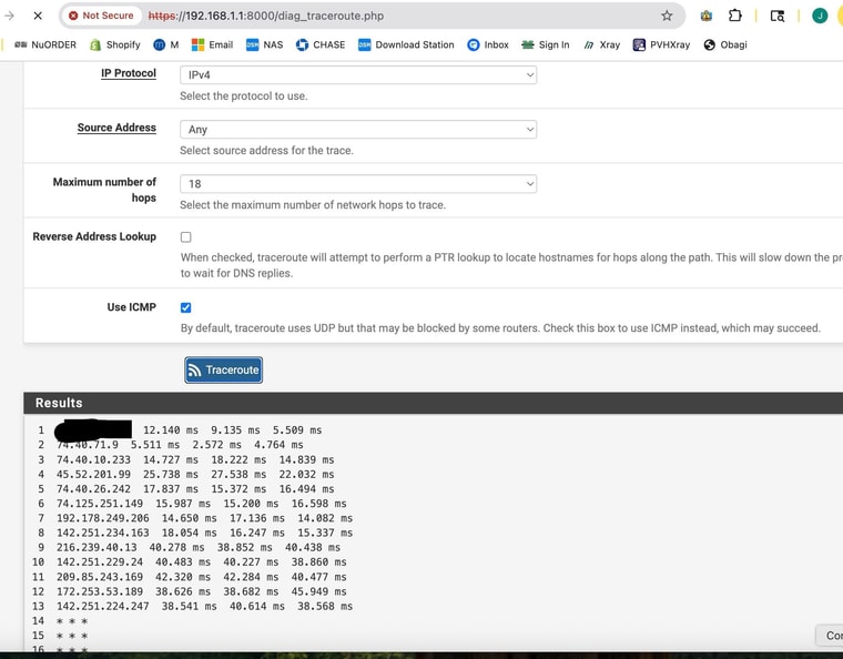

            Here is what happens with a traceroute WITH packet filtering disabled all together!!! (from pfsense machine)
            Why / how can that be?

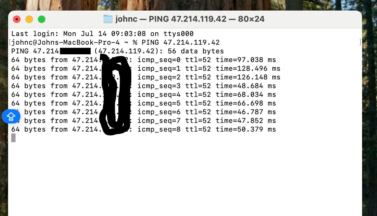

            Second pic is ping to same address form work laptop and work internet
