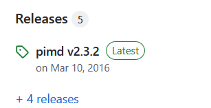

          As far as I know the pimd engine package pfSense has been using is the formally released pimd version, which is quite old and in fact not working on FreeBsd any more. So unless they did update that package ...

            It looks if you are referring to the pimd engine version
            Which is quite old, and as far as I know not working under FreeBSD. I have compiled the never released pimd-3.0.b1 version (using FreeBSD15 current).
