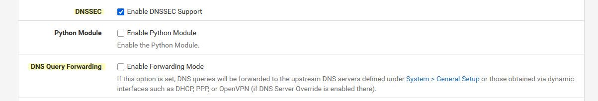

      I don't understand of the following Note in the documentation is relevant anymore.
      DNSSEC is not generally compatible with forwarding mode, with or without DNS over TLS.
      I don't think DNS over TLS and DNSSEC are mutually exclusive.
      What could be the harm. Seems both are needed these days. I use 2.7.2 and Cloudflare 1.1.1.2 and 1.0.0.2.

        Here’s how I understand it. Your Cloudflare forwarders are already are using DNSSEC. If you’re forwarding servers do not use DNSSEC or you are using the root servers then you would have it checked on. Having it on when you are forwarding to DNSSE servers can create problems. Like, double validation, leading to conflicting checks, blocked or broken DNS responses, your firewall not trusting validated responses, mismatched trust anchors or an incomplete chain of trust.

          @Uglybrian said in Netgate Documentation on DNS over TLS and NOT using DNSSEC:
          If they are not doing it - asking for it isn't going magically work.. If you forward , dnssec should be off.. Either where you forward is doing it or they are not - if they are not, having it enabled is only going to cause issues.
          They are since to use dot your forwarding - when you forward you shouldn't have dnssec enabled.
          If you want to forward, be it normal over 53, or using doh or dot.. Use of dnssec is going to be nothing but problematic.
          If you want to forward and use dnssec, then pick something to forward too that is doing it.. Most any of the major players are doing it, or have an IP you can use that does it.

              @Uglybrian here took me sec to lookup the url where quad9 gives the same advice
              https://docs.quad9.net/Quad9_For_Organizations/DNS_Forwarder_Best_Practices/
              Disable DNSSEC Validation
              Since Quad9 already performs DNSSEC validation, DNSSEC being enabled in the forwarder will cause a duplication of the DNSSEC process, significantly reducing performance and potentially causing false BOGUS responses.
              Not saying dns most likely won't work - you might not ever really run into a problem. But it is pointless and best case you are causing more dns traffic than is needed. Worse case is you run into issues actually returning an answer to what your looking for.
                SteveITS Galactic Empire @johnpoz
                Was about to reply with the same link. FWIW in my experience forwarding with DNSSEC on can cause random DNS failures, which as I vaguely recall seemed more apparent on some domains than others...I would guess those with DNSSEC configured but didn't bother pursuing, given the fix.
                Using DoT or not is not really relevant to the above. That's just how the router is making the query.

                      mark_lab_user @Gertjan
                      @Gertjan Very comprehensive and the analogy to FM radio and Stereo is great. (And fun too!)
                      Maybe some of the more popular Netgate pfSense advocates should update their instructions and/or videos. Youtube will send you in the wrong direction about 90% of the time but there are some dedicated folks that seem to want to clarify or update their material.
                      I wonder how we can reach out to them?
                      • johnpozJ Online
                        johnpoz LAYER 8 Global Moderator @mark_lab_user
                        @mark_lab_user said in Netgate Documentation on DNS over TLS and NOT using DNSSEC:
                        So you want them to something with this wording?
                        It seems pretty clear to me..
                          mark_lab_user @johnpoz
                          @johnpoz No. I want them to update their own material to reflect the fact that DNSSEC should be turned OFF inf the GUI DNS Resolver pages when using TLS.
                          johnpozJ S 2 Replies Last reply Reply Quote 0
                          • johnpozJ Online
                            @mark_lab_user.. Ah I would agree they could maybe add a note under dnssec checkbox. And to the forwarding checkbox that if forwarding dnssec should be disabled.
                            This should prob be listed under both options
                            "DNSSEC is not generally compatible with forwarding mode"
                              SteveITS Galactic Empire @mark_lab_user
                              https://docs.netgate.com/pfsense/en/latest/services/dns/resolver-config.html has:
                              DNSSEC works best when using the root servers directly, unless the forwarding servers support DNSSEC. Even if the forwarding DNS servers support DNSSEC, the response cannot be fully validated.
                              If upstream DNS servers do not support DNSSEC in forwarding mode or with domain overrides, DNS queries are known to be intercepted upstream, or clients have issues with large DNS responses, DNSSEC may need to be disabled.
                              https://docs.netgate.com/pfsense/en/latest/recipes/dns-over-tls.html#enable-dns-over-tls-for-forwarded-queries has the quoted text:
                              Using TLS (or not) is not actually related to this.
                              FWIW I did open a redmine a while back to auto disable it when forwarding, and it was declined.
