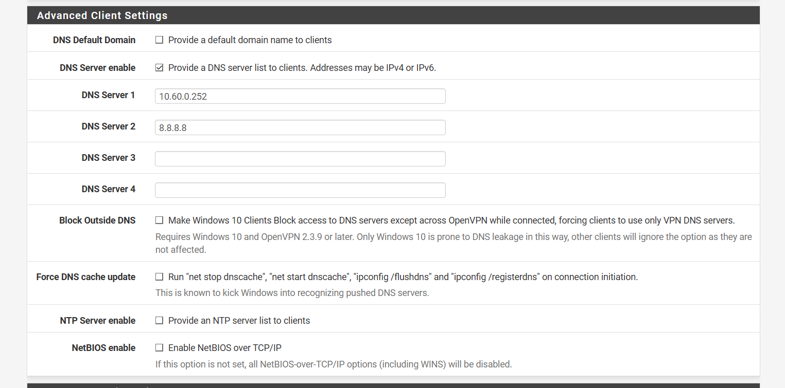

      DNS Settings in OpenVPN Server:
      ✅ "Provide a DNS server list to clients" is enabled.
      DNS Server 1: 10.60.0.252
      DNS Server 2: 8.8.8.8

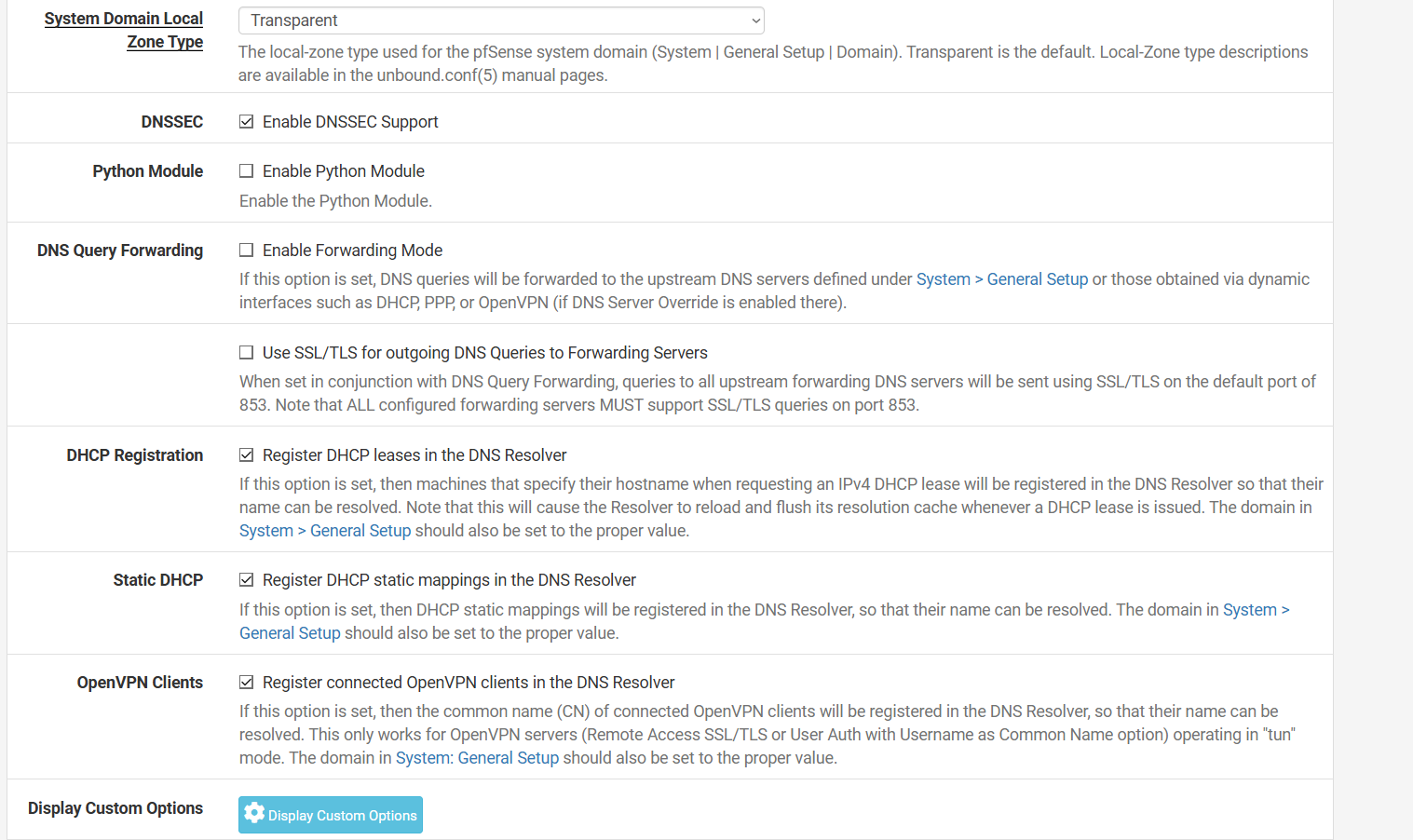

          here is the settings in dns resolver
          openvpn settings

            The only part of that config that matters in the host override in Unbound. Is that present?
            But you need to test from a failing client to see what DNS server it's actually using.

              @stephenw10 I deleted the dns server 2 and now in my phone I can access that url it worked, can you explain to me why it worked after deleting that dns server 2 (those are the configuration I found Im not network engineer, I'm devops)
                Because 10.60.0.252 is the server end of the VPN tunnel at pfSense. The local DNS resolver (Unbound) listens and responds on that IP and that is where the override is set.
                Where as 8.8.8.8 is Google's DNS service that knows nothing about any local overrides you might have set. When clients use that DNS server is bypasses any local DNS overrides.
