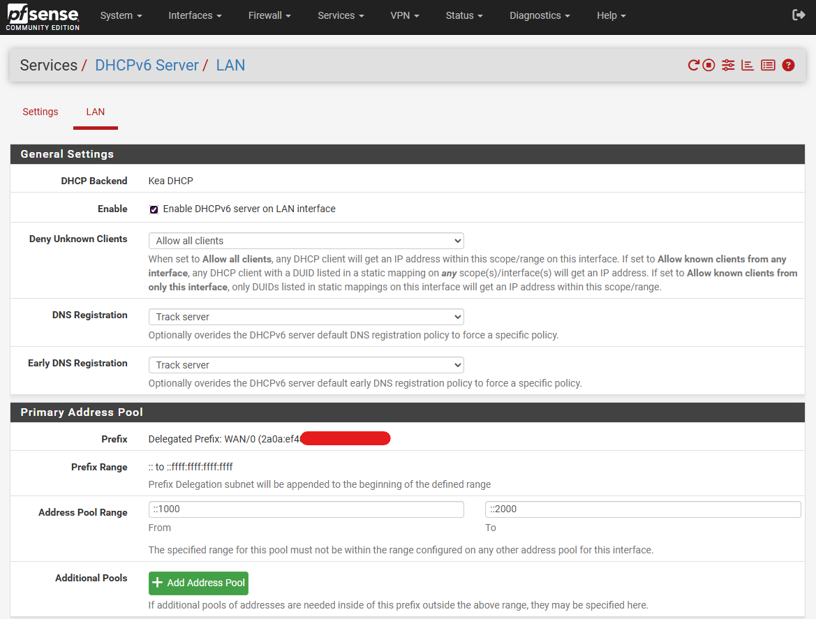

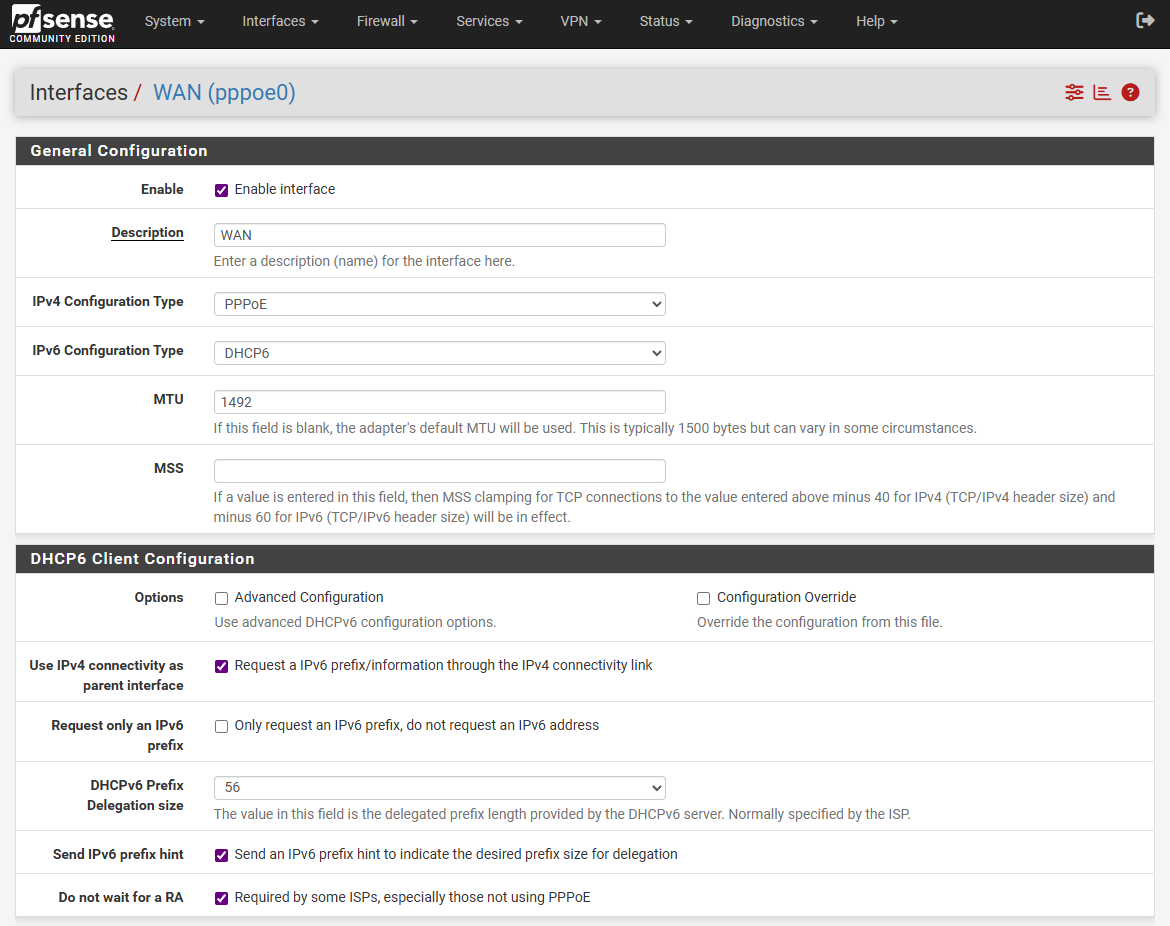

      I've recently configured pfSense 2.8 with ipv6 using Vodafone PPPOE.
      IP addresses assign correctly, I can ping out via ipv6 on pfsense and also from client machines.
      The only thing that isn't working is physically browsing ipv6 websites, they just fail to load even down to forum.netgate.com.
      I'll post my config below but any suggestions would be appreciated please because it's driving me crazy.

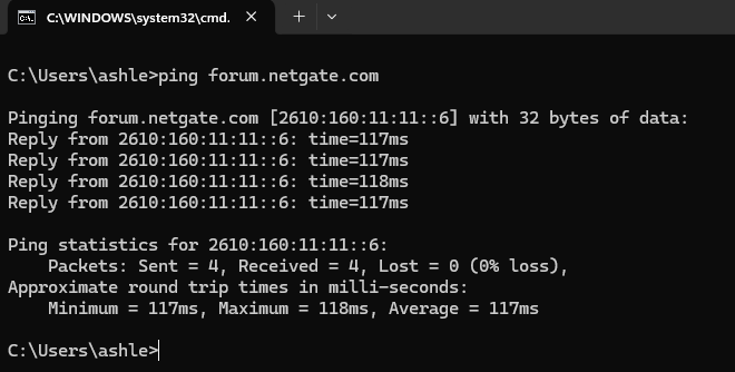

          ashleygavin @patient0
          @patient0 Tried this forum forum.netgate.com and it just fails despite being pingable.
          As soon as I enable ipv6 it stops netflix/paramount from streaming too.
          There are the default catch all NAT and firewall rules to allow out from any ipv6 to WAN
          DNS resolution is fine, I included a screenshot of that.
              @patient0 Given up with it and just disabled ipv6, not getting anywhere with it.
              Weirdly it works absolutely fine on my android phone can browse fine, the ipv6 test website confirms everything is fine.
              Windows however ipv6 address is assigned, can ping out via ipv6, resolve dns via ipv6 but the ipv6 test websites just say no ipv6 address assigned when I can clearly see it in ipconfig.
