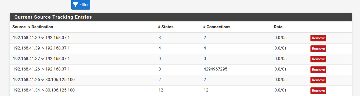

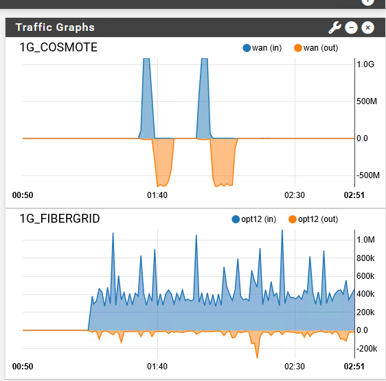

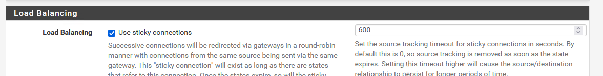

                          This works fine. With stickiness enabled I get this
                          Which is expected, and doing a speedtest utilizes randomly one of the two lines
                          This is with stickiness enabled
                          Unchecking "use sticky connections", the source tracking tab disappears (as expected)

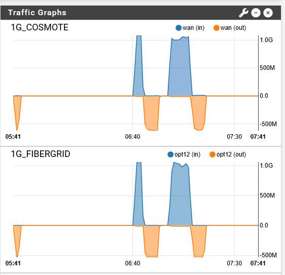

                          and a speedtest (multi connection by default) gets the aggregate as it should
                          Upgrading to 25.07 rc has no entries in the source tracking states and speedtests are always get the aggregate traffic.
                          This is a problem when visiting https sites , especially web banking and other session sensitive, since you get disconnected due to different source ip. It can be mitigated by excluding https traffic with policy routing, but then the issue persists on non standard ports.
