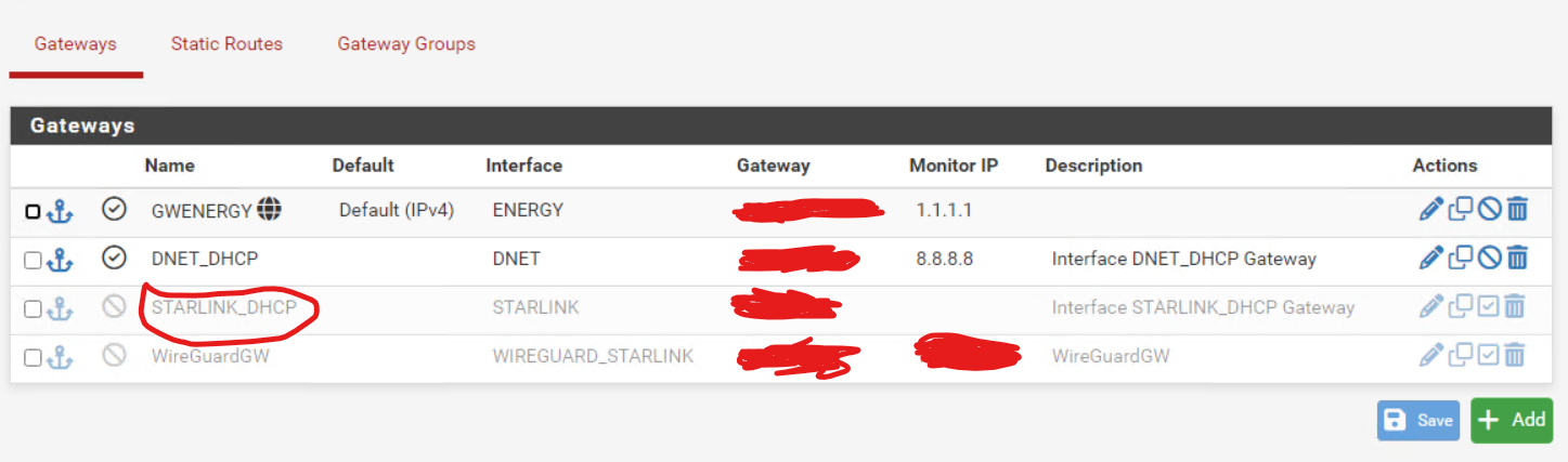

      After I updated pfSense to version 2.8, I've noticed strange behavior in the gateways. I have 3 links and a failover like this:
      ENERGY --> Tier 1
      DNET --> Tier 2
      STARLINK --> Tier 3

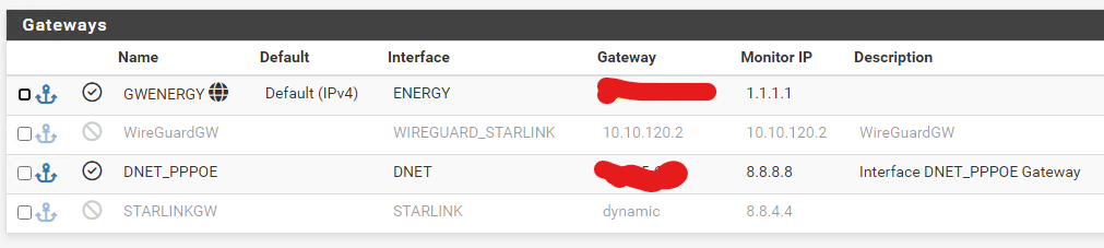

      What happens is that out of nowhere, pfSense changes the gateway to Tier 3. I disabled the interface and the gateway, and today, to my surprise, it was setting Tier 3 as the default.
      As you can see in the image, the Starlink gateway is disabled and just now it was set as default, whereas the default link was set to ENERGY.

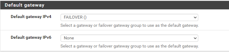

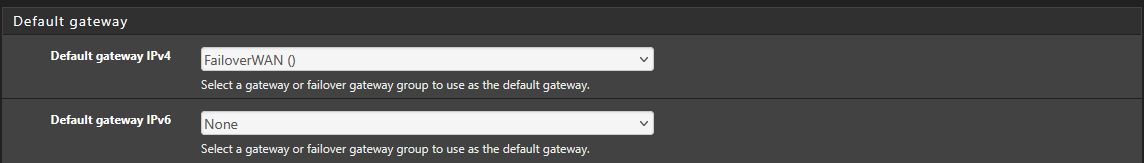

                    But importantly where are you using that gateway group? Is it set as the system default IPv4 gateway?

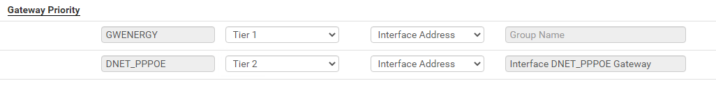

                      dond @stephenw10
                      When I refer to tier 3, I mean the position of this link in the gateway group when configuring FailOver.
                      I created the group and set the link to TIER 3.
                      My default group is FailOver, the group of gateways I created.

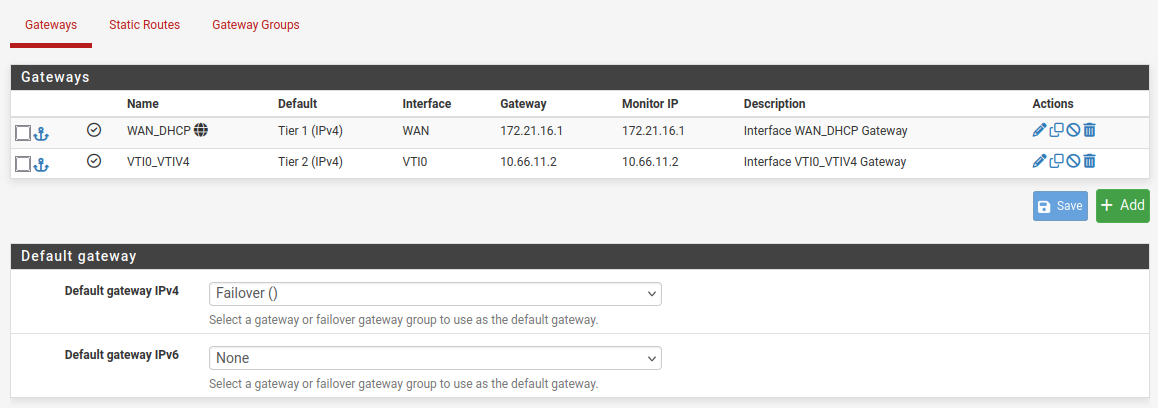

                      • chpalmerC Offline
                        chpalmer @dond
                        @dond Some information that you might run into on yootoob is either outdated or just plain wrong in case you have referred to that service when originally setting your system up..
                        This is my setting for comparison-
                        What I do not know is how IPv6 affects this as I do not use it here.

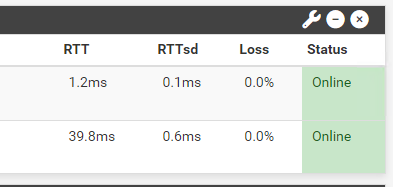

                                    @dond Do you have the "Gateways" widget on your dashboard? Does it show any loss to any of the gateways?

                                      dond @chpalmer
                                      @chpalmer
                                      This is what is strangest in my dashboard, the two normal likes visually
