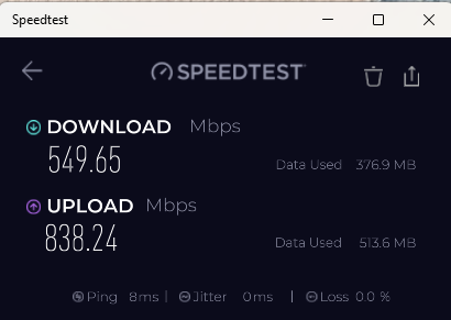

      I have a Netgate 2100 and have just upgraded my broadband to fibre to the premises, and am connecting with if_pppoe turned on in pfSense 25.07 RC. The fibre delivers 910Mbps up and down when tested with the ISP-provided router (a Fritzbox). With my 2100 it can achieve the 910Mbps up, but maxes out at about 600Mbps down.
      I do not have Suricata or Snort or other heavy services running, but do have NAT and the firewall.
      I appreciate that inbound traffic has a little more checking to be applied to it, and if this was the behaviour I was seeing from a mix of many different connections generating the bandwidth, I'd say "fair enough". But this is the performance using a speedtest app. Presumably each successive packet has the same characteristics as the previous one and requires the same treatment. So if pfSense cached recent packet rule outcomes, surely it should be nearly as fast to process as the outbound case. However it ends up CPU-bound at a much lower throughput.
      Without deferred ISR handling it maxes one core at 100%. With deferred it loads both cores, but still maxes out at the lower bandwidth.
      Given that the hardware can handle 910Mbps outbound, is there anything I can do to get closer to this inbound?

                OracPrime @SteveITS
