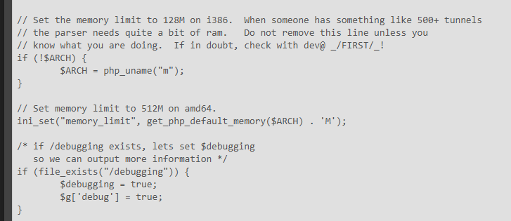

      I also tried editing the file shown below:
      However, I'm a bit lost at this point. I can only find very old threads, and it seems the code has changed. Previously, it looked like this:
      // Set memory limit to 512M on amd64.
      if ($ARCH == "amd64") {
      ini_set("memory_limit", "512M");
      } else {
      ini_set("memory_limit", "128M");
      That would have been easy to modify โ€“ but unfortunately, it's no longer like that.
      Also, when searching the error on the forum or Google, I only find bug reports that are already marked as resolved or outdated threads from 5โ€“10 years ago.

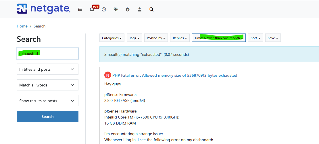

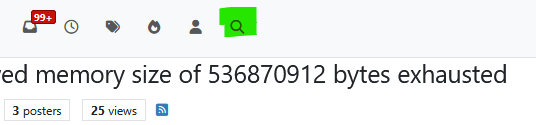

            Use this one :
            and enter the word 'exhausted' - and limit the search for answers for the last 4 weeks :
            and scroll down : you find a second post, with the same question, same type of device.
            And the solution.
              But specifically if you're running DNS-BL with a number of lists and kea2unbound make sure you're using Python mode to avoid this.
