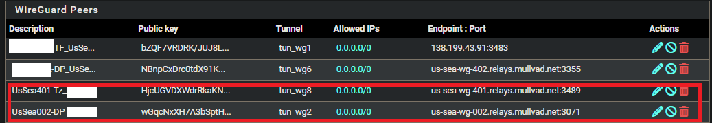

      If all wireguard gateways are down (after a reboot for example) and I change the wireguard peer's endpoint IP address from mullvad's domain name to mullvad's ip address, all the wireguard gateways go up shortly after. Even the wireguard gateways that still have mullvad's domain name set in the peer endpoint setting.
      If I change for example this peer's endpoint to mullvad's domain name instead of IP, as seen below:
      The Wireguard peers outlined in red will connect fine. But the top two will not connect at all unless I change the endpoint back to an IP address.

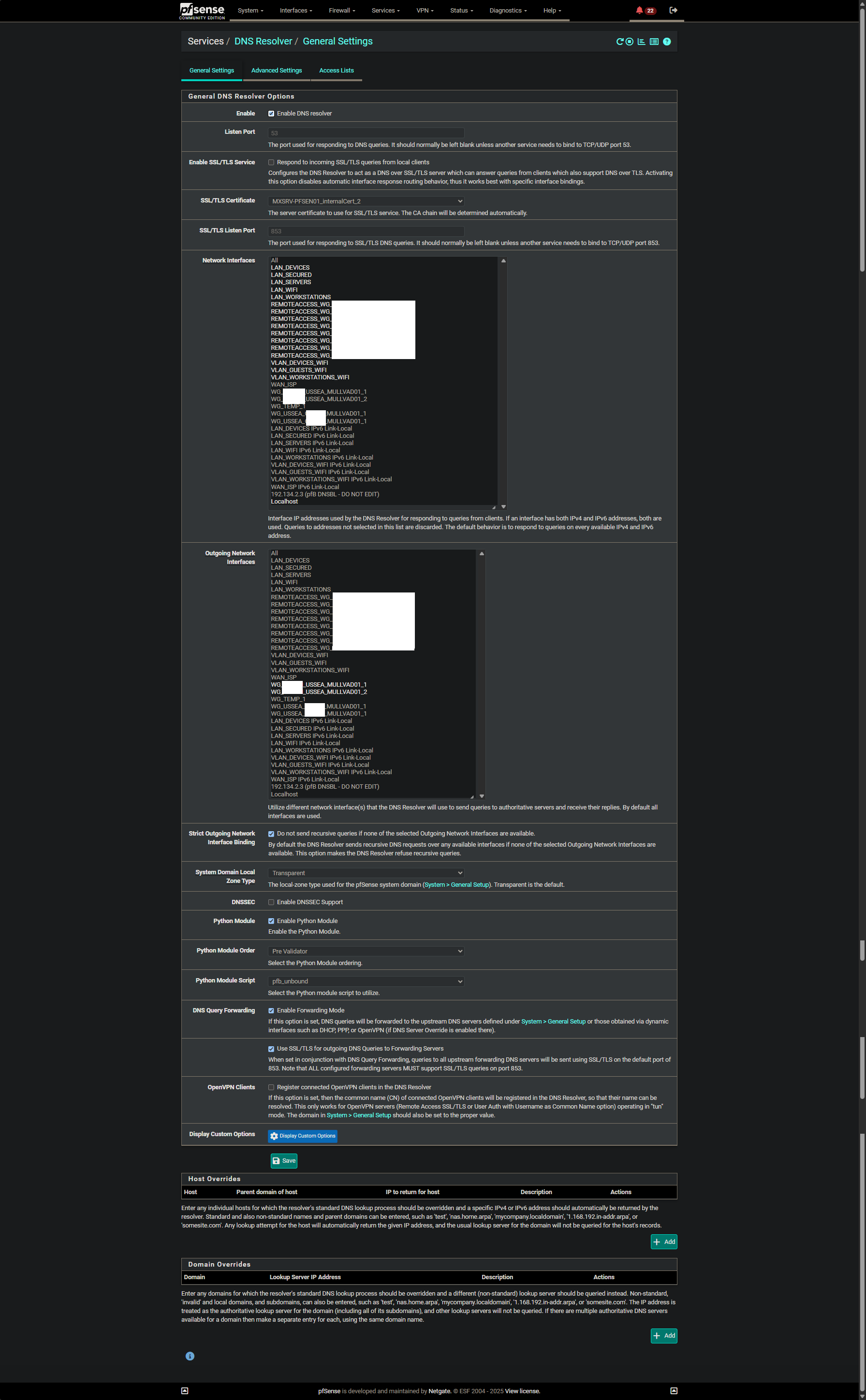

      My DNS Resolver settings:

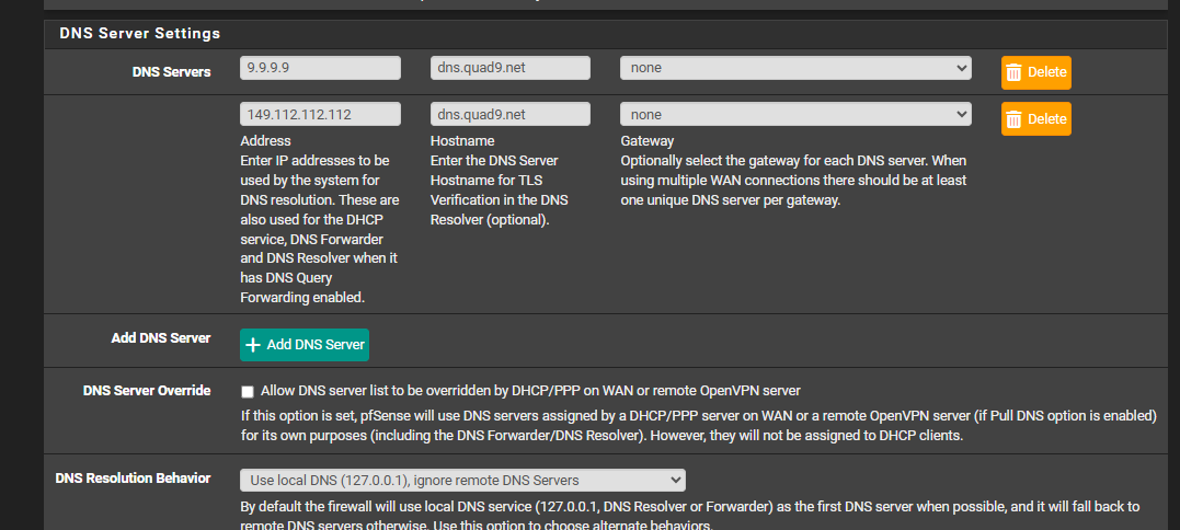

      My System -> General Setup DNS Settings:

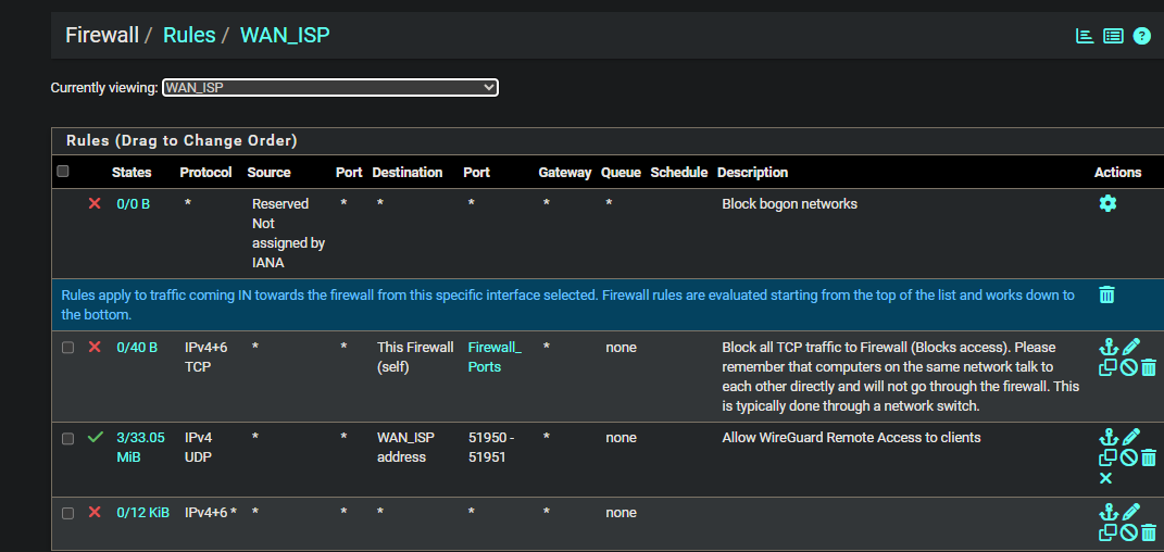

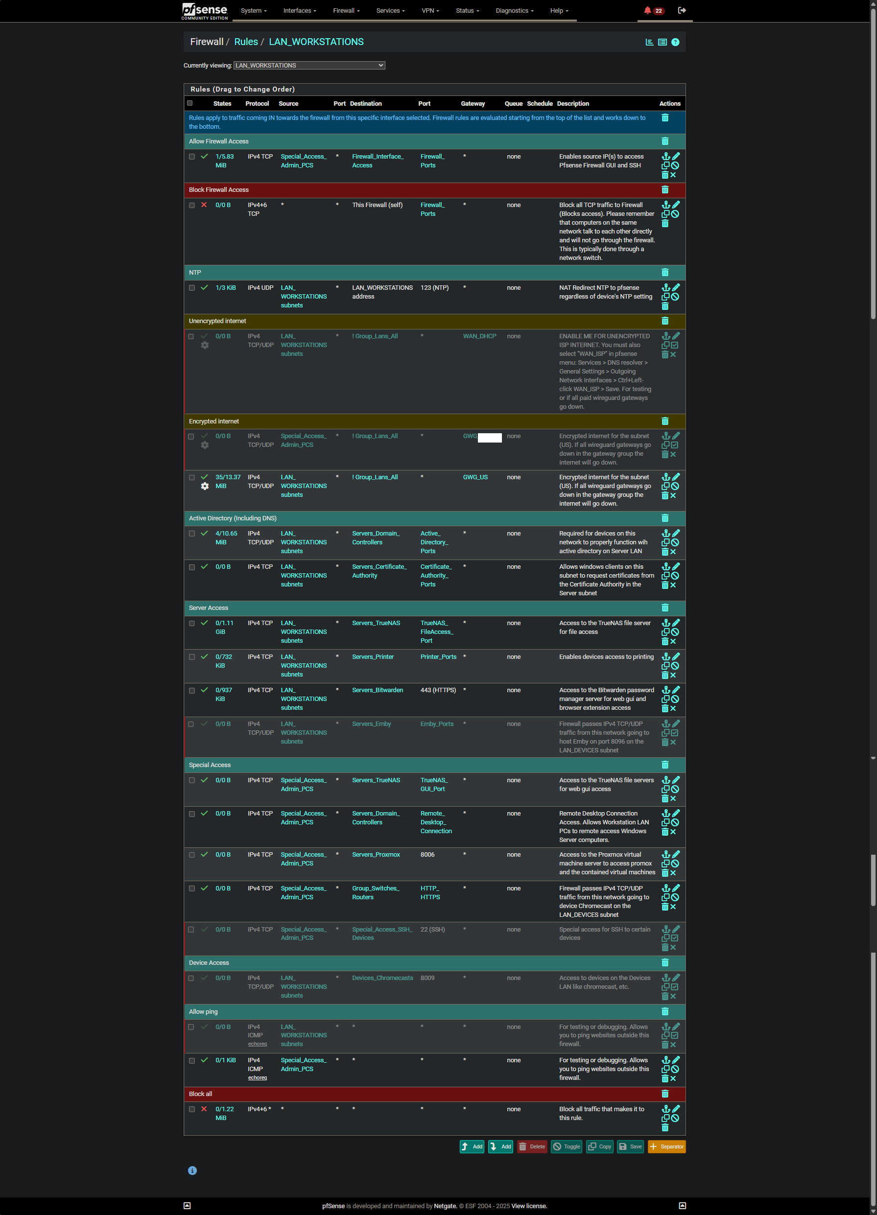

      WAN Interface firewall rules:
      Example of wireguard interface (all are the same):

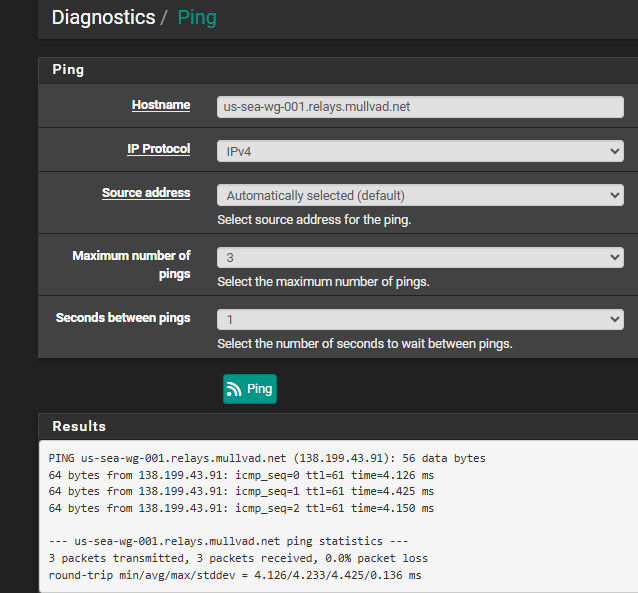

        Ping a mullvad domain endpoint that causes wireguard gateway to have 100% packet loss:

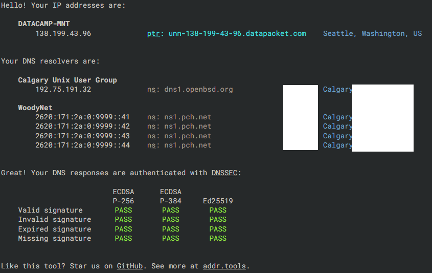

              Interestingly, I change General setting dropdown DNS menus to WAN and change dns resolver outgoing network interfaces to only WAN.
              The outcome:
              • Now using domains in all wireguard endpoints work when I restart the wireguard service on pfsense everytime, where as before the OP issue would occur every time.
              • DNS leak test shows i'm still using QUAD 9 for DNS but also shows Calgary Unix User Group. Before, it would show DNS location of USA (same as my wireguard). The new location it shows is now in my country but not close to me.
              Do you know what's going on there? Why isn't it showing location close to me? Quad9 definitely has dns servers way closer to me. And that UNIX group doesn't seem to be affiliated with Quad9. And Woodyneed is only showing ipv6 addresses.
              Sorry to pick your brain but do you know of any work arounds to not use WAN as dns to make this work? I guess you already said you don't have a solution :(
              Thanks!

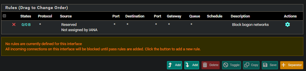

                                      I noticed that when I did this, I immediately got WAN_ISP interface blocks with source: being my mullvad wireguard gateway ips and destination: my quad9 public ips using dns over tls port 853 set at system -> General setup -> DNS Servers.
                                      These are the blocks in the firewall log:
                                      and if I hover over the red X, I see:
                                      Could this be causing my issue? How can I find this block rule and remove it? I looked at firewall rules on WAN interface and I don't think I saw a WAN rule that matched that ID when I hover over the red Xs:
                                      Thank you
                                      EDIT: after doing some digging I think this is some sort of default rule that cannot be removed? Do you know if there is some allow rule I can create to make this work in a secure manner? The only thing is, I think the wireguard mullvad gateways IPs can/will change...
                                      C P 2 Replies Last reply Reply Quote 0

                                          • DNS Resolver settings has this rule unchecked, do I have to enable this?
                                          It also has this enabled (which I know isn't enabled by default):
