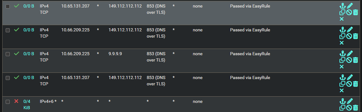

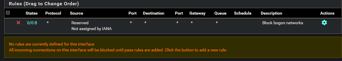

      @chrcoluk Under System logs -> Firewall -> Normal view where the blocks to quad9 were appearing on wan interface, I also tested clicking the + sign on the desintation column "EasyRule: Pass this traffic" for all the entries. After that I restarted wireguard and it some how made the issue worse. None of the wireguard interfaces go up now. Before, at least some of them would successfully come online. They're all Offline, Packetloss 100% now, even after removing the new WAN interface allow rules and restarting wireguard. I had to add the IP address to the mullvad wireguard peer endpoint.
      I think this just may be a distraction. I will focus back on understanding and doing the bind method

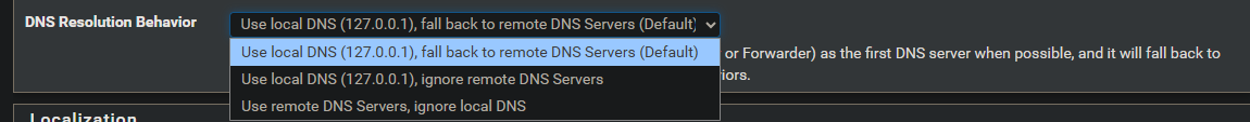

          Interestingly, after playing around with more settings, this seems to have fixed is completely!:
          in system -> general setup:
          I change it from:
          use local DNS (127.0.0.1), ignore remote DNS Servers to
          Use local DNS (127.0.0.1), fall back to remote dns servers (default)
          I dont seem to be getting DNS leaks (from dnscheck.tools) and now I can restart, stop/start wireguard and all wireguard gateways come up really fast now.
          Do you know what Use local DNS (127.0.0.1), fall back to remote dns servers (default) is doing? and why this works? Any privacy concern using this?
          Thank you!
            chrcoluk @pfsenseuser10293
            @pfsenseuser10293 using localhost will make it use the service you have configured whether thats unbound or bind. otherwise pfSense can query forwarders directly.
            It will probably be fine how you set it now, pfSense only needs DNS for its own updates, news widget on dash, and to connect to the VPN's.
