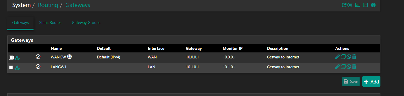

      • Gateways (System / Routing / Gateways):
        • WANGW: Interface WAN, Gateway 10.0.0.1, Monitor IP 10.0.0.1 (Default IPv4)
        • LANGW1: Interface LAN, Gateway 10.1.0.1, Monitor IP 10.1.0.1

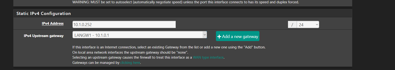

      • LAN Interface Configuration (Static IPv4 Configuration):
        • IPv4 Address: 10.1.0.252 / 24
        • IPv4 Upstream gateway: LANGW1 - 10.1.0.1

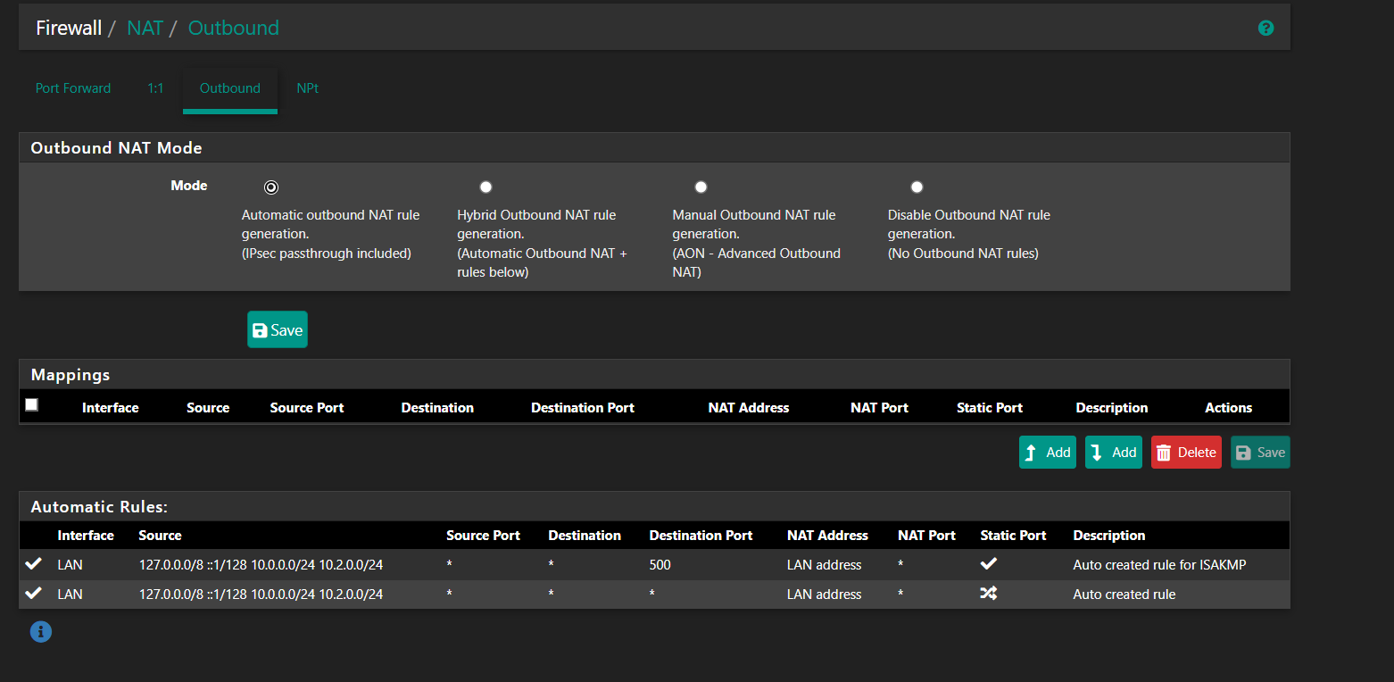

      • Outbound NAT (Firewall / NAT / Outbound):

            Did you https://docs.netgate.com/pfsense/en/latest/recipes/virtualize-proxmox-ve.html#disable-hardware-checksums-with-proxmox-ve-virtio?
            Normally an internal network doesn't have a gateway. pfSense will consider that a WAN interface. And then it needs to decide to which gateway/WAN to route packets that aren't for its networks. Were they trying to set up a static route?

              Mmm, your auto outbound NAT rules show that the WAN interface is not configured with a gateway on it and the LAN is. That's the opposite of what I would expect to see there.
              Are you expecting pfSense to NAT that traffic from LAN side hosts leaving the WAN? It doesn't have to be NAT'd there is the upstream router (Proxmox here) is NATing traffic from the LAN subnet. And it looks like you do have a masq rule there for it.

                  @zikou Normally one does not need to change Outbound NAT routing unless you're trying to do something specific like have certain traffic use an alias IP.
                  It also looks like you're trying to map traffic on the WAN interface in your screenshot?
                  I suggest leaving Outbound NAT at Automatic.
                  A LAN network does not have a gateway because pfSense should be routing any traffic for other networks to its gateway, i.e. towards the Internet. So unless you have two Internet connections there should be only one gateway.

                    I set the upstream of LAN to none still low upload

                      What about on the WAN interface config? Does that have the upstream gateway set?
                      If so you should then see the auto outbound NAT rules generated for the LAN subnet to WAN translation.
                      But, as I said, the rules you have in proxmox make it look like it's NATing the LAN subnet there and if so you don't need any outbound NAT in pfSense. However that would require a route in Proxmox.
                      So check in Proxmox does it have a route to the LAN subnet via the pfSense WAN? If it's routing via something else that may cause the asymmetry.

                          Ok, two problems there:
                          The gateway is not set on the WAN interface in pfSense. Which means no auto outbound NAT rules are generated for it.
                          The traffic route from the client is not going through pfSense at all. It goes to the pfSense LAN and is redirected to 10.1.0.1 which is some other router in the LAN subnet. It never goes to the pfSense WAN side.
                          And that is where your asymmetric route is because reply traffic just goes from that other router to the client directly which means pfSense never sees it and hence will be blocking traffic.
                          What is 10.1.0.1? I don't see it in the Proxmox routing table.
                          Unless there's some other subnet behind that you need access to you should remove that as a gateway in pfSense. Make sure the WAN gateway is set as default and is on the WAN dircetly.
                          However as I said before it looks like whoever set this up expected hosts to use the LAN directly because it has a MASQ rule for that subnet. Normally that would not exist is clients had to use pfSense to get external access.
