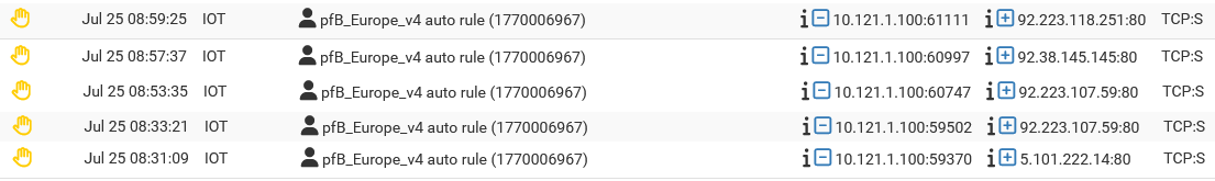

      I've been trying pfBlocker on my new hardware (32GB memory, 500GB NVMe, capable 8-core CPU), and I think there are issues with either the installation (or the GeoIP part of program itself ?) as I am getting outbound firewall blocks from pfB saying the destination IP is in Europe, when it is actually in the US, Canada.
      https://www.iplocation.net/ip-lookup
      165f67e3-e945-49bc-ba57-fdb0366bbb4c-image.png .

        SteveITS Rebel Alliance @njaimo
        IPv4 addresses "move" as blocks are bought and sold. It's possible MaxMind needs to update their data, which IIRC it does once a month.

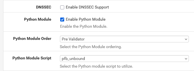

          I checked the python ooption in DNS Resolver

              ...one more question ? -- the DNS Resolver python options show 'pre-validator" or post-validator", is there any preference for using pfB ?
                @njaimo There's a note on https://docs.netgate.com/pfsense/en/latest/services/dns/resolver-config.html
                Python Module Order:
                Controls the position of the Python module in the DNS resolution process. If DNSSEC is disabled, this option has no effect.
                Pre Validator:
                    The script is run before DNSSEC validation.
                Post Validator:
                    The script is run after DNSSEC validation.
                Since we normally forward (to Quad9) we disable DNSSEC.
                Upvote 👍 helpful posts!
                • N Offline
                  njaimo @SteveITS
                  @SteveITS ...got it, I should have looked in the docs... I do too use Quad9 and have DNSSEC disabled, so I guess my question is pointless..
