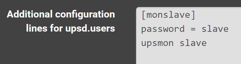

      Hello,
      I installed NUT Package on pfSense as Master with no advanced settings. This setup is working fine.
      My goal is to have unraid server attach to pfSense as slave. I entered in the upsd.conf section
      LISTEN 192.168.10.1 3493. It's not clear to me what I need to add to upsd.users section inorder to have unraid server connet. Also do I need to enter any other information in the other advanced settings section?

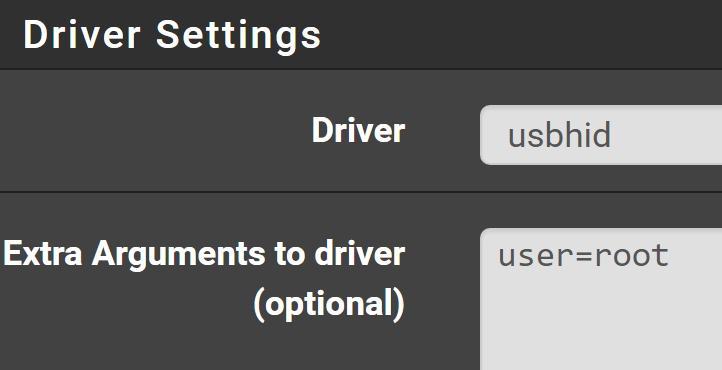

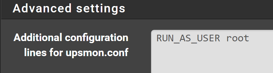

        Did similar, but so long ago... Anyway, here are my settings. HTH
        If you need something from the NAS side, post back.

          @provels Thanks for your reply and help. I'm now able to have unraid connect to the NUT server.
