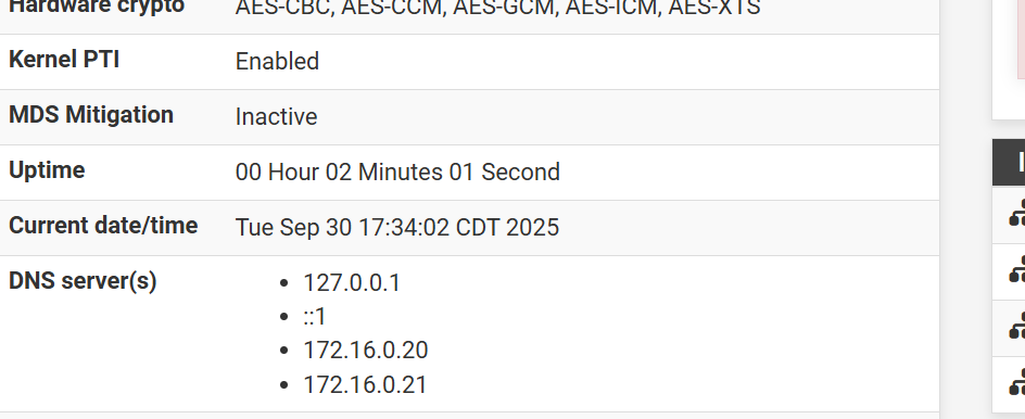

                                So did the 2.8.1 upgrade and let the boxes do what they do. After everything was stable, I shut them both down and brought them up again. Within 5 minutes the backup FW crashed. So unfortunately, the beta version did not fix my issue it seems. I no longer have any option to go back to 2.8.0 so seems I'm stuck with a beta that doesn't fix anything for me. Worth a try I guess but I guess I am relegated to starting over unless someone can sort out what the posted crash reports say. I can't make heads or tails of it.
