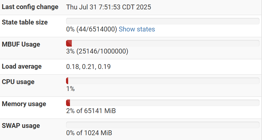

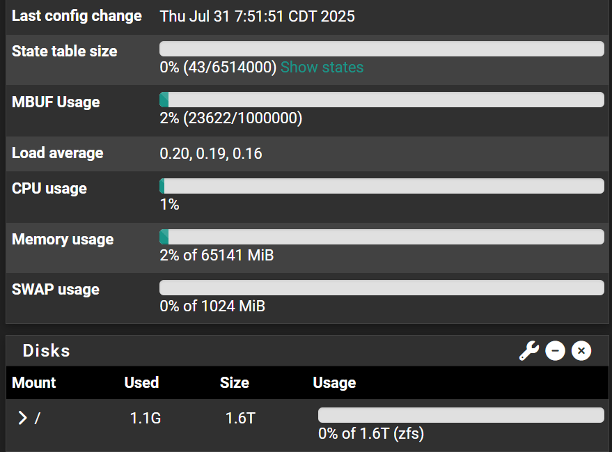

      Looks like maybe SWAP is enabled but only to 1024MB.
      Seem correct? Dark is primary, light is secondary and the one that's crashed the most.
        Hmm. Unfortunately I think you'd almost certainly need to reinstall that with a more SWAP to be able to dump the full core.

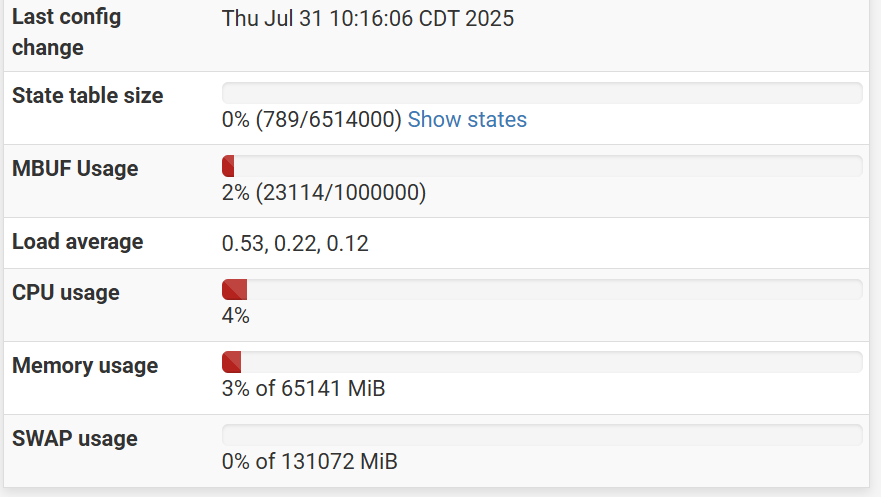

                      OK I think I have the swap configured now:
                      Anything else required to get this to get the info we need?
