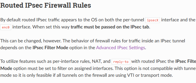

            mcury Rebel Alliance @planedrop
            According to the documentation below:
            https://docs.netgate.com/pfsense/en/latest/vpn/ipsec/routed-vti.html#policy-routes
            https://docs.netgate.com/pfsense/en/latest/vpn/ipsec/routed-vti.html#routed-ipsec-firewall-rules
            https://docs.netgate.com/pfsense/en/latest/vpn/ipsec/routed-vti.html#vpn-ipsec-vti-firewall
            https://docs.netgate.com/pfsense/en/latest/vpn/ipsec/advanced.html#advanced-ipsec-settings
            IPsec Filter Mode should be set to Filter IPsec VTI and Transport on assigned interfaces, block all tunnel mode traffic in IPsec advanced options.
            planedropP 1 Reply Last reply Reply Quote 0
            • planedropP Offline
              planedrop @mcury
              @mcury This can't be done if you want to use both VTI and tunnel based IPsec at the same time, since you can't put rules on the tunnel interfaces.
              I did read all the documentation, and that specific page about 2 dozen times. (for what it's worth, I've also ready all of pfSense's docs cover to cover twice).
              The issue here is that I need both VTI and normal tunnel IPsec, so I can't change the filter mode.
              And again, the connection works, and traffic passes just fine if my rules are in place without selecting a gateway, it's only when a gateway is selected for the policy routing that the traffic doesn't appear on Firewall 2s VTI interface, only on Firewall 1s.
                  planedrop @mcury
                  @mcury The documentation does not say that policy routing doesn't work without changing the IPsec Filter Mode.
                  It says:
                  To policy route traffic across a routed IPsec tunnel, use the assigned IPsec interface gateway in firewall rules as usual for policy routing.
                  And:
                  This may not work as expected without NAT and/or reply-to, which require special settings. See Routed IPsec Firewall Rules for details.
                  I don't personally think may not work as expected tells me that it will not work.
                  Part of the reason for this is that I'd like to policy route to a gateway group, the production use case for this is connecting to a VPC that requires VTI to be used, but also requires 2 tunnels to be up. I only need to route a single subnet, so BGP would be more time than I'd like to spend, but was hoping to still benefit from the redundancy.
                  If I can't do that, I will just configure it for a single tunnel with no gateway selected in the Firewall Rules, but from what I am understanding in the docs, this should still work.

                        planedrop
                        Yeah so as an update, it did work just fine when I changed the IPsec Filtering Mode, so it appears policy routing just doesn't work at all in the default mode.
