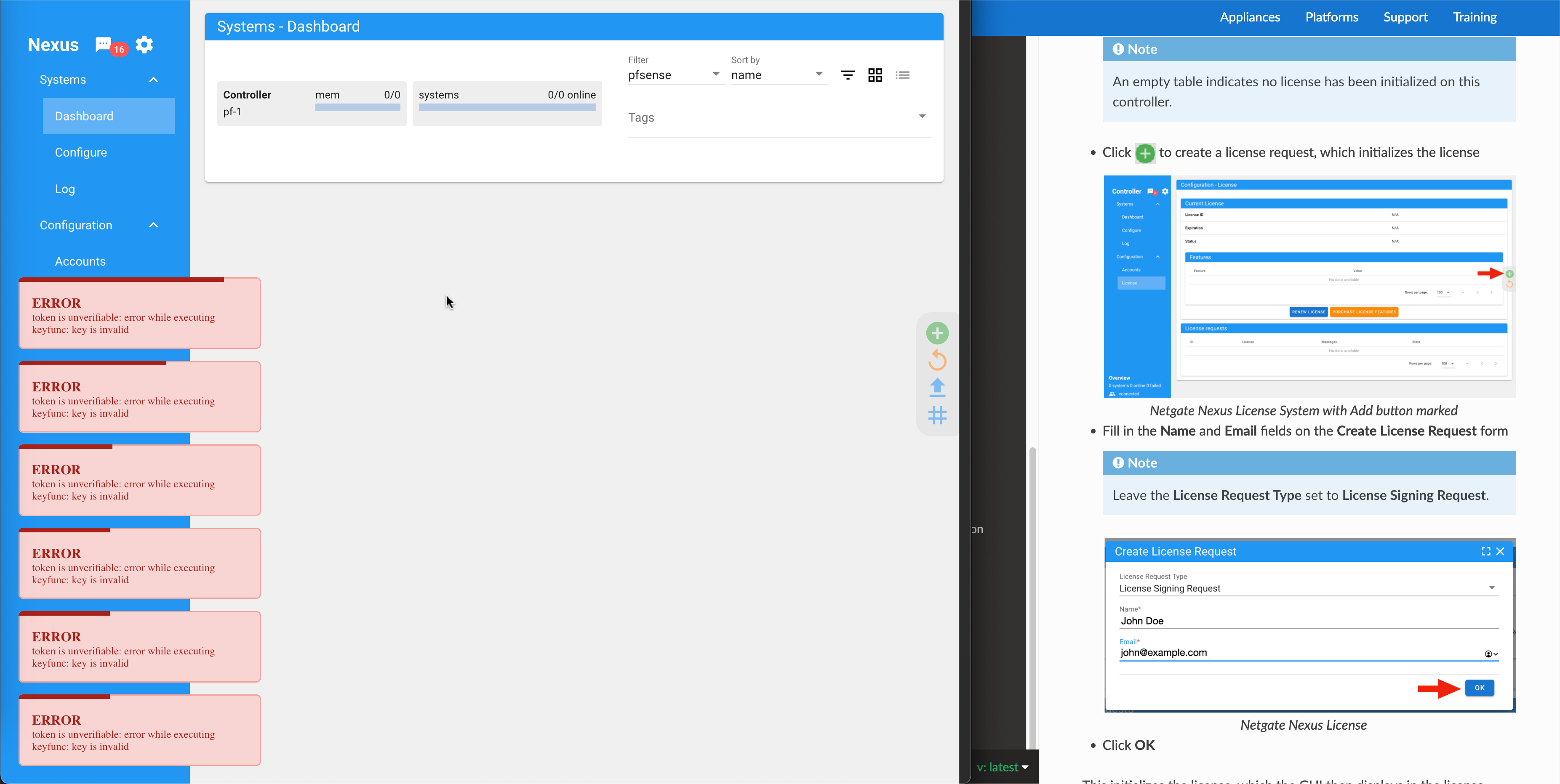

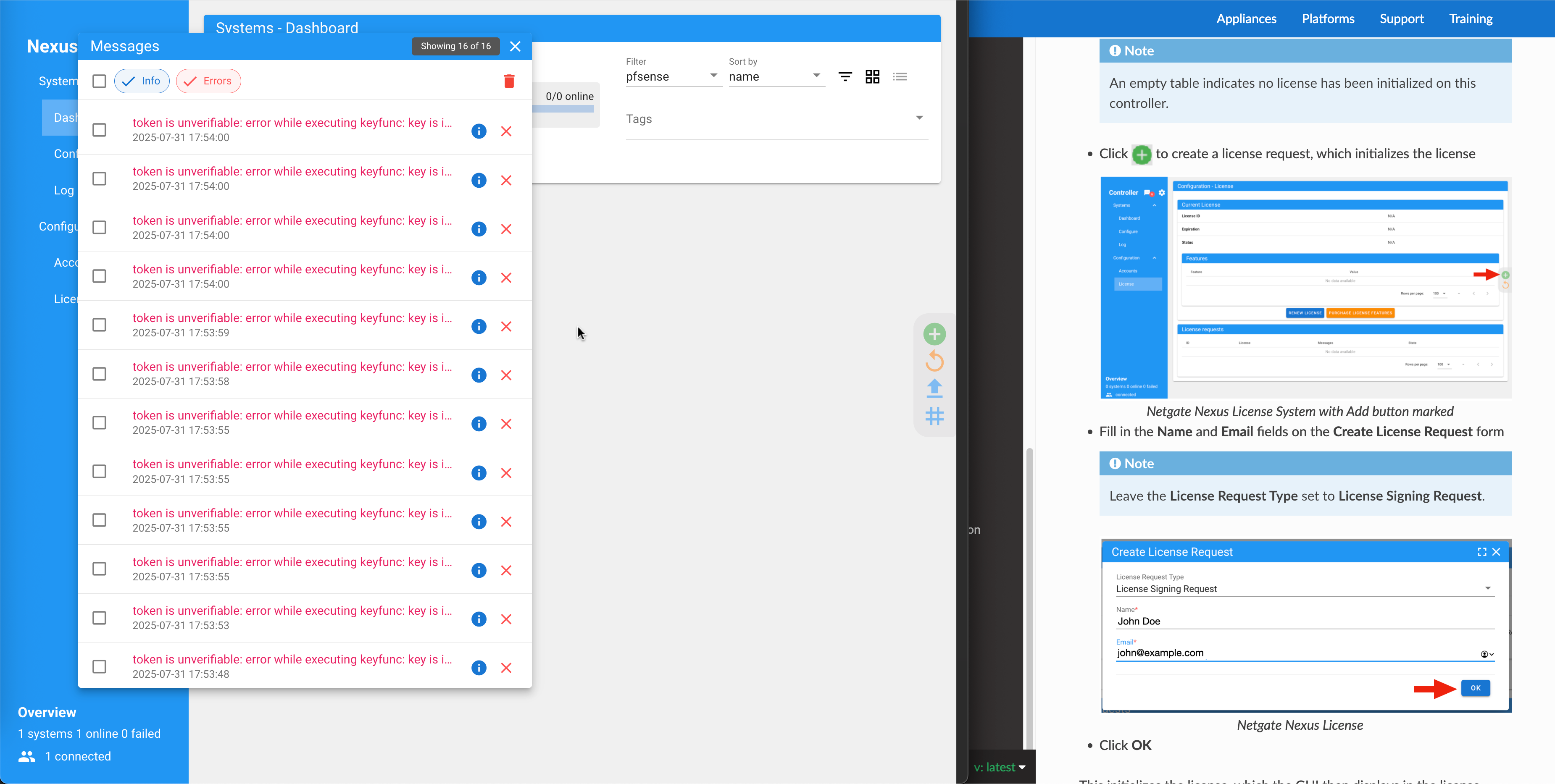

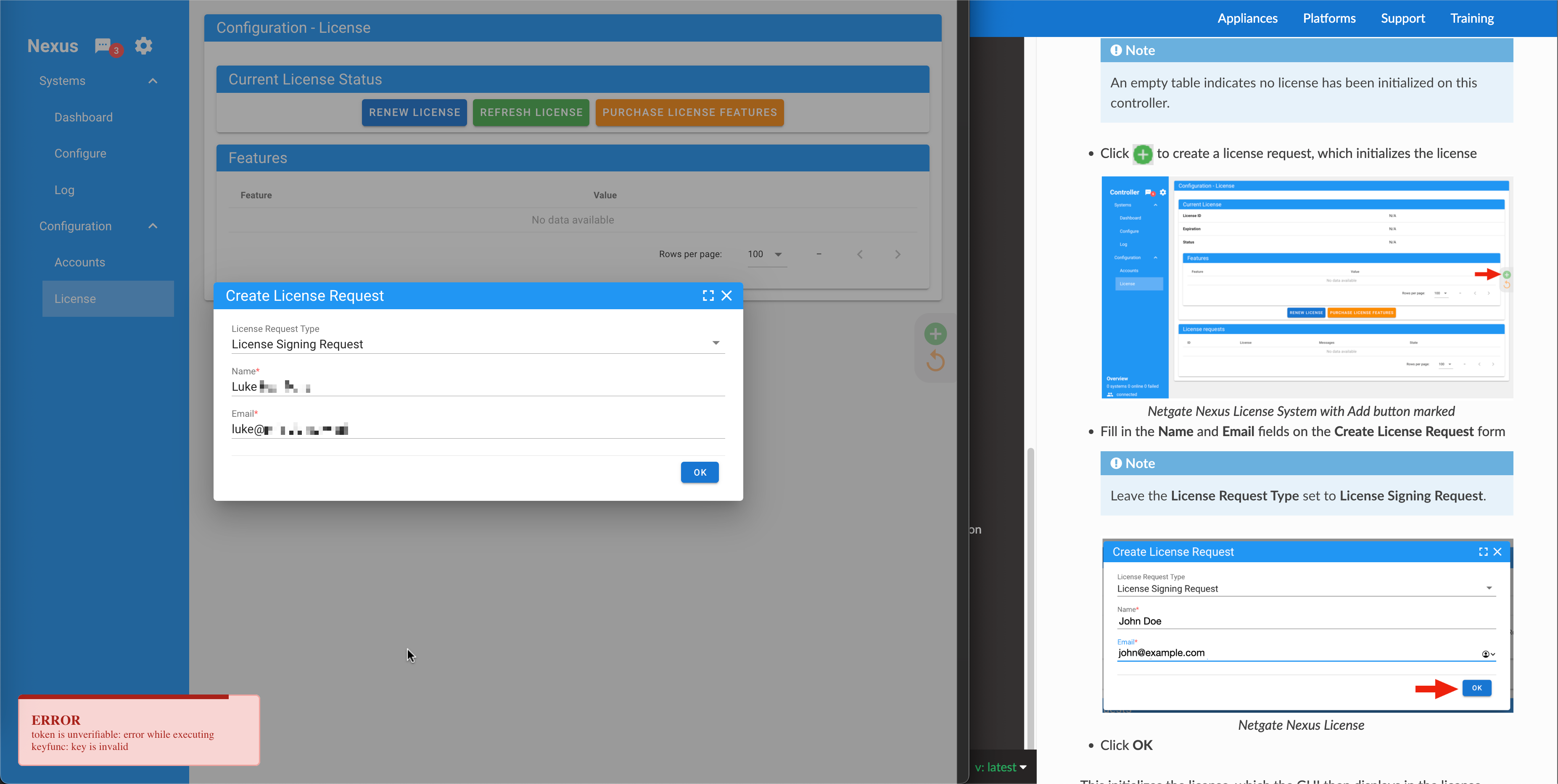

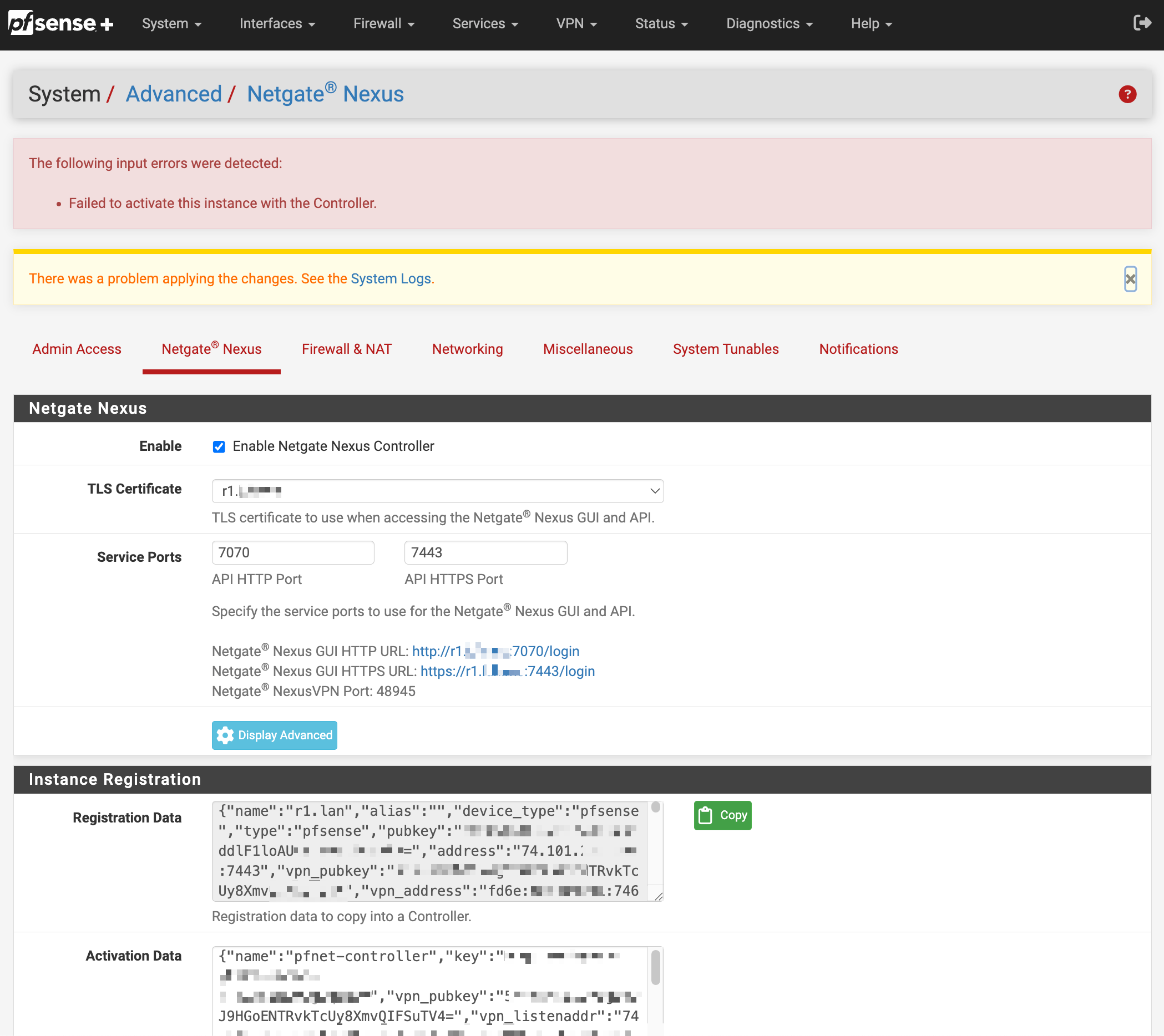

      But, I failed (I think? or maybe I succeeded?). Got a handful of API errors and failure toasts. Is this feature not operational yet, or is something wrong with the buttons I'm pressing?
      Here are some assorted screenshots:
        marcosm Netgate
        When you enable MIM you only need to register additional instances. The pfSense+ instance that Nexus is running on doesn't need to be registered since that's handled automatically. Were there any other issues?

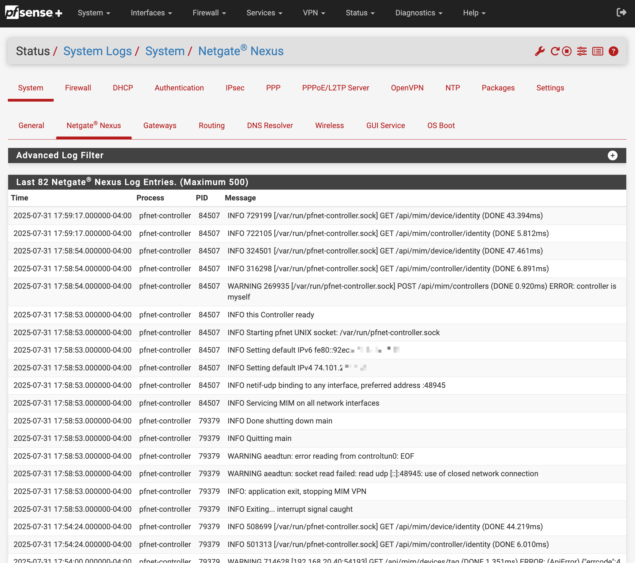

            I don't see the device shown on the second "Dahsboard" screenshot with the other errors though - it should still be shown like in the first screenshot. The error log does indicate that's the issue though:
            ERROR: controller is myself

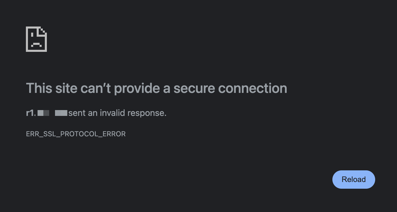

              One quirk I noted: the "HTTP URL" is basically non-working, at least in my testing with Chrome. It triggers an HTTP 303 (aka "See Other") status code, redirecting to the secure link. However, Chrome doesn't like this and just throws up this error:
                Hmm, the link in System > Advanced > Nexus?
                I expect that to redirect to https normally. Do you have that redirect disabled in admin access perhaps?
                Edit: I can't replicate that here though.
                luckman212L 1 Reply Last reply Reply Quote 0
                • luckman212L Offline
                  luckman212 LAYER 8 @stephenw10
                  @stephenw10 Right, sorry yes: System > Advanced > Nexus.
                  Also, yes, I have the webConfigurator Redirect disabled in System > Advanced.
                    Hmm, I'll dig further...
