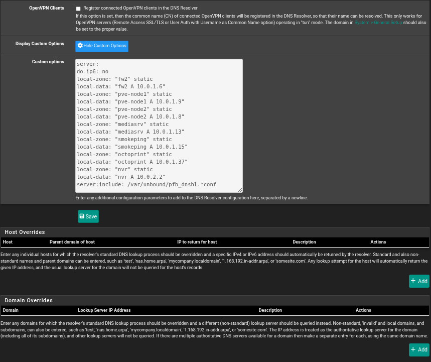

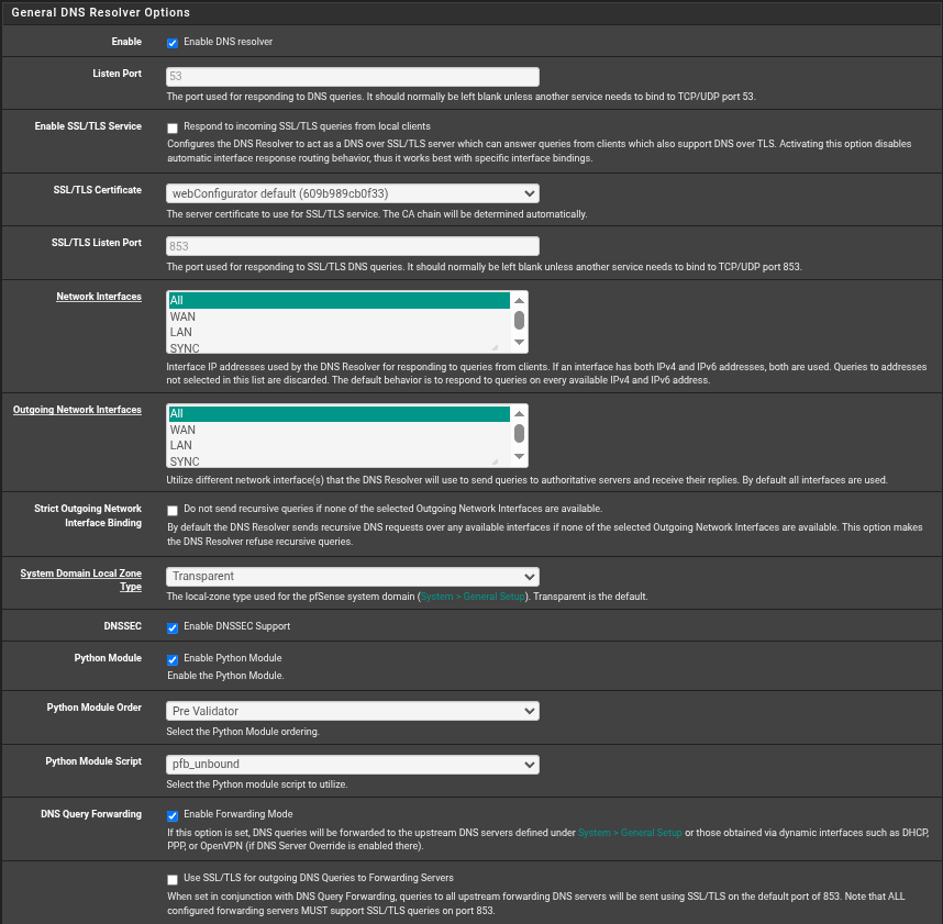

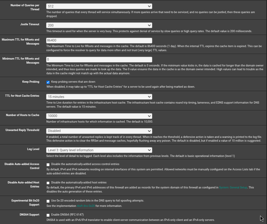

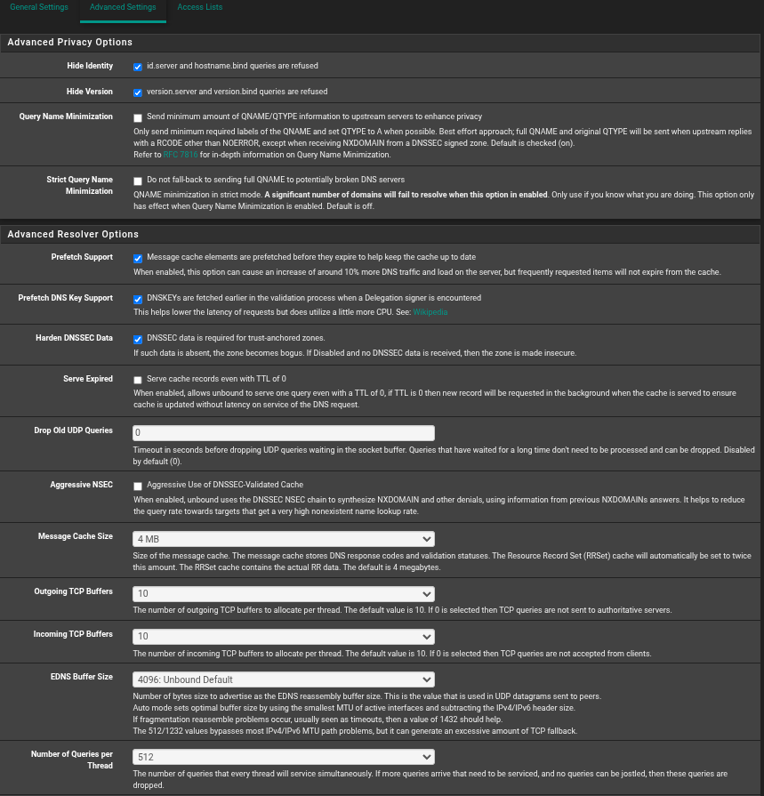

      So I'm officially stumped. Here's a few screenshots of configs to help.
      Unbound access list is empty.

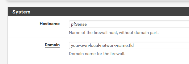

        So, go back to default, uncheck :
        Actually : on this page : SystemGeneral Setup, the only thing that you had to change was :
        where you might call pfSense like .. pfSense, so even that one can stay as it is.
        Don't change anything else on that page, and you have a working system.

        I saw you've instructed the resolver (unbound) not to use IPv6
        do-ipv6: no

        then you might as well make live easier on yourself by stopping stopping (remove the check) :
        Or get back to what Netgate decided for you (they are probably network experts, so you can trust them) and use the defaults :
        Enable DNSSEC
        Disable forwarding.

          I initially didn't have DNS Query Forwarding Mode on and haven't for years. Having it off resulting in SERVFAILs or connection timeouts on digging the domain.

            Gertjan @JonesTech
            @JonesTech said in Strange DNS Issue:
            I use pfBlockerng DNSBL in python mode, sorry I should have clarified.
            Then you can remove :
            as you've probably added it yourself way, (way !) in the past.
            Right now, that line will read/include:
            -rw-r--r--  1 root unbound 2293 Jan 22  2025 /var/unbound/pfb_dnsbl_lighty.conf
            that that well error out at best, as that file isn't a DNSBL file, but the pfBlockerng DNSBL nginx (web server) config file.

              JonesTech @Gertjan
              @Gertjan said in Strange DNS Issue:
              Actually, with Safesearch enabled in pfBlockerng, it drops pfb_dnsbl.safesearch.conf in /var/unbound, so that line is necessary.

              Any other thoughts on how to troubleshoot this? I'm pulling my hair out lol. Thanks again for the reply!
                If you're using forwarding mode then disable DNSSec.
