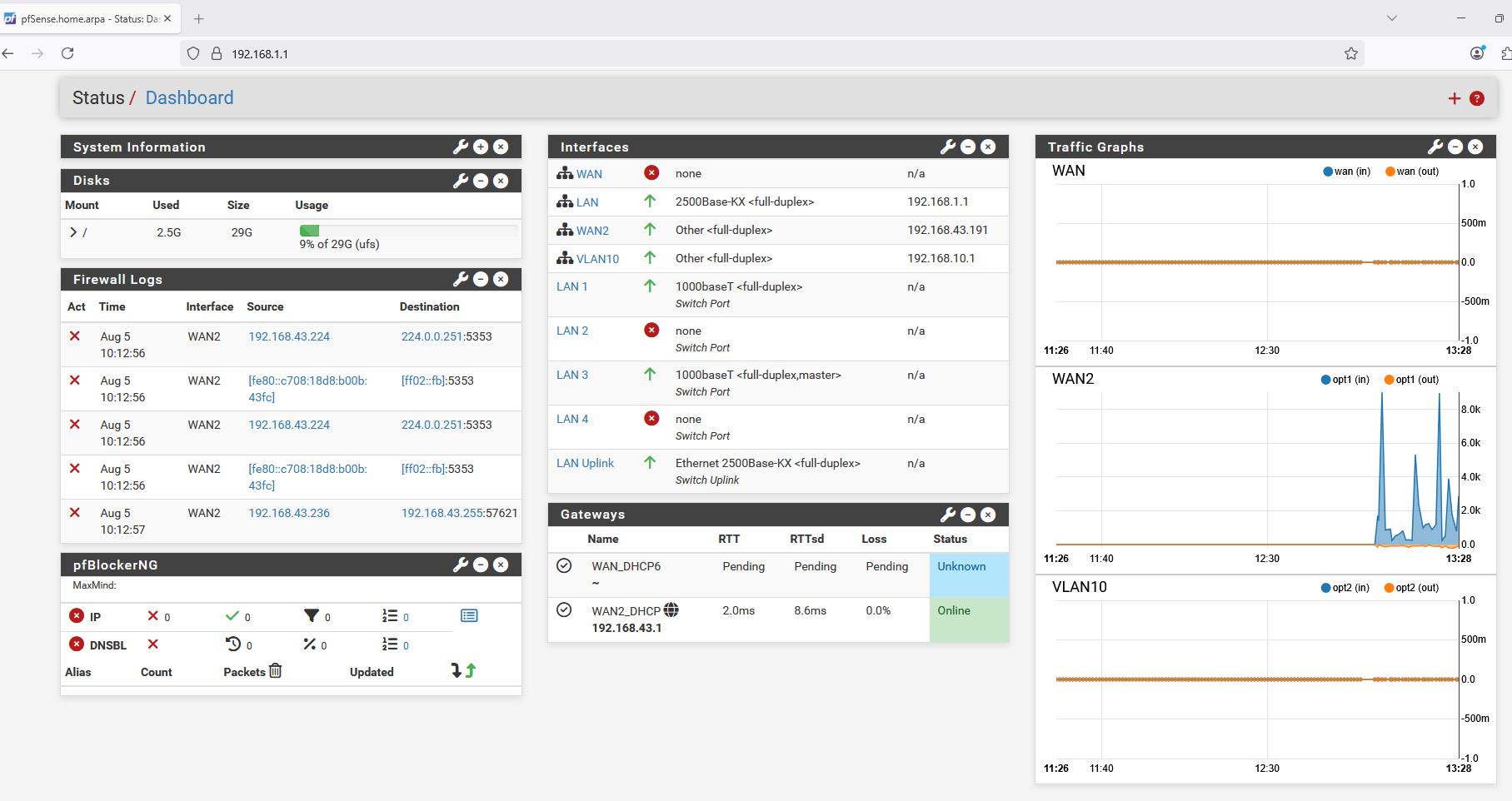

      Hello, Good day,
      We have Netgate SG2100, I wanna configure the available LAN, e.g, Ports 3 and 4, the purpose is not to buy a managed switch for expense purposes. I already did the configuration, actually, for VLAN30, I created the rules and enabled the DHCP server. But still no internet connection on LAN4 VLAN30, the status of the LAN is connected. The IP release is from VLAN30, but still no internet. Can anyone here explain to me why it is not working? Thank you

        @chris.doldolia Are you trying to isolate the port or run multiple VLANs on the same port?
        Isolate: https://docs.netgate.com/pfsense/en/latest/solutions/netgate-2100/configuring-the-switch-ports.html
