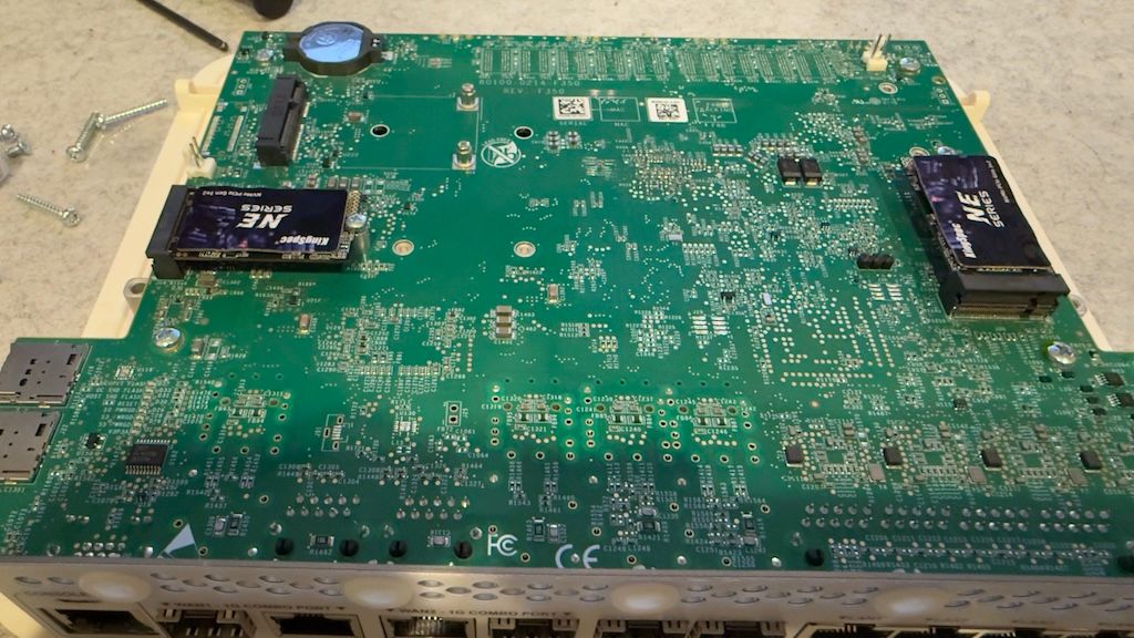

      That weekend I was able to locate a local ebay reseller that happened to have a couple of used 256GB NVMe M Keyed NVMe drives and I setup the NVMe's in a mirrored setup, just to see if I could, and it worked.
      I had to do a bare metal restore and then use the ACB (Auto Config Backup) service to restore my last configuration, fortunately I had my Device ID and encryption key so I could locate and restore the backup.

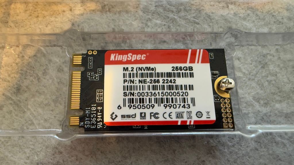

      Since these NVMe's were used, I wasn't comfortable keeping the system running on them so I was able to find compatible NVMe on Amazon: KingSpec 256GB M.2 NVMe SSD, 2242 PCIe for about $40 each.
      Made a backup of the config.xml, copied it onto the USB I used to reinstall. Replaced the NVMe's and was able to restore the system and get everything running stable.

        The pictured KingSpec M.2 NVME SSD is a SATA drive, not a PCIe device.
        EDIT: Ohh, I think I get it. Your 6100 MAX shipped with an eMMC storage device from the factory—which failed. And the resolution was a storage device replacement/overhaul with these mirrored SATA SSDs. Got it.
        Still important to note the difference between the SATA and PCIe SSD interfaces, since the 6100 MAX presumably does not have NVMe PCIe slots onboard.

          The Kingspec is a PCIe SSD as the Netgate 6100 doesn't have a SATA interface, which made it incredibly hard to find a replacement. If it was SATA there were so many more options available.

            @tariqali The pictured drive has an M.2 B+M keyed interface, which is typically only found with SATA drives. PCIe NVMe drives are usually M keyed only. (Relying on image search results and prior knowledge, but I could be wrong.)
            So if that drive is in fact a PCIe, not a SATA drive (as KingSpec advertises), then I've never seen that before.

                @tinfoilmatt Correct it is a M.2 B+M Keyed interface, but this one is a PCIe, here's the Amazon listing: https://a.co/d/fDxaY4m
