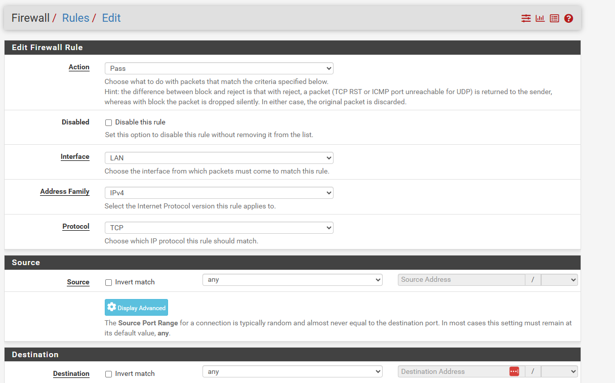

            Is there any idiot's guide showing how I can safely manually add a firewall rule?
              You'll need to use the manual firewall rule option with sloppy states and TCP flags set in the advanced rules section like:
              https://docs.netgate.com/pfsense/en/latest/troubleshooting/asymmetric-routing.html#manual-fix
              You may need to add that as an floating rule with direction any and source/destination values that match traffic both ways between the old and new subnets to be sure.
              But it should be pretty clear from the firewall logs what traffic is actually being blocked.
