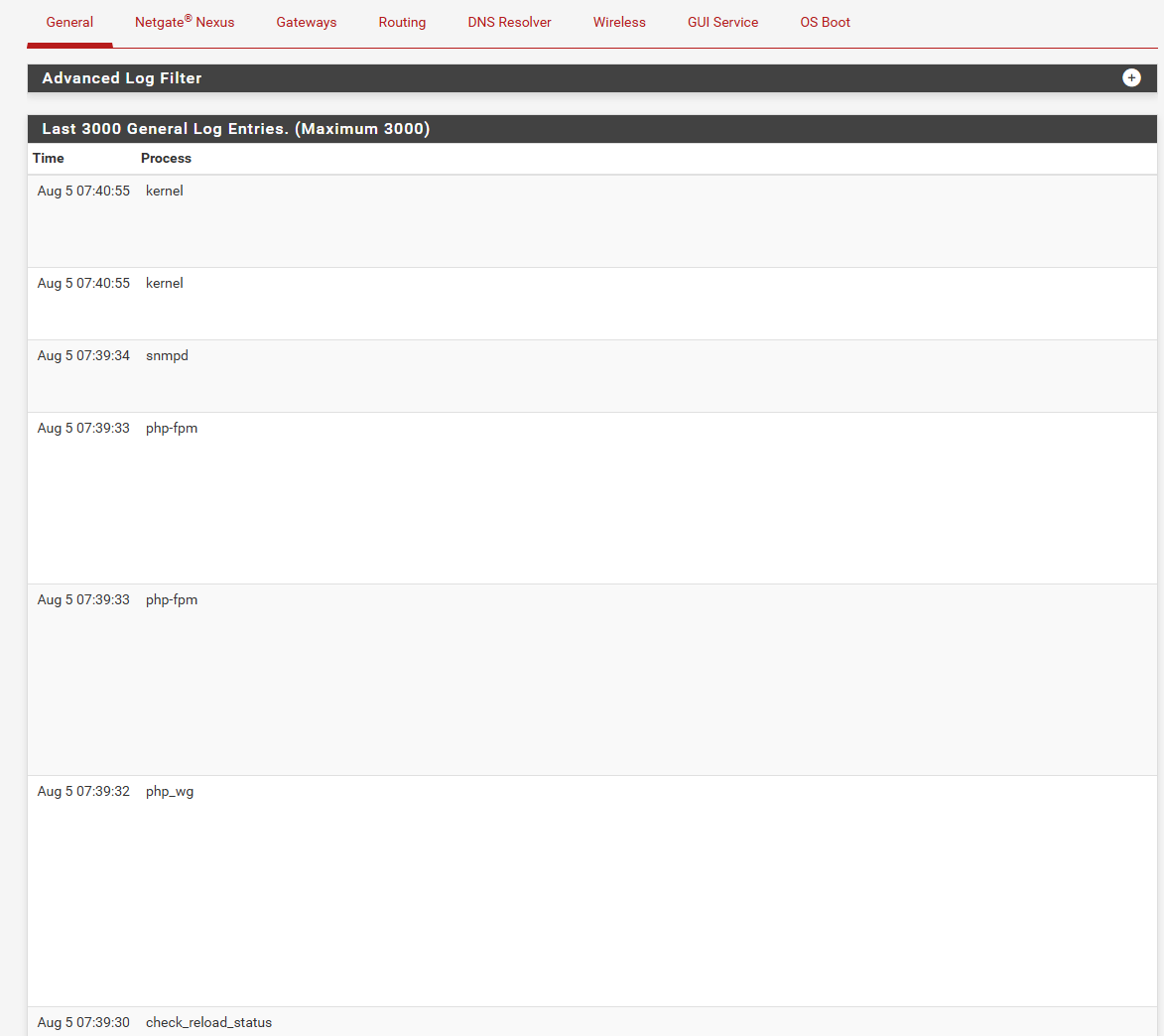

      After upgrading my 6100 MAX to 25.07 I only see an half empty system log:
      The other logs (firewall etc...) works fine.

        @mrsunfire I have seen this before on other upgrades - I normally just reset mine. I saw the same thing with the update 25.07 just a while ago.
          mrsunfire @johnpoz
          @johnpoz Thanks, that did the trick! :)

            Yup it's a display issue if the system creates a log entry with no host name:
            https://redmine.pfsense.org/issues/15411
            You can just wait for the offending entry to move off the displayed logs.
