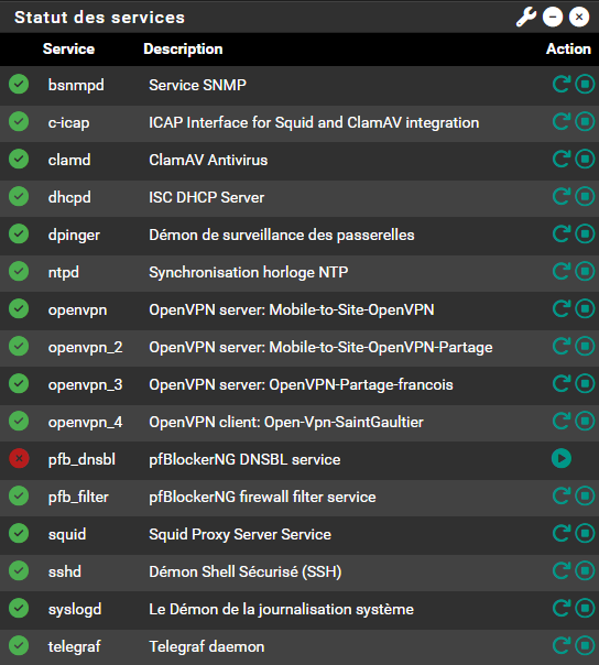

      Hello everyone,
      I just installed pfBlockerNG. I used the wizard to configure the interfaces. Everything seems to go well, but when I check the status of my services, the pfBlockerNG-devel service won’t start, even when I try to launch it manually.
        Gertjan @jeremyc311
        @jeremyc311 said in pfBlockerNG-devel 3.2.8 service pfb_dnsbl don't start:
        ===[ DNSBL Process ]================================================
        Loading DNSBL Statistics... completed
        Loading DNSBL SafeSearch... disabled
        Loading DNSBL Whitelist... completed
        ... and the rest is "IP" stuff , not DNSBL.
        Do you have DNSBL lists ?
        I mean, if you gave none, the "pfb_dnsbl - pfBlockerNG DNSBL service" doesn't need to run.

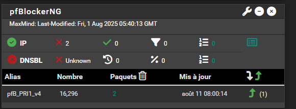

            jeremyc311 @anthonys
            @anthonys
            thks for your solution ,I no longer have the error on the count. I still have the DNSBL service with the red cross. I’m simply trying to do GeoIP blocking, so I enabled GeoIP blocking for different continents. I’m surprised to see in my logs only one blocked IP, which is related to my TrueNAS.

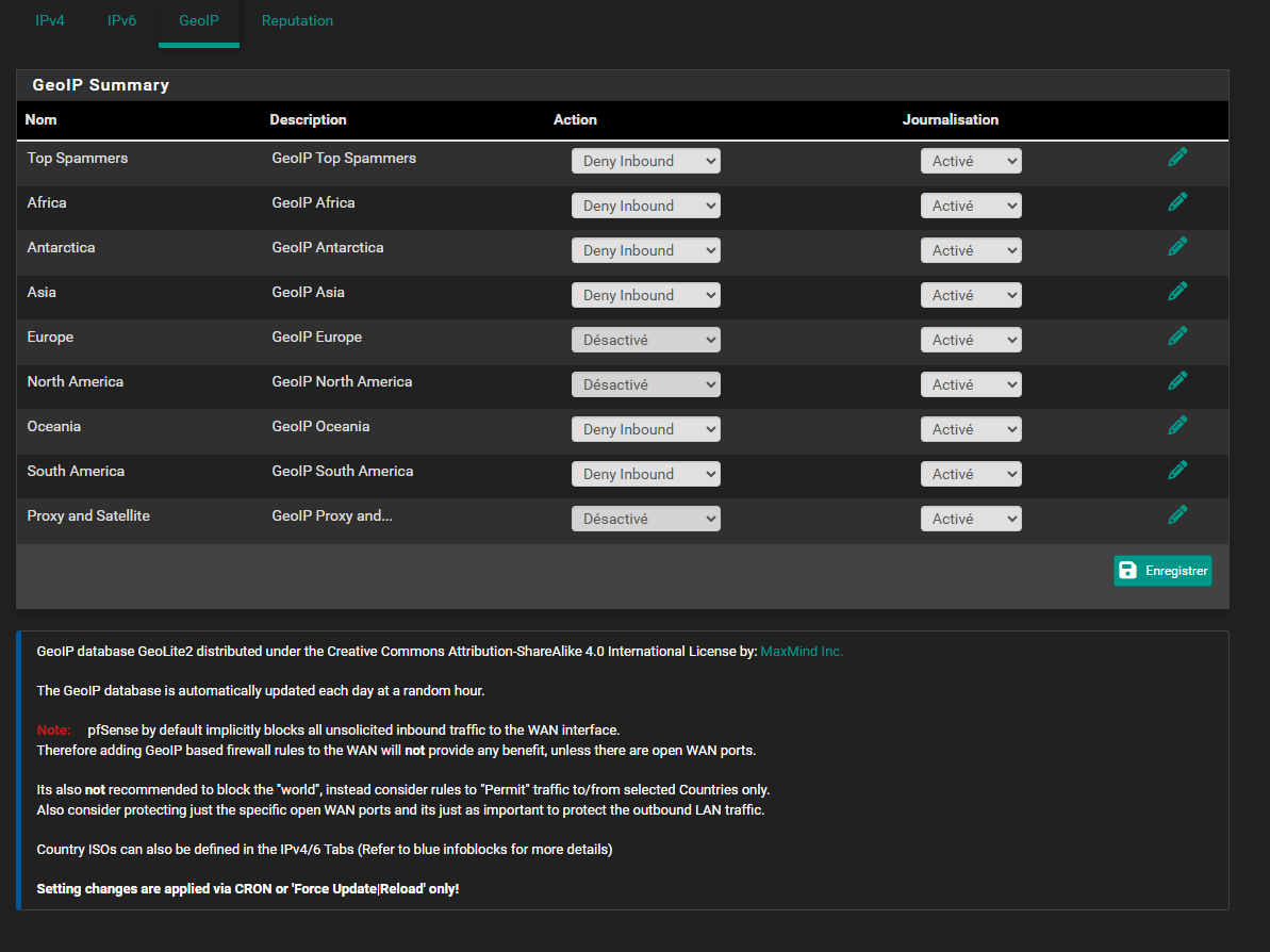

            Aug 5 09:01:14,1770008712,bxe1,LAN,block,4,17,UDP,192.168.2.13,116.147.64.181,51765,51413,out,Unk,pfB_PRI1_v4,116.146.0.0/15,ET_Block_v4,Unknown,truenasr740,null,+
            Aug 5 13:23:26,1770008712,bxe1,LAN,block,4,17,UDP,192.168.2.13,177.72.195.114,51765,6881,out,BR,pfB_PRI1_v4,177.72.195.114,CINS_army_v4,Unknown,truenasr740,null,+
            Aug 5 13:23:32,1770008712,bxe1,LAN,block,4,17,UDP,192.168.2.13,217.76.54.225,51765,51561,out,DE,pfB_PRI1_v4,217.76.54.225,CINS_army_v4,vmi1567930.contaboserver.net,truenasr740,null,+
            Aug 5 13:34:02,1770008712,bxe1,LAN,block,4,17,UDP,192.168.2.13,102.212.41.5,51765,1721,out,NG,pfB_PRI1_v4,102.212.41.5,CINS_army_v4,Unknown,truenasr740,null,+
            Aug 5 14:20:57,1770008712,bxe1,LAN,block,4,17,UDP,192.168.2.13,177.72.195.114,51765,6881,out,BR,pfB_PRI1_v4,177.72.195.114,CINS_army_v4,Unknown,truenasr740,null,+
            Aug 5 14:21:02,1770008712,bxe1,LAN,block,4,17,UDP,192.168.2.13,217.76.54.225,51765,51561,out,DE,pfB_PRI1_v4,217.76.54.225,CINS_army_v4,vmi1567930.contaboserver.net,truenasr740,null,+
            Aug 11 08:06:58,1770008712,bxe1,LAN,block,4,17,UDP,192.168.2.13,177.72.195.114,51765,6881,out,BR,pfB_PRI1_v4,177.72.195.114,CINS_army_v4,Unknown,truenasr740,null,+
            I’m just starting out, so please be kind. Thank you.
              Gertjan @jeremyc311
              I'll decode this one :
              Traffic, coming into LAN, from a LAN device (192.168.2.13 = your TrueNAS) going to a Chinise ( 116.147.64.181 ) Brazilian ( 177.72.195.114 - = next line ) was blocked by the "pfB_PRI1_v4" list.
              That's probably good thing ? ( ! ). Up to you to discover why your NAS should initiate connections to these countries. A NAS can go outside for maintenance purposes, for example to look for updates of it's system. These could be located anywhere of course.
              The GeoIP IP created a rule for you.
              How and where do you use that this rule ?

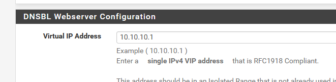

                reberhar @Gertjan
                @Gertjan Hi Gertjan,
                I am having similar problems, but I think mine have to do with HA. My switches always fight me when I do a new version of pfBlocker. So for me the problem has to do with CARP VIPs, or THE VIP that pfBlocker configures.
                Yes my switches do multicasting,
                Happens everytime for me. I don't look forward to those updates.
                On remote locations ... reboot the server, reboot the main downstream switch and finally ... it will work.
                No need to reply. I'm just grumbling. I just don't like nurse maiding the equipment. I keep thinking that there must be a better way.
                Roy
                  Gertjan @reberhar
                  @reberhar
                  pfBlockerng fights with switches ?
                  Euh ....
                  pfBlockerng can (will ?!) create a :
                  and if this IP is already used by some other equipment then you have a choice to make.
                  Changing this 10.10.10.1 for something else, like 10.10.100.1 and the fight will be over.
                  Personally, I think this "DNSBL Webserver" usage is something that belongs to the past, as this web server was useful in the past, when everybody was using http:// web sites. That's not the case anymore. It's https:/ these days. And https:// sites can be redirected to https://10.10.10.1 and show the sure a page that the site he was about to visit was blocked. The browser would display a huge TLS (certificate) error leaving most users clueless.
                  I just 'null' block all DNSBL hosts and call it a day.
                  R 2 Replies Last reply Reply Quote 0
                    reberhar @Gertjan
                    Yes at 11 last night I got it all going. I know what to do or at least to try.
                    I suspect the level two switches are keeping track of something. Yes of course, the MAC, but the MAC is not changing. If it were ARP I would have a guess. There is, of course that odd HA/CARP VRRP mac that might be the problem. Donno.
                    For some reason the pfBlocker VIP acts differently than the other CARP VIPs and pfb_dnsbl is tied to that. If that VIP is not working neither is pfb_dnsbl.
                    When the problem is present I can reproduce it by going into pfBlocker, General and then saving.
                    The VIP will fail and pfb_dnsbl will stop. I use this to check to see if my solution works. It is when pfBlocker does its night time run that the problem appears. The next day those VIPs are in a bad state and pfb_dnsbl stops. I bring them back online with the Firewall VIP menu option, entering said VIP like I am going to edit it and then saving it. All is good until night again. No need to do any of this now that the problem is fixed.
                    The resolution was different depending the switches down stream. Some of them totally surprised me.
                    I didn't always have to reset the switches, sometime rebooting took care of the problem, making sure that the pfBlocker update was done and the VIP and pfBlocker were functioning. I usually used reroute in my reboot.
                    In one especially odd case, the problem was resolved with doing the update on both primary and secondary and rebooting. The downstream switch was a dumb switch. Usually I like to do the backup server first, assuming the pfBlocker VIP will talk to the primary. Aparently sometimes this isn't the case.
                    Thanks for listening.
                    I know you guys can't solve every problem, and that's ok. I am thankful anyway to have this forum.
                    Roy
