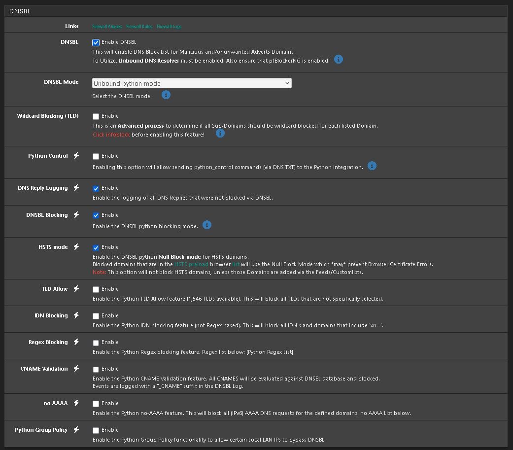

        Are you running pfBlocker with DNS-BL? If so you need to use Python mode with kea2unbound.
        • S Online
          smsigroupit @stephenw10
          @stephenw10 said in Crash Report After Upgrading to pfSense Plus 25.07:
          Hi @stephenw10 ,
          Thank you for the quick response.
          I’ve already switched to Python mode—are there any other settings or options I should be aware of?
            Using Python mode should be sufficient there. You can also increase the PHP memory limit in System > Advanced > Misc but you shouldn't need to.
