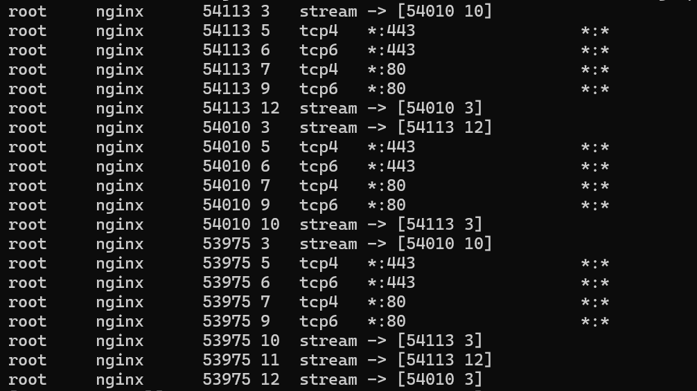

        Update, here an output of the sockstat, 80 and 443 appear to be open.
          Do you see blocked traffic on secondary?
          It sure looks like it's failing to authenticate there. Are you using a complex password? Are you using the admin user for the xml sync?
