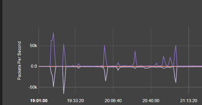

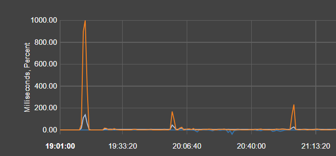

              Pulled the monitoring data for PPS, figured it would be easiest to just show it, the first is my PPS graph and the second is my packet loss and latency graphs for the same time period, so they do line up (not that that's surprising).
              Maybe this many pps was overwhelming the ISP?

                            Latency at >1s is pretty bad!

                              @stephenw10 Correct, but that was only during the torrents, otherwise latency is like 5ms.
                              Something about the torrenting in specific is making my ISP crap the bed basically, and I'm trying to get to the bottom of whether it's my ONT, just my provider in general, or something intentional from the provider.

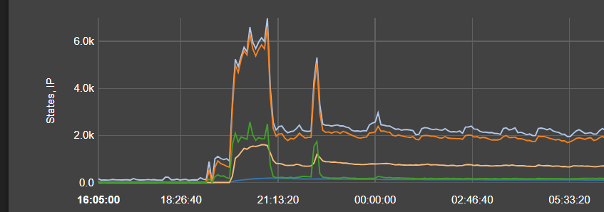

                                  @stephenw10 There was a lot of states, and state changes per second, during this time, but nothing that should be going over what it can handle.
                                  For reference here is a photo, the spikes are during torrents being on, the rest is normal traffic.
                                    Hmm. I mean 6000 states is nothing for pfSense but potentially could be an issue for something else in the route.
