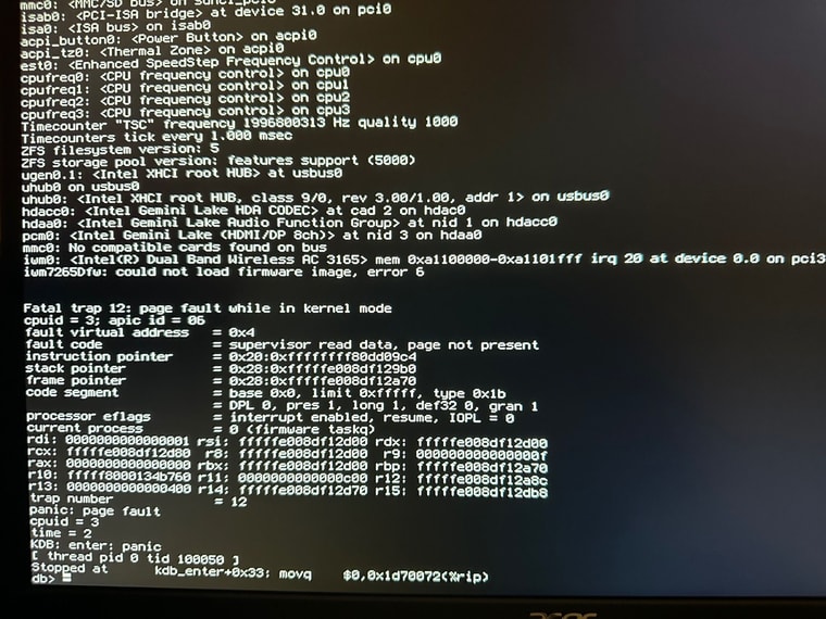

      This happened with the beta and RC also. My system is: https://pcpartpicker.com/list/qj73Dx The only difference is a 16GB memory stick of the same brand with the same timings. If you need anything else, please let me know. I'm back on 24.11. Thank you.

        It's an upstream bug in the firmware loader: https://redmine.pfsense.org/issues/16237
        Remove/disable the wifi card or apply the workaround shown there.

            I am having the same problem when upgrading form 24.11 to 25.07. The boot process stops with a fatal trap 12 error and goes into panic mode.
            The culprit appears to be the Intel Wireless card (AC 3165) installed on the host. Is there any other solution than deactivating the device in the BIOS? I am using the Wifi card to connect to a backup MiFi in case my main Internet service is disrupted.

                Yes, I may be able to install another NIC and connect the MiFi via cable. But are you saying that the Intel WiFi cards are too old and therefore unsupported in the newer BSD versions?
                • stephenw10S Online
                  Nope I'm saying they require loading firmware into the card and the upstream firmware API is broken which is what you're seeing. Other wifi hardware/drivers like Atheros (ath(4)) do not and hence work fine in 25.07:

                  But this failing because it can't find the firmware and hits the bug. We may be able to work around it. Let me see if I can test something....
                    Hmm, nope. Even providing the firmware separately still hits the bug. As far as I can see this will remain until it's fixed upstream. 😕

                      Thank you for trying. Does this mean that the Intel WiFi cards will not work until someone updates the driver in FreeBSD 15?
                        Currently in pfSense it does, yes. Because the firmware is not present, it tries and fails to load it and that hits the bug. It should not panic if it can't find the firmware.
                        If the firmware was still in-kernel it might load normally. I can't test that. I couldn't get it to load the firmware as a kernel module.
