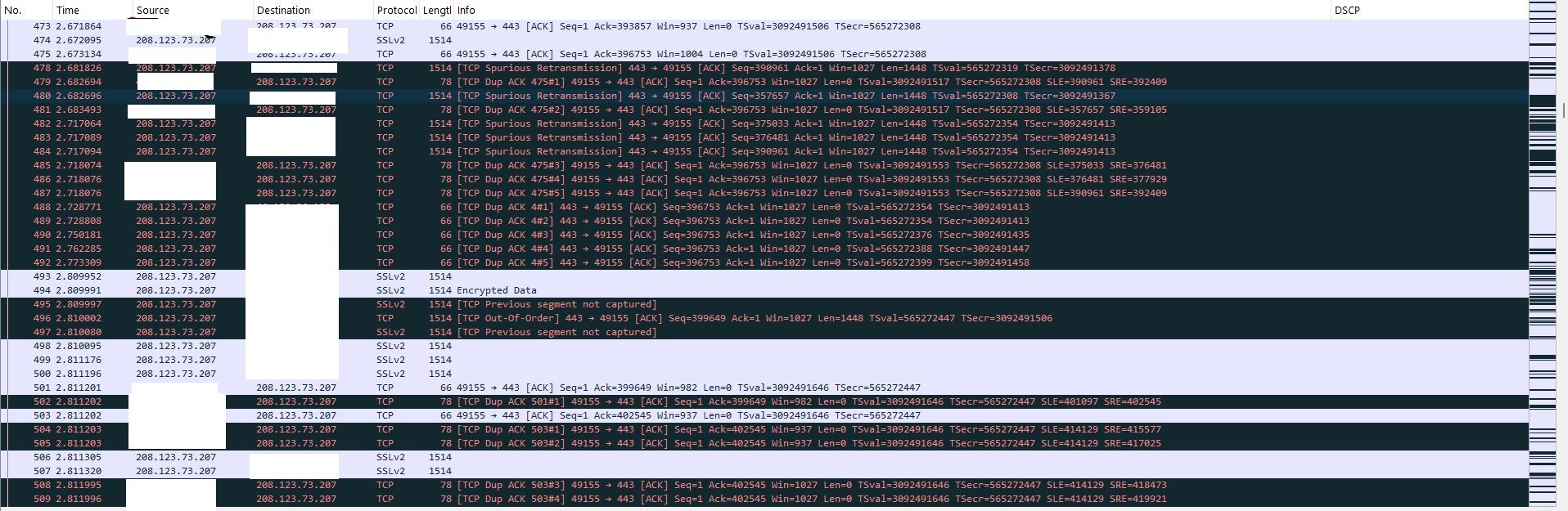

              maverick_slo @stephenw10
              Yeah a lot of out of order and retransmissions...
                Yup could be something dropping packets in the route.

                          stephenw10 Netgate Administrator @maverick_slo
                          That MTR output is actually OK. It's normal to see some hops in the route the don't respond to pings or drop packets. The important thing is that there is no loss at thge last few hops. If there was general packet loss in the route everything beyond a bad router would see at least that same level of loss.
                          That packet capture sure looks like it's just missing traffic though. ๐Ÿค”

                              You could try pinging with large packets to determine any MTU restriction in the path. Setting MSS to 1200 should have eliminated that unless it's very restricted.
                              In the screenshot of the pcap we can see large packets arriving from the pkg servers but none going the other way.
                              Though the fact that pfSense is continually sending duplicate ACKs seems to imply that it's not seeing the incoming packets from the server even though they are reaching the NIC.
                              I assume you are not seeing traffic blocked in the firewall log? Do you have custom block rules that might block that without logging?
                              Do you have more than one WAN? Is it possible traffic is using both?
                              Something else could be dropping traffic on the WAN like traffic shaping or Snort.

                                      Are you able to upload that pcap (or one like it) so we can look at it? That looks so catastrophic it should show something where it first fails.
                                      https://nc.netgate.com/nextcloud/s/gmrTnLwJyNjNpqa

                                          Hmm, unfortunately that doesn't include the initial part of the connection where it first fails. Are you able to get a pcap including that? If you just run pkg update for example.
                                          Was is that running on? The MAC addresses for pfSense and it's gateway are unusual.
