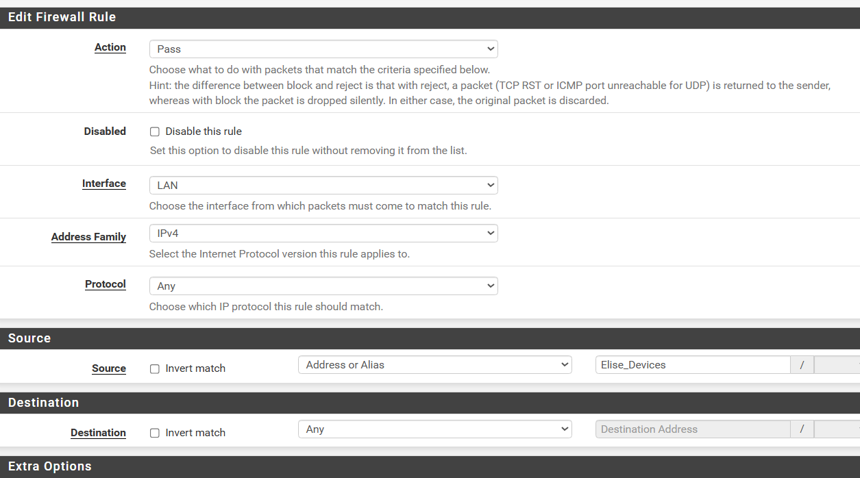

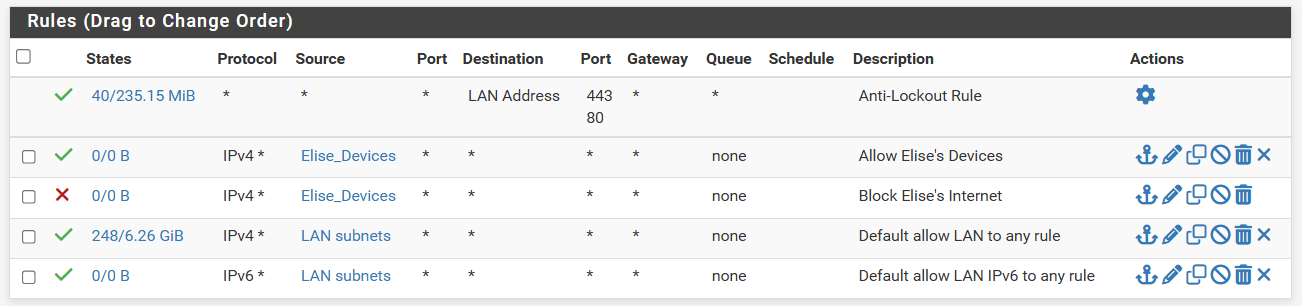

                          cheapie408
                          So this is what I got,
                          Created alias for RFC1918 with 10.0.0.0/8, 172.16.0.0/12, 192.168.0.0/16
                          created a pass rule for the (single host) and block rule as shown. The passrule should remain active and when I want to turn on/off internet, I'd enable/disable the block rule?
                            SteveITS Rebel Alliance @cheapie408
                            @cheapie408 You can also create a schedule, and add an entry to the schedule each time you want to grant extra access. Something like:
                            Mon - Fri / 6:00-7:00 / Weekday mornings
                            Wed / 7:00-7:15 / Late start day
                            Mon - Fri / 15:00-18:45 / Weekday evenings
                            Sat - Sun / 13:00-16:00 / Weekends
                            August 7 / 0:00-20:59 / (added extra time today)
                            The block rule needs to always be enabled, so 2 rules:
                            1. allow LL laptop during schedule
                            2. block LL laptop
                            as noted in
                            https://docs.netgate.com/pfsense/en/latest/firewall/time-based-rules.html
                            Or you can just enable/disable the allow rule.
