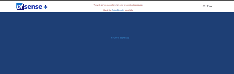

          Here is the other freaky part. I cannot log in as admin. It does not take my password - the same one ive been using for years. It doesnt even take the default admin/pfsense credentials. Yet clearly my configuration is all here. I am assuming nginx has their own local database file that it uses for credentials? Admin is not working but a custom user account i created is working but sadly that doesnt have sudo access.

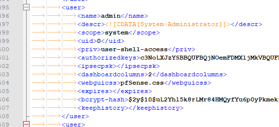

                3) Reset admin account and password

                    Gertjan @michmoor
                    @michmoor said in Unable to log into WebUI after 25.07 upgrade:
                    Not its own.
                    'The' System > User Password Manager. So a user like the 'admin' is present (has to be present) in the main pfSense config file :
