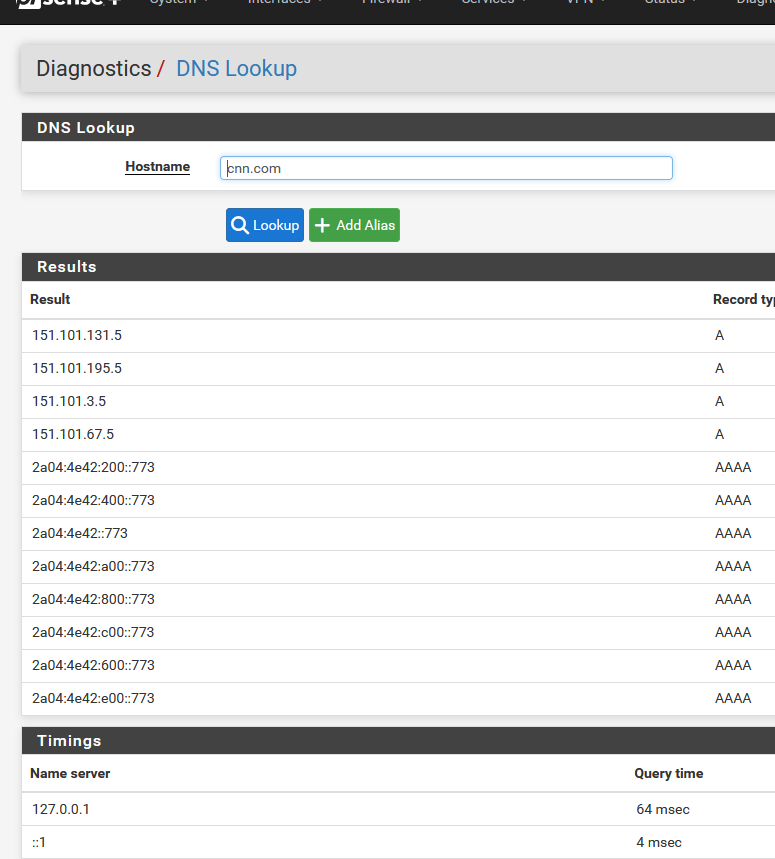

            The GUI test :

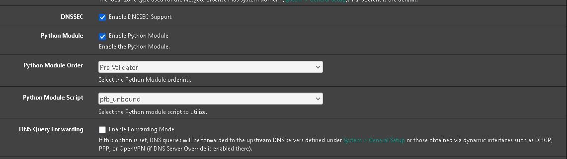

                  smsigroupit @SteveITS
                  @SteveITS
                  DNS Resolver

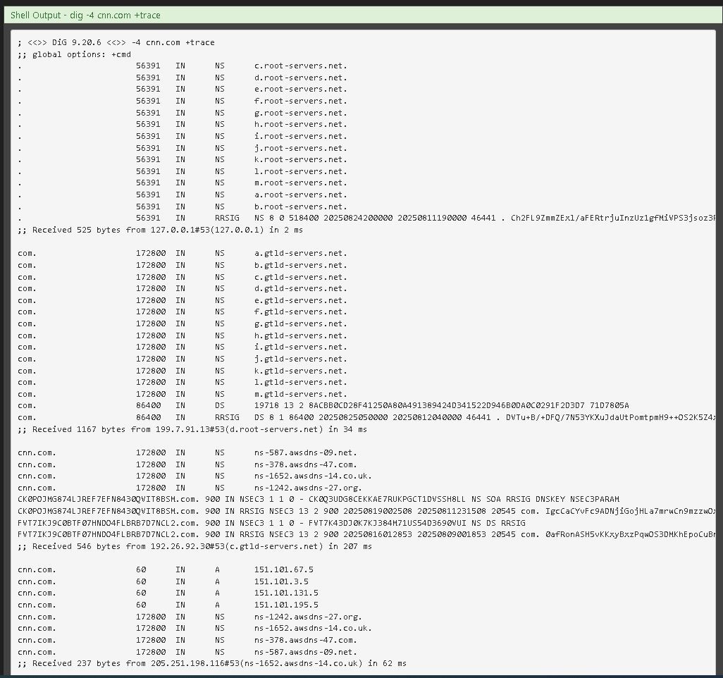

                      Gertjan @smsigroupit
                      @smsigroupit
                      So dig - who resolves itself without using unbound (the resolver) works fine.
                      So : resolving from pFsense would work for you.
                      Just onething :
                      ;; UDP setup with 2001:503:83eb::30#53(2001:503:83eb::30) for cnn.com failed: host unreachable.
                      dig also tries to use IPv6 - and that failed.
                      is your pfSense IPv6 setup working correctly ?

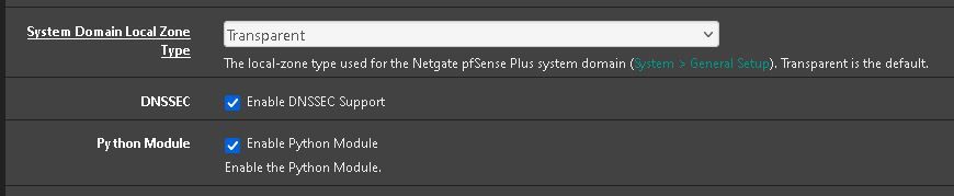

                        Before upgrading to pfSense Plus 25.07, everything was working fine on pfSense Plus 24.11.
                        After the upgrade to pfSense Plus 25.07, I began experiencing repeated crash reports. Details are as follows:
                        The only change made was switching DNS-BL mode to Python mode, which resolved the issue.

                              @smsigroupit said in DNS Issues After Upgrading to 25.07:
                              Yeah, that one pops up all the time now.
                              The new way how KEA transmits leases into the DNS (unbound) is by parsing the actual unbound local cache, and inserting only new DNS info, and removing old lease info.
                              If the old classic pfBlockerng DNSBL method is uses (= one big file with all the DNSBL info in one go) this cache can become very big. Unbound will also take a lot of time to read and parse this file on every startup. During this startup, DNS doesn't work.
                              That's one of the reason the python mode was invented : it's better faster and asks less resources.
                              I really thought everybody wanted that, and everybody who was using pfBlockerng and DNSBL, was using python mode by now. Apparently ... not everybody. Anyway, you solved that now.

                                dig cnn.com +trace
                                  @smsigroupit
                                  About the (restarts) :
                                  Check with the system log what happened, why unbound was told to restart.
                                  A very common reason is : an interface used by unbound was taken down for a moment.
                                  If possible, stop this from happening.
                                  About the dig : dig bypasses the resolver (unbound), it does all the work 'itself'.
                                  As it get back DNS records with IPv6 addresses, it will use these to 'check' them. Because your don't have Ipv6 support, these will fail.
                                  A cleaner result can be obtained by specifying dig to use IPv4 only :
                                  dig -4 cnn.com +trace
                                  But dig isn't the resolver.
                                  There are special options for unbound that you can specify here :
                                  so you can inform unbound not to use Ipv6 (just to be sure).
