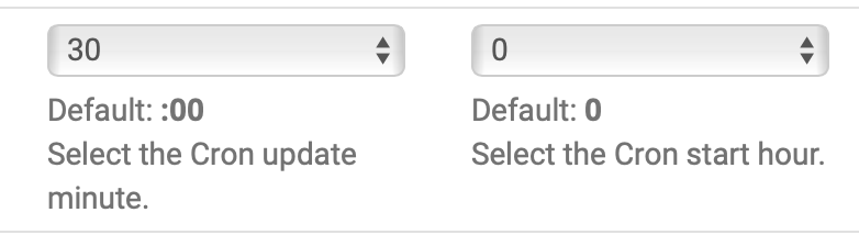

                      name the patch whatever you like and set these behaviour options
                      This is the patch contents (made just for you to hit the time before 2am)
                      --- pfblockerng.inc.orig	2025-08-16 10:30:40
                      +++ pfblockerng.inc	2025-08-16 10:29:52
                      @@ -10669,8 +10669,8 @@
                       	if ($pfb['enable'] == 'on') {
                       		$pfb_gcmd = "/usr/local/bin/php /usr/local/www/pfblockerng/pfblockerng.php dcc >> {$pfb['extraslog']} 2>&1";
                       		// CRON hour is randomized between 0-23 Hour to minimize effect on Servers
                      -		$pfb_gmin	= '0';
                      -		$pfb_ghour	= rand(0,23);
                      +		$pfb_gmin	= '35';
                      +		$pfb_ghour	= '1';
                       		$pfb_gmday	= '*';
                       		$pfb_gmonth	= '*';
                       		$pfb_gwday	= '*';
                      In this I changed the time from the random top of the hour to 1 35 am (just before your 2am pfblocker update and with time to spare.
                      However, I would recommend anything that is not at the top of the hour (0) minutes as that is when almost everything else gets scheduled.) FWIW. I also changed the "top" of the hour on my system so the pfblocker cron setting so that everything is offset by 30 minutes, and therefore don't conflict with other jobs that are also at 0 minutes (as most are)
                      If you make this change on the dialog, then you might need to change the above, so it runs at say 1 15 am (adjust accordingly to suit your needs)
                      pfblocker general page cron settings GUI
                      next time it creates the job it will schedule it for the now not so random time of your choice.
                      If you want to adjust the time and the patch has been applied, revert - edit the patch times (minutes/hours) only - then reapply. (unlikely you want to change the day month or week day, but if you did you would need a modified patch)
