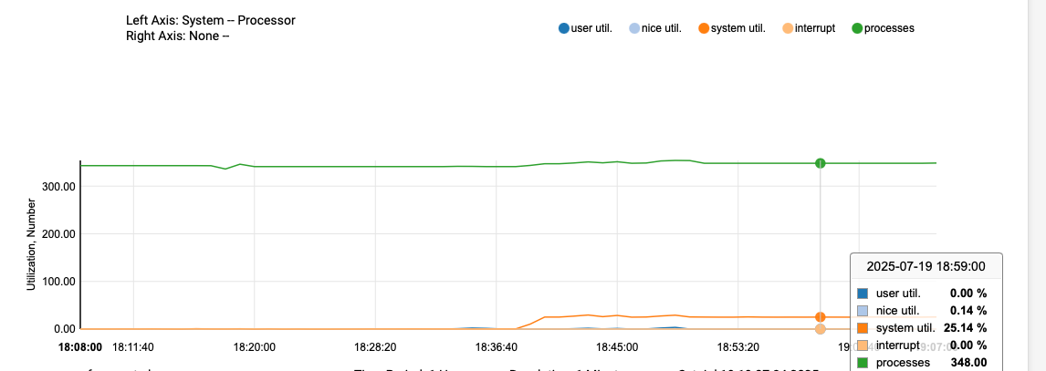

      I am unable to access any websites, the internet connection is not working. I can't access the admin console by domain, just by ip address. However, this is what I see in the monitoring: system utilization increases by 25%, screenshot below.

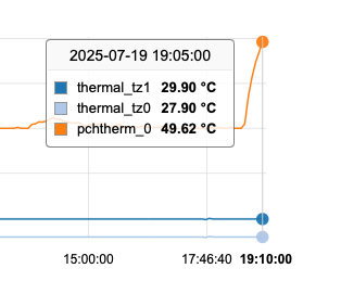

      The PCH chipset temperature is skyrocketing, screenshot below.

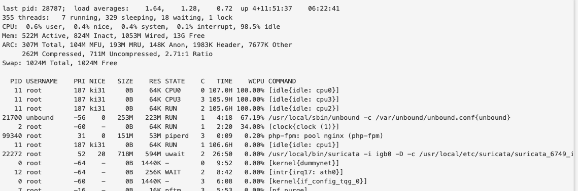

      If check the system activity: Unbound is using more than 50% of the WCPU.

      sockstat -4 | grep ':53'
      unbound  unbound    78696 3   udp4   *:53                  *:*
      unbound  unbound    78696 4   tcp4   *:53                  *:*
      I think the old socket is not properly closed when I plug the laptop into the LAN, causing Unbound to consume more CPU resources, and a new socket is not opened.
